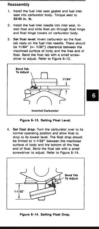

• carb clean, recently rebuilt, float level correctly set
