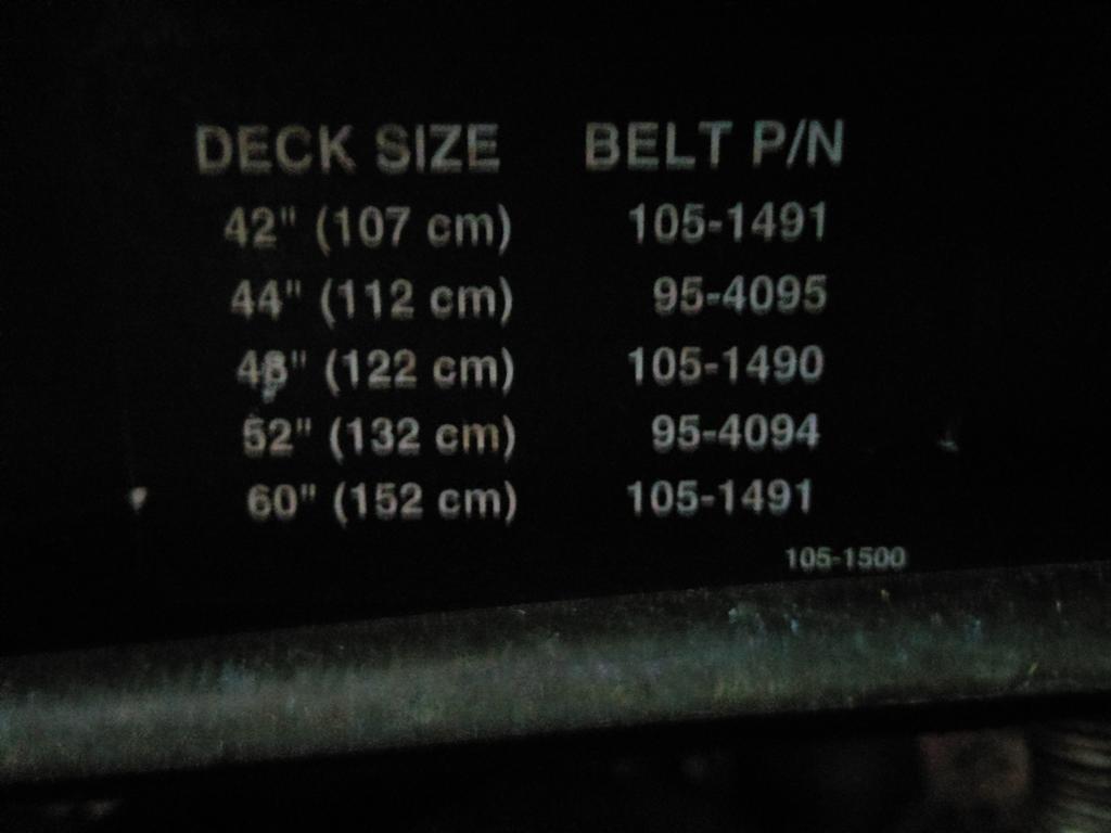

@Xearl, Ok picture straight from the last xi series I had,  I would just Google it or try eBay ect with the Toro # ,then find your cross reference number...try SLE.COM seems to be the cheapest so far, Jeff.
These numbers don't seem right .  My old broke belt is a bout 101 " inches , the one from my other deck was 100+ or - then I found a chart that said it was 104.35 in . . there are plenty on line I just need the length  .
