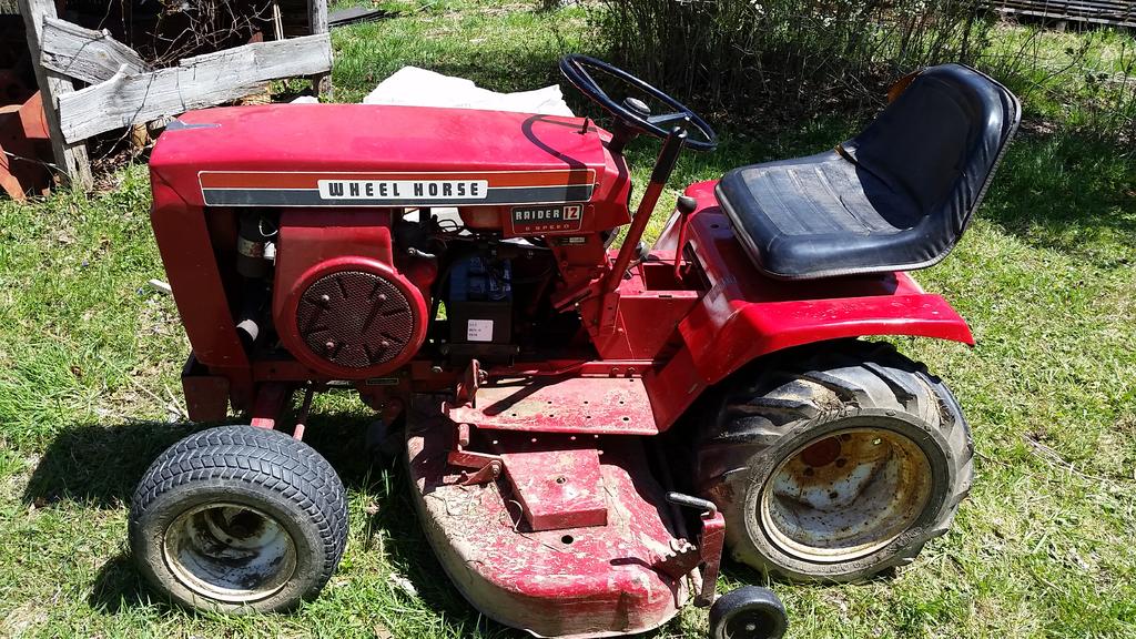

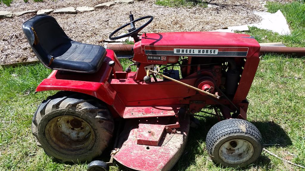

tntatro 168 #37 Posted April 21, 2018 Sometime this week I plan to replace that axle seal if I can get the hub off. Do you basically just pry the old one out and put the new one in? I picked up a Raider 12 six speed yesterday. It's not bad looking but the engine smokes a bit. It also needs a new drive belt I think. It won't hardly move in any gear above 1st. I tried testing the limited slip by spinning the tires but only one would spin. Not sure if there is damage or the slipping belt preventing it from engaging. It was a two owner tractor and I don't think the transmission was switched but maybe it was. I also got a nice deal on an 8 speed transmission. 1 Share this post Link to post Share on other sites
tntatro 168 #38 Posted April 21, 2018 With further inspection the Raider 12 appears to have the 8 speed transmission. I was hoping it was a 6 speed but at least the 8 is more durable from what I have read. Maybe some day I'll find a good 10 pinion transmission or differential. I think I got a good deal anyway. $300 + a used Stihl ms250 chainsaw for trade. Share this post Link to post Share on other sites

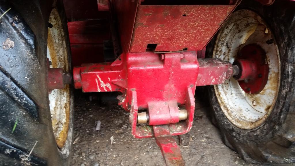

tntatro 168 #39 Posted April 23, 2018 So far no luck getting the hub off. I sprayed it with WD-40 to let it soak. I guess I'll have to find a puller and see if I have any better luck. I did mow a lawn with it today though and it runs pretty good and drives fast in 3rd. The lawn was bumpy and I had to hold it in gear when in 3rd or it would keep popping out. Share this post Link to post Share on other sites

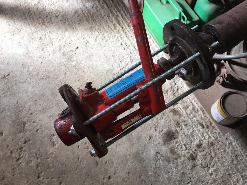

953 nut 51,510 #40 Posted April 23, 2018 (edited) 7 hours ago, tntatro said: had to hold it in gear when in 3rd or it would keep popping out. This is an all too common problem. At some point in your life a previous owner was shifting it on the fly and the 2/3 gear has excessive wear on it. When the time comes to rebuild it the new gear is available through a vendor on this site. 7 hours ago, tntatro said: getting the hub off. I sprayed it with WD-40 to let it soak. I guess I'll have to find a puller Hubs can be a pain. Use some PB Blaster or KROIL rather than WD. You will probably want to use a hydraulic jack puller and another hub as pictured.You want to distribute the force as evenly as possible. Whatever you do, do NOT hit the hub with a hammer. Edited April 23, 2018 by 953 nut Share this post Link to post Share on other sites
tntatro 168 #41 Posted April 23, 2018 Thanks for the info. Is that a homemade puller? Too late about hitting it with a hammer. I didn't go too crazy with it. Hopefully nothing got damaged. Share this post Link to post Share on other sites
953 nut 51,510 #42 Posted April 23, 2018 10 hours ago, tntatro said: didn't go too crazy with it. Hopefully nothing got damaged. There are two potential areas of damage, the cast hub could crack or be broken and the snap ring inside the diferential can be broken or dislodged and the axle will come out of the transmission. The puller is home brew and consists of another hub, some all-thread rods with nuts (the more the better) and a hydraulic bottle jack. Share this post Link to post Share on other sites
tntatro 168 #43 Posted April 24, 2018 15 hours ago, 953 nut said: previous owner was shifting it on the fly I can't say that I blame the previous owner for shifting on the fly, the front wheels pop up if you pop the clutch in full throttle at a stop. The first time I did it in third I was on a slight up hill grade and pulled a wheelie for about five feet. Since I put on 23" lug tires it's not as bad, I thought it would be worse than the 20" turf tires but no wheelies since I switched tires. Either that or the belt is slipping. Found a bottle jack that might work. It's not hydraulic but I'll try it first before buying another jack. My hydraulic bottle jack is a little too big. I did get some threaded rods. Share this post Link to post Share on other sites
stevasaurus 22,229 #44 Posted April 24, 2018 Why do you think you have an 8 pinion instead of a 10. All raider 12s came with 10 pinion differentials...unless someone changed it. It sounds like you put a new belt on that horse and got it running in all gears. Look at the back of the transmission...find the fill plug on the left side behind the axle. Does it have a 1" extension between the trans case and the plug?? Take off the seat and fender pan...use a flashlight down one of the bolt holes and look down the other. With trans on blocks, turn a wheel and count the bolts or nuts holding the differential together. 8 pinion has 4 bolts...10 pinion has 5. 1 Share this post Link to post Share on other sites

tntatro 168 #47 Posted April 24, 2018 I'm trying to get a hub off the Raider to use for a puller. The hub is very loose but will not come off. There is a second bolt with the head broke off that I think might be holding it. Even a small pipe wrench didn't loosen it, I'm afraid it might break if I try harder. Any suggestions? Share this post Link to post Share on other sites
pfrederi 17,125 #48 Posted April 24, 2018 (edited) Some hubs had two set screws. One over the woodruff key the other 90 degrees off of it. is the broken one in line with the keyway on the hub? If the area around the broken bolts looks like it was machined it is factory ...no machining probably a PO's attempt. I leaned the hard way i did it to one of my Chargers. I broke the second set crew off flush tightening down the jam nut. I am leaving it for the next owner to worry about You might take take your dremel with a cut off wheel and cut a slot across the end of the broken set screw deep enough to get a screw driver into it and use an impact driver... If you have a welder, weld a nut on the end of the broken bolt. (welding only inside the nut) Edited April 24, 2018 by pfrederi 2 1 Share this post Link to post Share on other sites
tntatro 168 #49 Posted April 24, 2018 43 minutes ago, pfrederi said: is the broken one in line with the keyway on the hub? No, I can take out the one over the keyway. I was thinking about grinding a little off the sides to fit a wrench on. I may end up making a puller with a metal plate instead of an extra hub. 1 Share this post Link to post Share on other sites
953 nut 51,510 #50 Posted April 24, 2018 35 minutes ago, tntatro said: I may end up making a puller with a metal plate instead of an extra hub. That is probably better, most of us aren't ambitious to drill five holes so we use what we have. 2 Share this post Link to post Share on other sites
