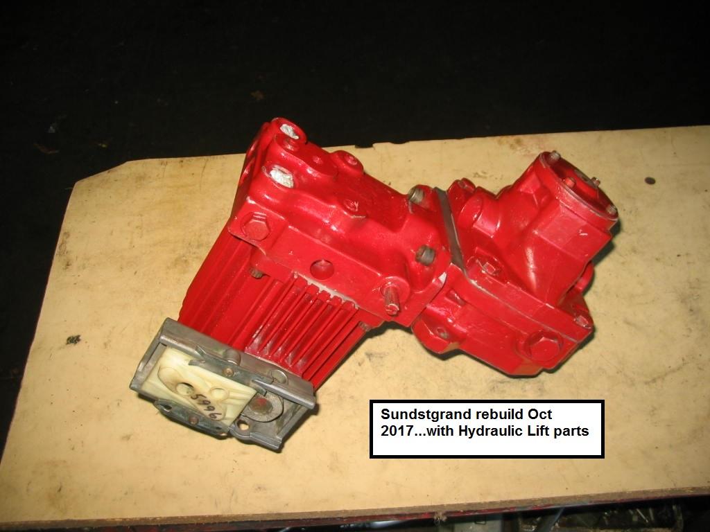

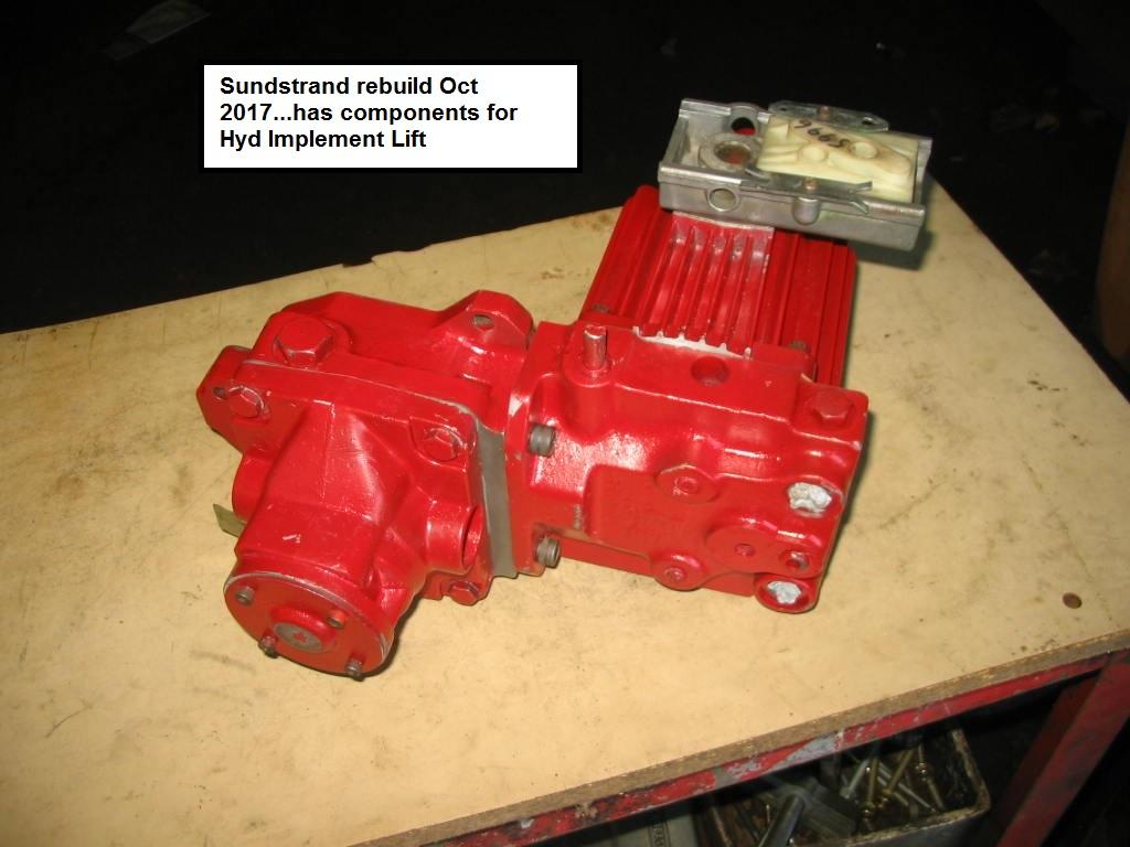

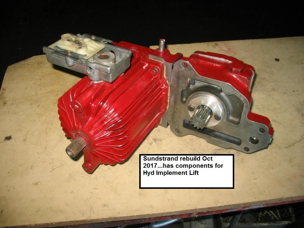

daveoman1966 3,562 #4 Posted March 7, 2018 According to pfrederi above (his post of 12-31-2017), the Sundstrand piston-to-piston can be swapped over to the older tractors with the Sundstrand Hydro-gear. He is one of the experts on Red Square forum. I have on-hand a rebuilt model 90-1136 (90-1137, 90-1140) available for sale. It includes new seals, o-rings, gaskets, shaft bearing (1) and hand-finished internals to ensure high-pressure hydro and positive performance. It also has the internals to accommodate the hydraulic lift feature. For further info, send me an off-site email and I will reply with details and more pics. My direct email is: daveoman@windstream.net 2 1 Share this post Link to post Share on other sites

daveoman1966 3,562 #7 Posted March 8, 2018 (edited) 20 hours ago, Mike'sHorseBarn said: No hydraulic lift. I don't think that 1076 tractors ever came with that. However based on above comments I can switch it to the newer style hydro and find myself some hydraulics. That would twice as great lol In the Sundstrand pics I posted, you don't need to use the hyd lift feature. Just switch two little parts and plug off the two hyd lines. Edited March 8, 2018 by daveoman1966 Share this post Link to post Share on other sites
