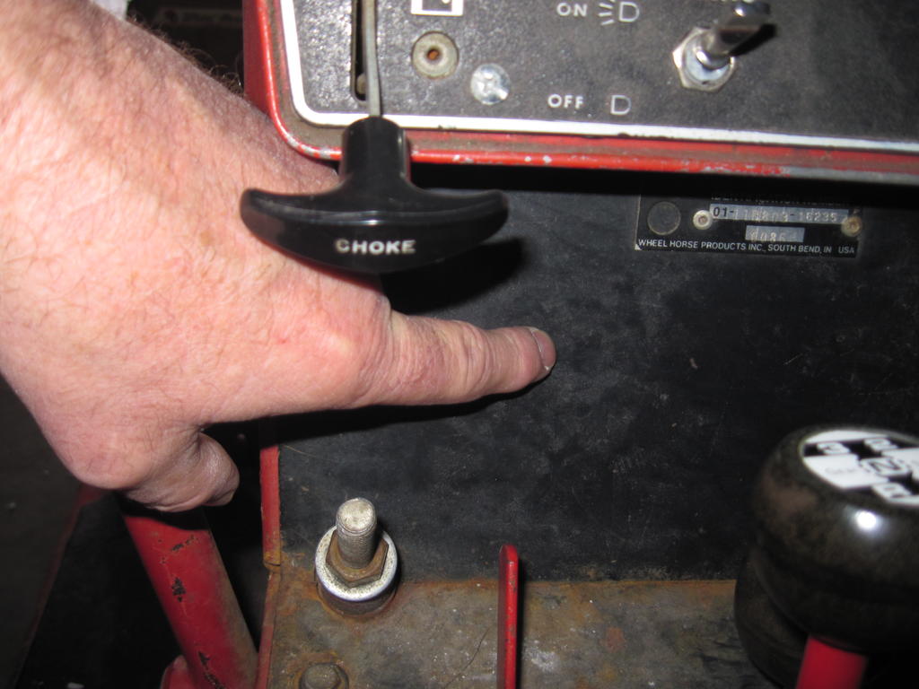

Mine did this earlier this winter I found it was simply the cotter key had either came out of the trunion or had worn out and broke into pieces. If you remove the panel I am pointing to in the picture you will see the upper arm that the trunion goes into. I would look there first it is only 2 bolts to check it. There should be a diagram in the manuals and I'm sure one of our members will chime in with link to it in a few on this assembly.

@Walt Thank you for the tip!  The cotter pin was missing, and I was able to use a finish nail to plow today.  Thanks!
