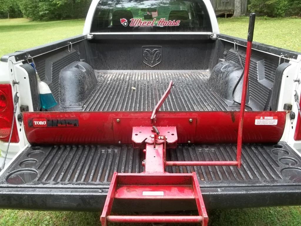

Mike harris 5 #1 Posted January 9, 2018 I have a B-100and have recently purchased a center mount snowplow for 50 bucks(Yeah it was a steal of a deal). Will this plow hook up to my tractor? I ha e had it for 10 years and have only had a tiller, snowblower, and mower deck on. Any info will help. Thank you Share this post Link to post Share on other sites
953 nut 51,625 #2 Posted January 9, 2018 There are two types of grader blade. the first one pictured hooks to a bracket on the rear axle. The older type mounts to the Mid-Mount where a mower attaches. 13 minutes ago, Mike harris said: had it for 10 years and have only had a tiller, snowblower, and mower deck on. Share this post Link to post Share on other sites
Mike harris 5 #3 Posted January 9, 2018 It's a snowplow not a grader. Which I would like one of those next. I will try to get a pic on here of what I have. Share this post Link to post Share on other sites
953 nut 51,625 #4 Posted January 9, 2018 37 minutes ago, Mike harris said: center mount snowplow When you said center mount snow plow I figured it was a grader, pictures will help. Share this post Link to post Share on other sites
Mike harris 5 #5 Posted January 9, 2018 That is the style I speak of. Share this post Link to post Share on other sites
953 nut 51,625 #6 Posted January 9, 2018 The B-100 will need a long frame snow plow frame, the blade could be put on it. Take a look at this manual and you will see the frame you need. Share this post Link to post Share on other sites
Mike harris 5 #7 Posted January 9, 2018 So there is no way to hook it up? Share this post Link to post Share on other sites
953 nut 51,625 #8 Posted January 9, 2018 Here is the one you have. Just now, Mike harris said: So there is no way to hook it up? If you have a welder and a little imagination you can make anything happen. Share this post Link to post Share on other sites
wallfish 15,918 #9 Posted January 9, 2018 23 minutes ago, Mike harris said: So there is no way to hook it up? That's built for a vertical shaft engine tractor, not the same as yours but... 24 minutes ago, 953 nut said: If you have a welder and a little imagination you can make anything happen. Share this post Link to post Share on other sites

Mike harris 5 #13 Posted January 10, 2018 I am trying to see how this is mounted on a tractor. Any tractor so I can figure out how I can rig it to work. I don't have torches or welder to help me out. I have a start just need to see how it lifts. Thank you Share this post Link to post Share on other sites
wallfish 15,918 #14 Posted January 10, 2018 Look in those files which were posted above. The manual shows how to mount it to a tractor. Not many of us have vertical engine tractors, let alone one with that snow plow, so the manual is probably your best bet. Share this post Link to post Share on other sites
953 nut 51,625 #15 Posted January 11, 2018 Here it is. Posted Monday at 09:01 PM Here is the one you have. Share this post Link to post Share on other sites
Mike harris 5 #16 Posted January 11, 2018 (edited) Ahhh. I have ideas (with no welder or torches) to hook this up but they don't pan out. Would this lift the same as my snowblower (by pushing it forward) or does it lift. If I can't figure this out does anyone on this forum close to me want to do an even up trade. This plow for the long frame like I need? Edited January 11, 2018 by Mike harris Share this post Link to post Share on other sites
