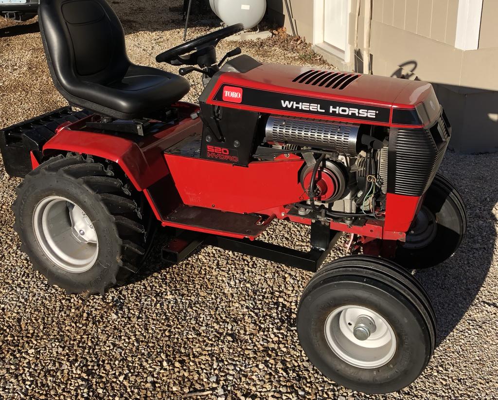

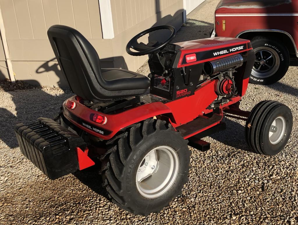

Not really much progress but it’s back on the “road” and running/working.

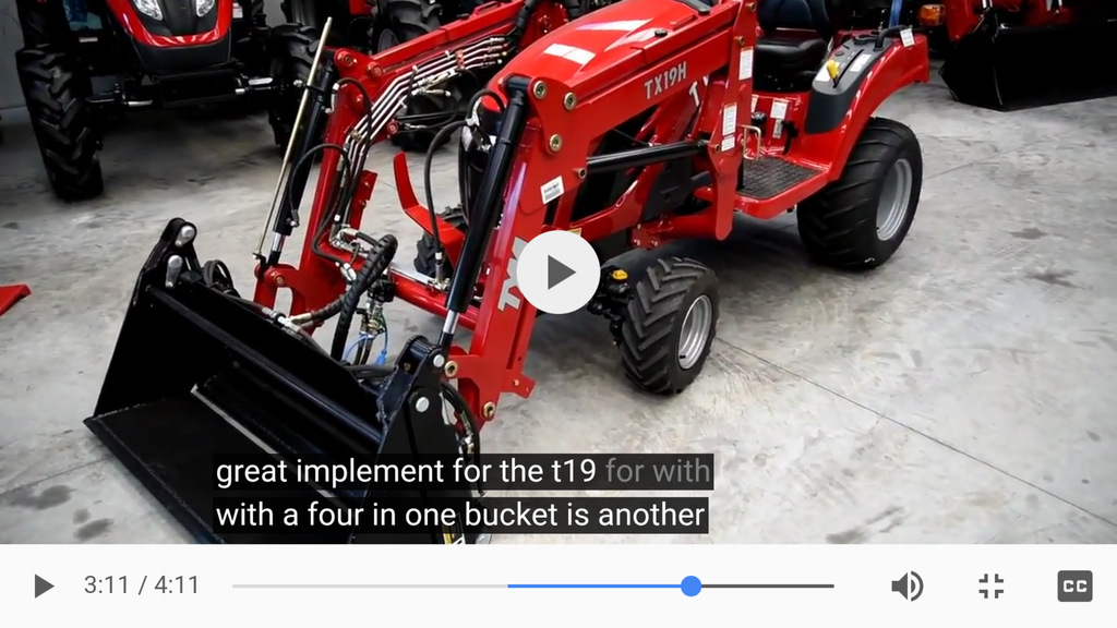

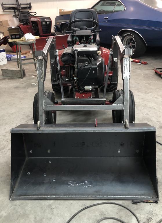

Now if you were feeling really energetic you could try going 4in1 on the bucket like this TYM sub compact in Australia, the foreign markets get all the good stuff and the tractor is about the size of the xi series, Jeff.

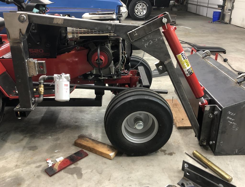

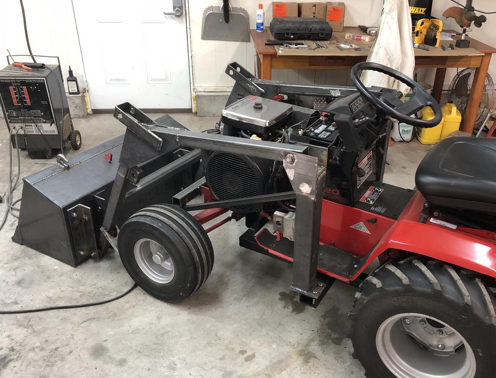

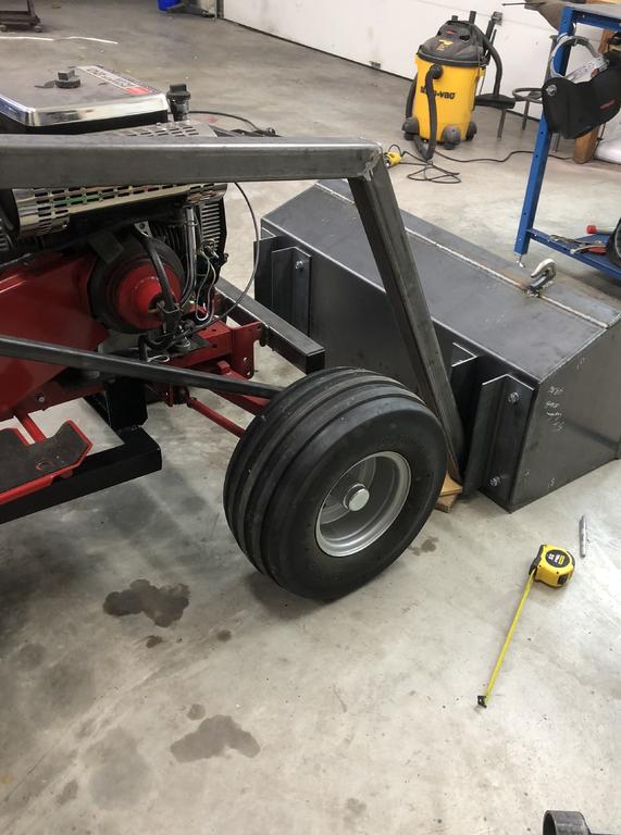

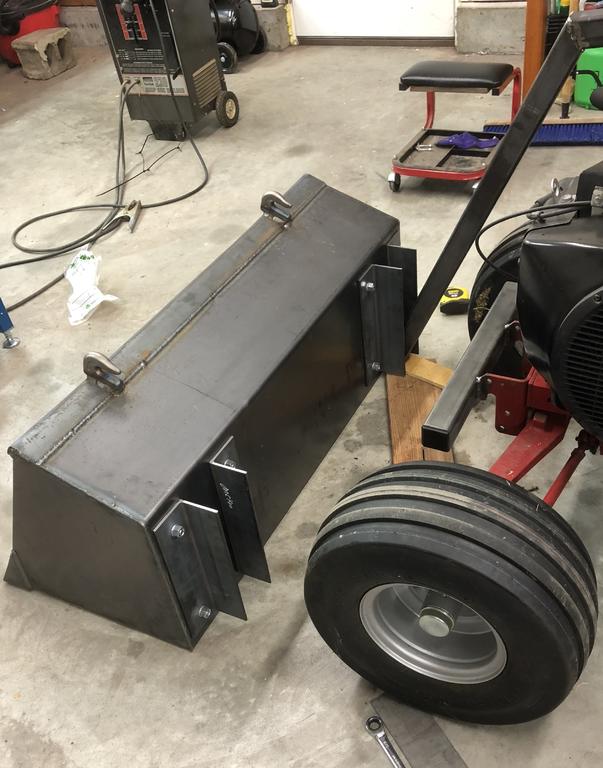

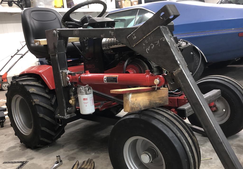

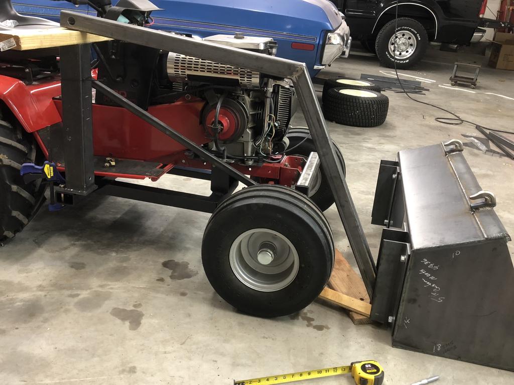

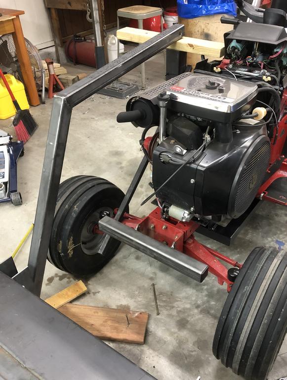

I have a little time off this week so I’m making some progress. I welded some box to the front hitch. It will act as a bumper and give me a point to attach the front of my angle braces. It’s a tight fit getting around the wide Onan using the Cub plans from PF Engineering but I think I made it work.
I also mocked up one up one of the boom arms and the bucket brackets to check clearance. As it turns out, the forward swept axle and oversized 18” front tires make things a tight fit when turning the wheels with the bucket down. The tire rubs slightly on the boom arm. I think lowering the tower boom connection a 1/2” and raising the bucket boom connection 1” will give me the clearance needed without negatively affecting performance.
You do really nice work Craig and clearly have the skills and knowledge. Just a suggestion, if you haven't done it already, is to check the clearance from the front tires with the axle tilted all the way up too. It just appears from the pics that it may still hit when tilted all the way up and the tire turned. I've built stuff without doing that and discovered some clearance issues too late and had to start over or modify. And since you haven't welded on the tower boom connection, could that pivot point be moved forward? :twocents-02cents:
  • Thanks 1
Thanks, John.  That's a good thought.  I did that to check my front bumper/angle brace clearance so I definitely need to to that for the boom arms too.  I suppose I could weld the tower boom connection tilted forward at an angle or fab up some new ones with the connection points moved forward a couple inches.  Thanks again.
I am thinking that tilting it might mess up the geometry of it, but moving the pivot point ahead would be easiest. You could leave the tower where its at and just make new pivot plates or make new plates on the bottom of the tower.
Randy
  • Thanks 1

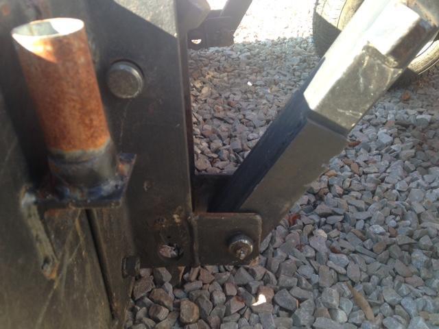

What are the round pieces of pipe for? (Edit:) The forum software doesn't quote the picture apparently. This part was in reference to @OILUJ52's front bucket picture.
Looks great! Building my loader was the most fun I have had with my tractor, and the handiest attachment. :)
Love your weight box too.
Thanks.  I think your talking about the 1” square box tubing. They will be my angle braces from the top of the tower down to the front bumper.
  • Like 1
You replied before my edit. :)
I thought maybe he had made an interesting attachment

Ah, yes. I was wondering the same thing.
Same here , wondered what the vertical round tubes are for on the back of the bucket...?
Sarge
Those are for a re-moveable safety hand rail. My wife stands in the bucket, holds on, and I drive around the hose while she hang x mas lights.

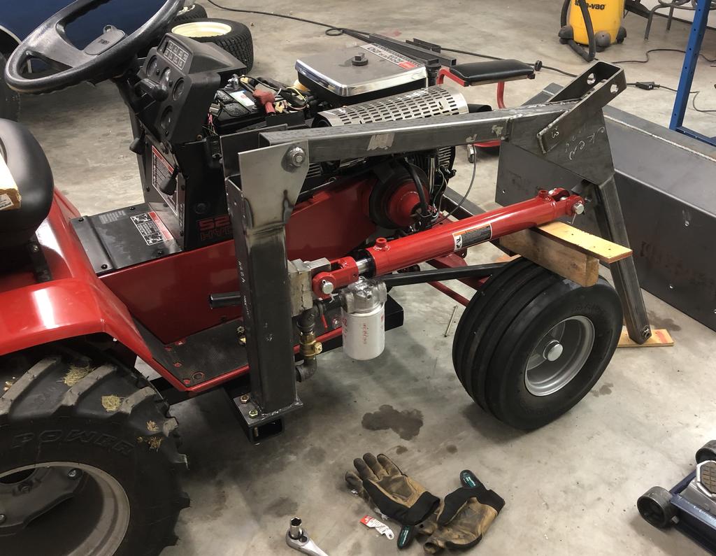

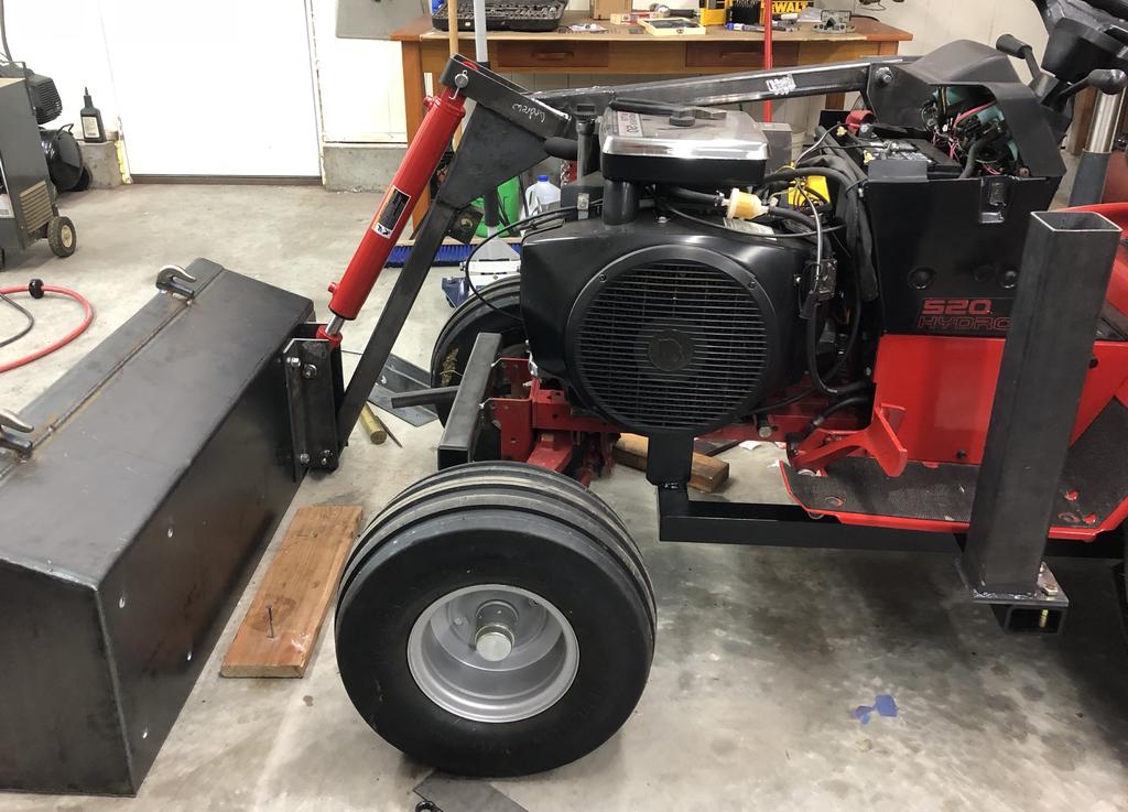

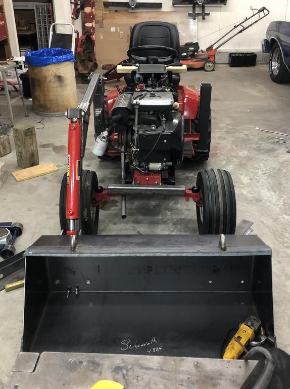

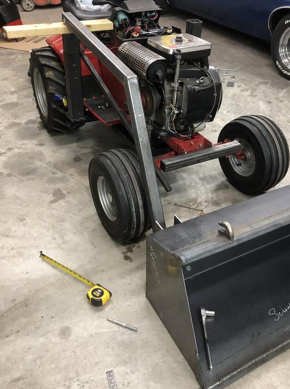

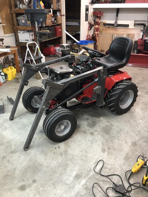

I finally moved the tower pivot points forward a couple inches and did some hydraulics mock up. I’m not crazy about the lower tower mounts but I had the 1”x2” bar stock so that’s what I used. It looks a little clunky but it should work. I still need to do some welding cleanup but it looks like everything fits and will clear after some final adjustments.

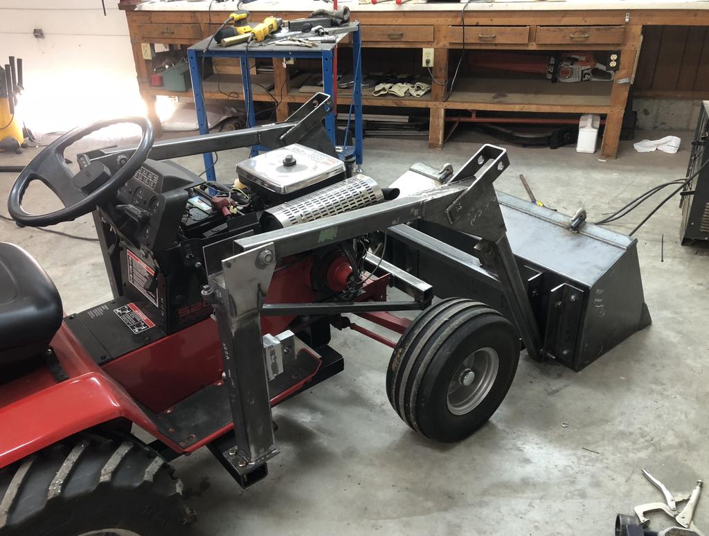

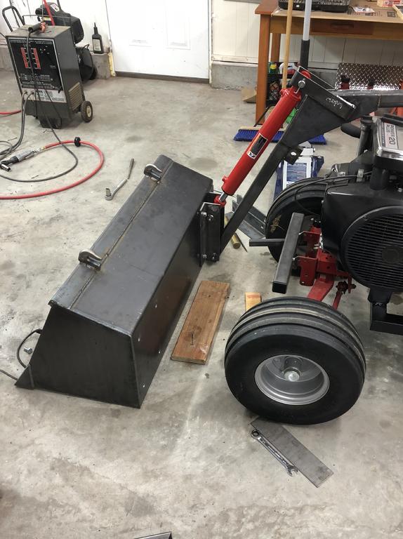

Got the bucket connection points worked out tonight. I highly recommend bolting the angle to the bucket loosely with bushings pressed in place, inserting pins through the bushings to line everything up, tightening the bolts, and then tacking the bushings to the angle. Getting the pins to slide snugly yet freely can be a challenge.

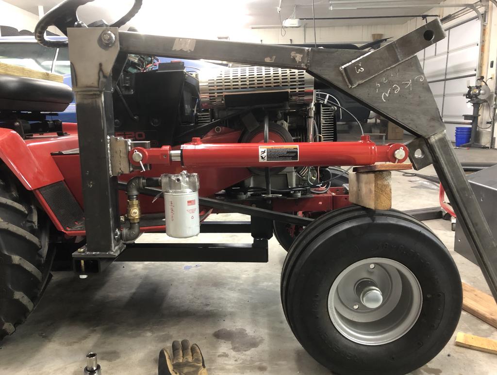

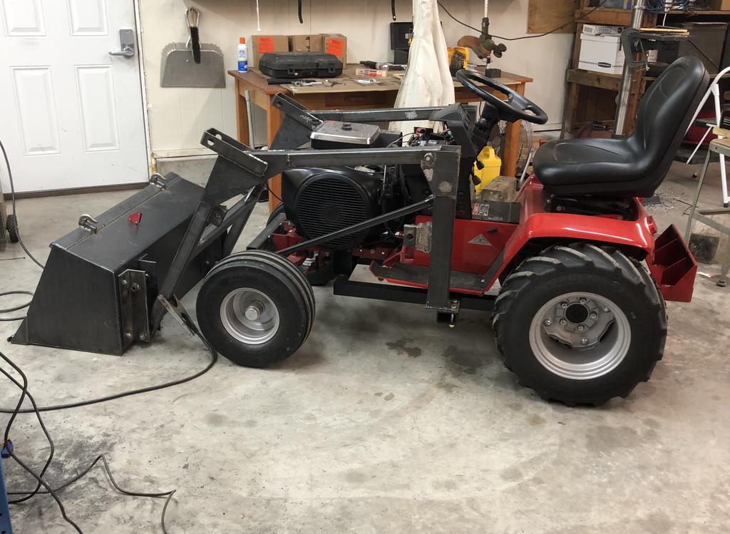

Well it’s been several months because I’ve been swamped at work but I’ve made some more progress. I need to add a couple more gussets and a plate to mount the hydraulic control and clean up a lot of welds. Then I think my ugly welding will be finished.
