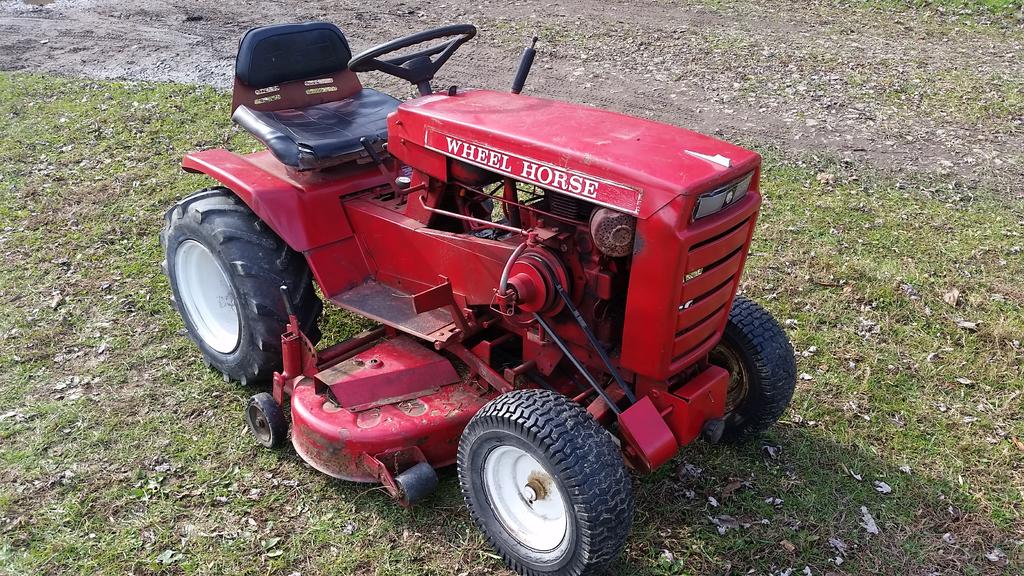

I finally got back from picking up the tractor. I was late getting in and I didn't really look it over. It started and drove on the trailer. When I got back it started and drove off. It was a little tough to start at first and he said it was cold. I didn't notice clouds of smoke.
My truck broke down when I was in Delaware (3 hours from home) and no mechanics open on the Holiday weekend. Luckily he was a good guy and brought some tools and took me to the auto parts store. The idler pulley threw the bearings on my truck. It was an easy fix but took up a lot of time. Hopefully there are no cracks in the block or anything. It probably needs a new battery or at least a charge, it would barely turn over but still started. He said he bought it off a friend and said he didn't own it very long and is moving so he's getting rid of things. I'll check it over tomorrow for any problems and get the belts on.
It started when I got home, it was dark but I didn't notice smoke then either. It also would idle all the way down without stalling and sounds good.
  • Like 2
  • Excellent 4
I spent a little time checking out the tractor today.
- The hard starting was just a loose battery cable terminal. It could probably use a new cable but I just re crimped the terminal.
- The brake does not work
- The choke lever will engage the choke but I have to manually disengage it

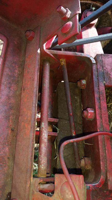

- There is a piece missing on the belt tensioner and replaced with a block of wood
Those are the only things I've found so far. It starts well and doesn't smoke but it does need to warm up a little before it will throttle up. I also put the belts on and it mows right through the thick grass easily, although the grass is a bit more dry than last time I tried. I tried greasing the fittings on the spindles but it looked like the grease would just squeeze right back out the fitting. I have to sharpen the blades so I can check it out more closely later and make sure grease is getting through.
So far it looks like a great buy. The total cost for the tractor, gas there and back and truck repair when I broke down was about $500 and 10 hours.

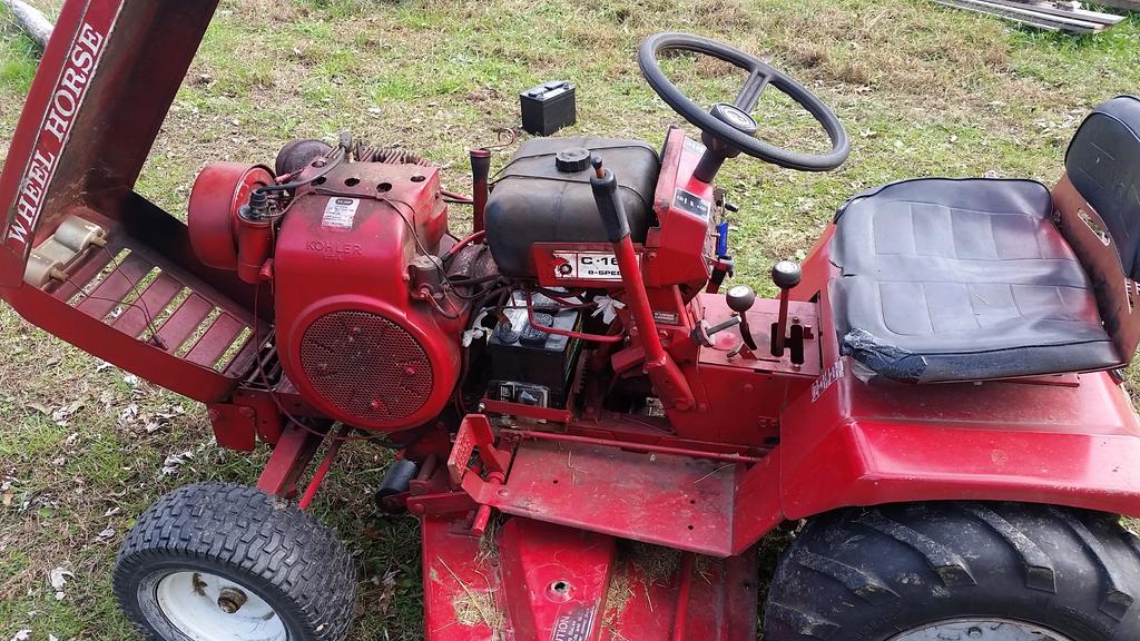

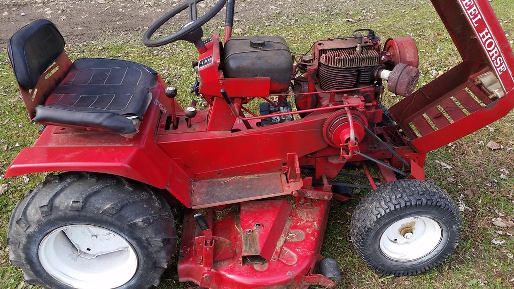

I didn't know what specifically to take pictures of to show. The engine is a bit rusted but seems to be fine. The tag says 16hp but I don't know if it is the original engine or not.
NICE, you got a good tractor!
Take a pic of that block of wood on the belt tensioner.
The choke cable probably needs some adjustment and/or the wire may be bent.
The brake drum is on the left side of the trans. Check to see if there's even a lining on the brake band. Many times the seal leaks oil onto the drum which causes no braking or very little. Could just need a cleaning and adjustment.
Not sure why that cable is but there. They do make a slot hitch to fit on the back and a cable is used to lift it but there's no evidence of that hitch being installed
Take pictures of anything you have a question about. We need to see it in order to help with internet diagnostics.

:text-coolphotos:          Looks like a well cared for :wh:. The choke cable jacket should be secured to the engine block near the carb, that may not be tight. Like John said. can hardly wait to see the wood block on the tensioner!        :ychain:

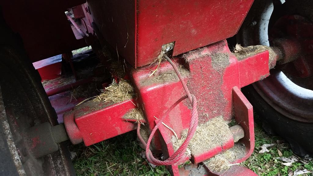

Look under the center of it and see if that cable is attached to the mid lift arm on the other end of it - someone probably cobbled it to lift a rear implement at one time as the original lift for the rear is missing . Keep an eye on the classifieds here and elsewhere - they come up often at a reasonable cost . There is a whole list of attachments that can be used on the rear of that tractor in either the Brinly clevis style or WH slot hitch line .  Hopefully that cable a previous owner installed didn't cut a groove in the top of the transmission case .

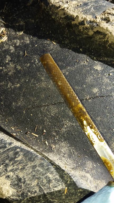

I checked out the c-160 a little more. The main concerns I found is that the transmission fluid was kind of foamy and a strange color and the engine does sputter a little. I forgot to check the spark plug. I tried taking the air filter off to see if it was the same and there was no change. As far as the transmission, it seemed to function fine.
One picture is of the dip stick under the seat. I don't know what it should look like but I didn't think that it looks good. Is that anything I should be concerned about? I don't even know where the filter is.

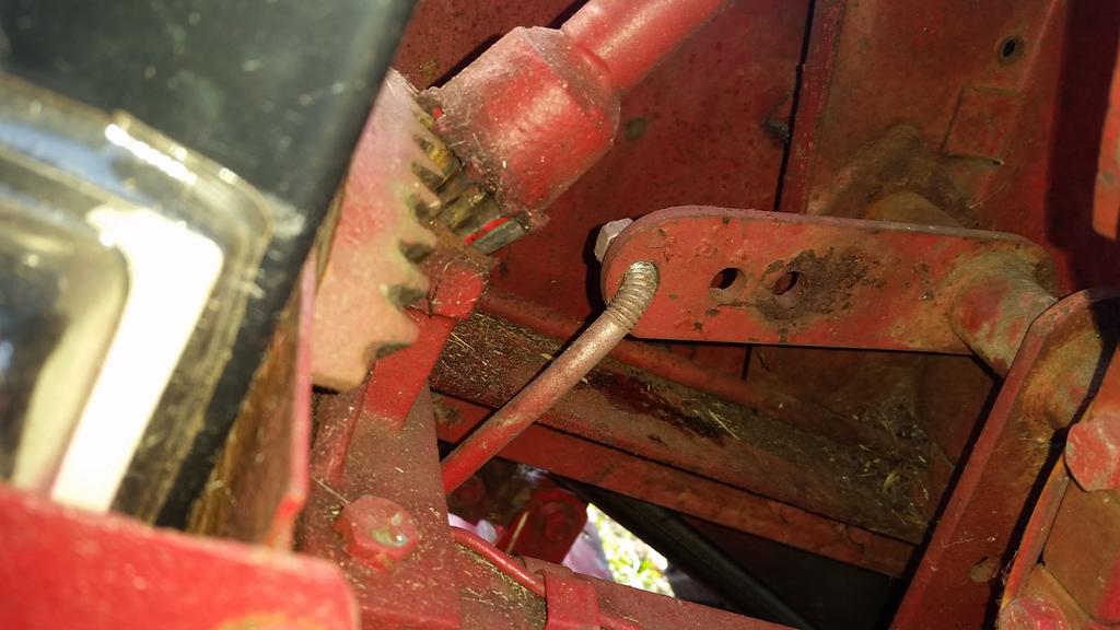

- The threaded rod that lifts the deck is missing a piece and bent/modified to work (pictured)
- The belt tension piece is missing parts and a wood block put in (pictured)

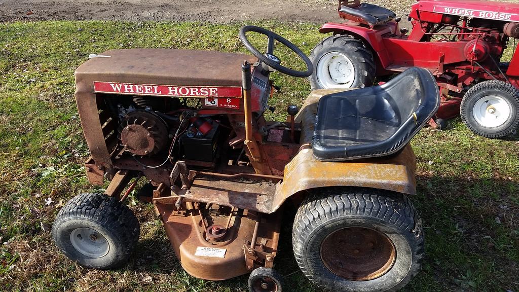

Thanks for these tips, as you have probably noticed I went and bought another tractor. At this point it isn't entirely about mowing thick grass, it's becoming a new hobby. I'd like to get this k181 going as good as I can. I'd eventually rebuild it if it needs it.

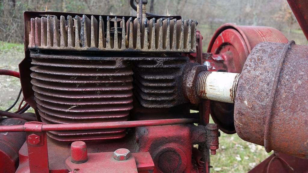

I sharpened the blades today and put the belt guard on the 8hp no name, the blades were extremely dull and rounded over. I think it is possible that they were never sharpened before. I should have the head gasket next time I work on it (which should be Wednesday). The gasket was blown when I got it but I patched it with gasket maker so I could drive it on and off the trailer, then I later forgot it was patched and tested it out with a little mowing in thick grass and blew it again. The engine smokes a lot of blue smoke when started.
- When I put the new gasket in do I put it in dry or add a little gasket maker?
- For a compression test do I just put the tester in the spark plug hole and turn the key?
- For a leak down test do I plug the exhaust and carburetor area and add pressure/vac?
- I think I can handle cleaning the carburetor but I don't know how to adjust it or the governor.
- When checking for warp on the head, do I basically clean it up and use a straight edge to check it?

The cable is attached to the lift arm. I didn't think to check to see if it cut into the transmission. I'll have to check the hubs next time. As far as the transmission, it has the 8 speed manual. I don't know where the filter is but the fluid did not look very good to me.
No filter on the manual transmission, Sarge was referring to a hydro.
The gear oil got water in there which causes that coffee color. The drain plug is on the bottom, it's a hex key plug. once drained fill with diesel fuel to wash it out and run it in all gears for just a bit. Drain and refill. It easiest to remove the shifter and fill through there. Check the shifter boot which you will probably need a new one to keep the water out of the trans.
For the deck tensioner, mule drive. Take a look at the one on the 73 -8. They are the same so you can check it out to see what parts you need or swap them if using the deck only on one tractor at a time.
Don't run that 8hp without the blower cover for very long, it will over heat quickly.
The transmission should have 10 W 30 motor oil and the filter is a NAPA 1410. A gallon of oil and a filter will be cheap insurance. The filter is under the seat pan on the right side.   Just read John's post, never mind!
No sealer of any kind should be used. Torque to the proper setting in the proper sequence and then once it has come to operating temperature hot torque it using the same setting and sequence.
Yes presuming it is a screw in uni and have the throttle wide open.t
I will attach instructions
I will attach an engine manual
use a sheet of wet/dry 400 grit paper with oil, attached to a sheet of glass and sand it until no dark spots are present then switch to 1000 grit and finish it.

So do I fill the transmission with diesel and drive it a little and use all the gears?
Yes, or jack up the rear end and sit it on stands.
  • Like 1
Yes, and be surer to jack up the front end when draining as there is a hump in the middle of the casting that will prevent complete draining otherwise. 2 quarts of 90 gear oil will fill it after it has been flushed. (John posted while I was typing.)
So I do this on top where the piston and valves are, not the cover?
I looked at the leak down test article. It's a lot different than a chainsaw. It looks like with these you just test the leaking for the piston, valves and gasket and there is always some leak, you just figure out how much. I'll have to look into it when I get to that point.
You will be smoothing the surface that makes a seal with the head gasket. Chain saws are two cycle so would be different.
