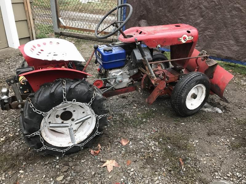

1961 Wheel Horse Suburban Followed me home to get freshened up

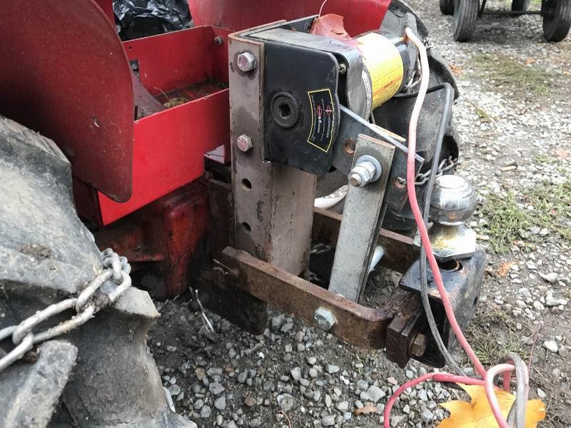

That rear winch idea from the PO is a good one. Attaching an arm into the winch.
I like that much better than using a wire cable plus it can give down pressure if the winch has the power out option instead of just free spooling. It gets the wheels turning for different ideas on how to use something like that. For instance, quite a few people have used a winch with the cable for raising a snow plow but doing it that way seems more versatile with down pressure. Snow blower lift? Figuring out a way to link it up to the rock shaft for electric lift for all attachments is another good application for that. Ect. Ect. Ect.

Yea i was highly impressed with the lift system as well ( awesome ingenuity ) - I have done a few Linear actuator lift / angle controls, and have used a winch / cable / pulley, but never crossed my mind to remove spool and use flat bar . . . YES = Excellent idea for controlled down pressure and guaranteed no cable mess when slacked.
While I did ponder just that = Alt /gen off pulley and install battery - I have decided to keep this old wheel horse simple with a manual lift, and I am going to save & use the winch lift on my 1966 Case 120 if I ever get time to work on it (it is going to be for me) not sold like most of my restores are to facilitate the continued addiction. . . . The Case was given to me by a good friend, and will be kept, as it just so happens that's my last name = UNFORTUNATELY I am not related to the corporation tho :angry-banghead:

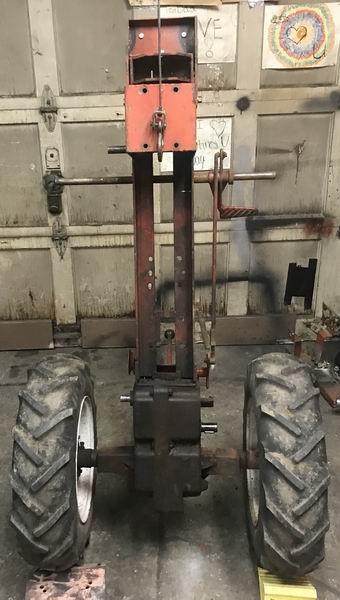

Well Life got a little crazy, and we spent our Turkey day in the hospital with my "selfless" mother in law who has been diagnosed with a stomach full of cancer. Amazing woman= not one complaint ever from her and she spends her life worrying about others - I'm very fortunate = How many guys can say they have an awesome mother in law !!! We are doing our turkey day today now that she is back home.

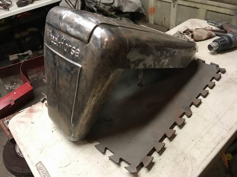

I did get a spare hour yesterday to get her all pressure washed. . . . .  Now time for paint prep / hood repairs / etc. etc. = need to locate some decals

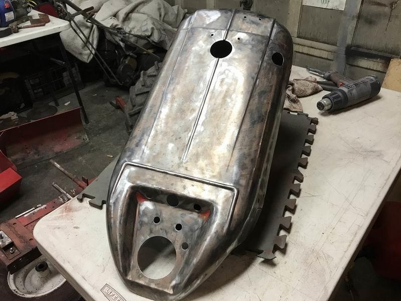

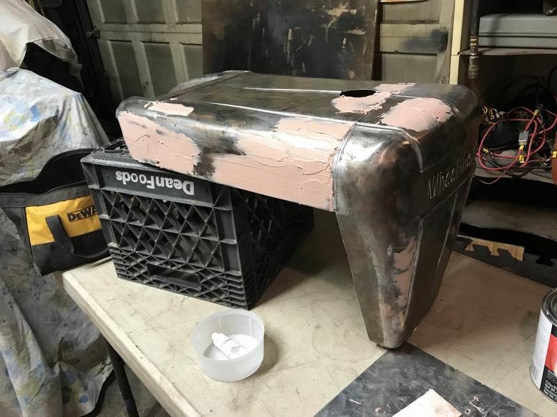

Hood is stripped down to bare metal and ready to be tig'ed . . .

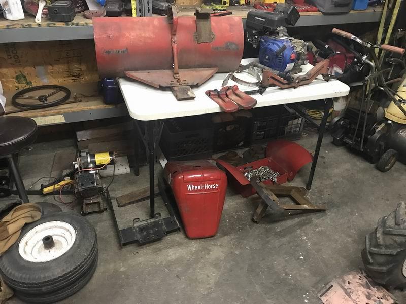

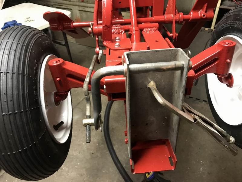

Anyone know what the dimensions of the STOCK fuel tank was that mounted under the hood with the metal straps ? :text-feedback:
Steering gears were bone dry, but in good shape (forgot pic of other gear but looks great)
Drained the rear end :scared-eek: / Plenty of gear lube, but Not sure that's been done to many times as  it was some Gackey stuff - Going to flush the entire rear end with gas or diesel  Then leave to dry while painting / before refilling
It was a Kohler oval tank but not the smaller K91/K161 tanks. Think it's 3/4 gallon but could be a gallon or somewhere in between.

as as for the tank - remember I'm not a ejumacated wheelhorse guy so I was hopping for actual dimensions :scratchead:
i might be be able to modify the tank off this aftermarket motor but it would require me to make the whole little bigger in the hood and I'd rather not do that

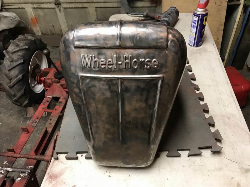

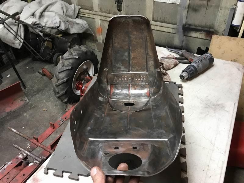

Hood holes and cracks are tig'ed + Pile-O-Parts are almost all stripped and ready for primer. . . .

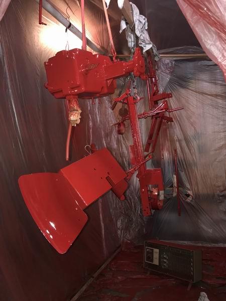

Test sprayed the paint I bought at the o'le tractor supply store, and it looks pretty good
They had only 3 reds to choose from, so I went with Van Sickle Oil Base Gloss Tractor, Equipment and Industrial Enamel Paint with rust arrestor in "Gloss Case IH Red 455 70"
  • Like 4

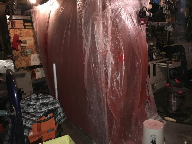

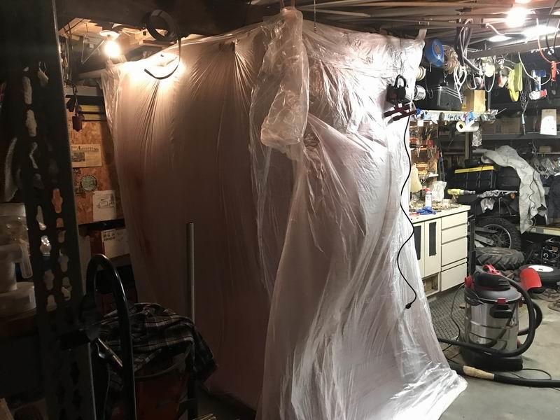

Well was colder then all get out yesterday, but was the only day I had to spare, so I fired up the wood stove in the garage - Built me a Hillbilly paint booth with Exhaust fan (old leaf blower with hose out exhaust port in garage door) and spent the day burning brain cells even tho I was fully suited / head sock / Respirator. Amazing that stuff can get through the best of respirators. . . . Suspended a 2x6 through to hang items and threw some old dry rags along the top of 2x6 to keep the humidity down.
If your not aware of the "ease" of use / construction with rolled thin painters plastic and a can of 3M spray adhesive = simply spray one side of plastic and it sticks / seals instantly to anything and itself - Old Painters masking tricks IT WORKS AWESOME - residual glue "generally always" lifts off floors / walls when plastic removed.
Looked Like a crime scene room towards the end of the evening :-o Dam the garage is a Mess :confusion-scratchheadblue:

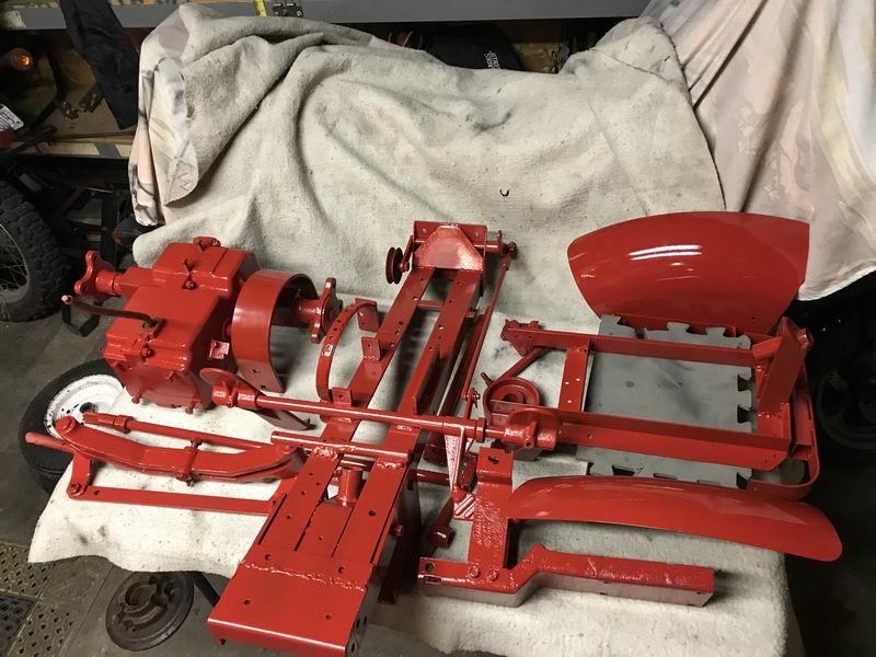

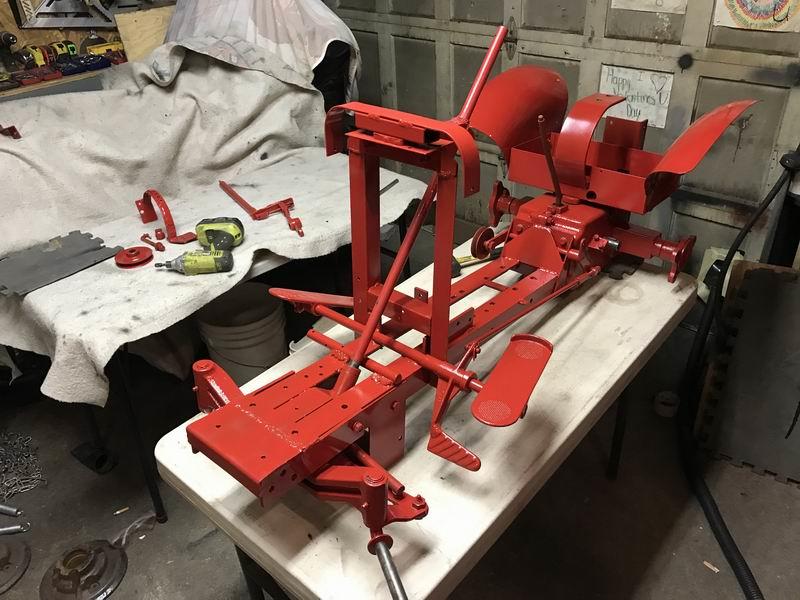

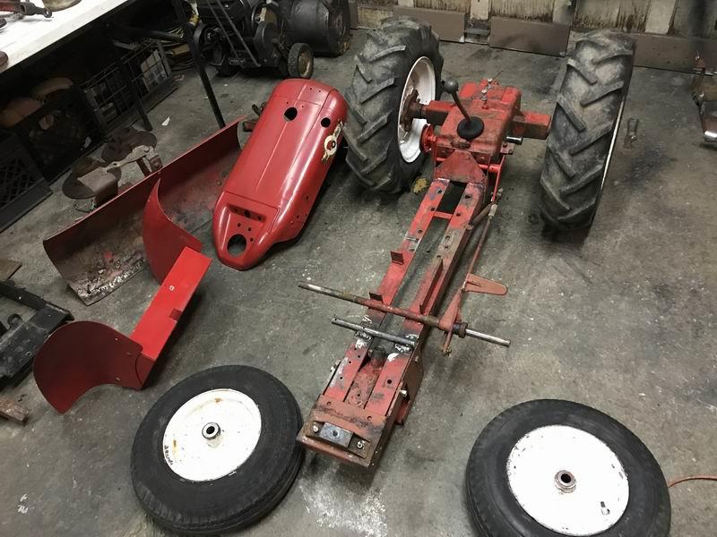

Fully Dismantled - Most everything is done except the hood / snow blade, Seat and front rims

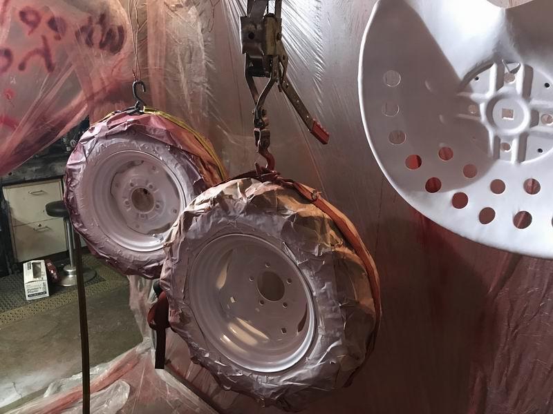

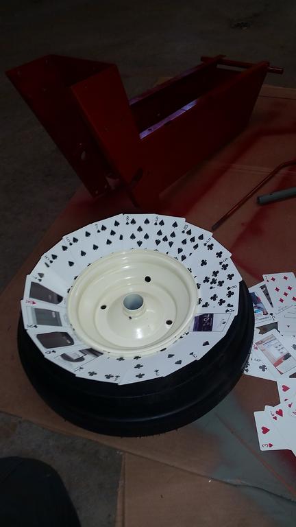

Nifty way to hang tires for paint......it was in the cards these rims get painted. They say you get a better finnish if you use all RED ones!:lol:

:confusion-confused: That's exactly what I am wearing :teasing-tease:It's got red paint drift on it. . .

I have done it that way (Cards) as well but was using cheap paint and got some leakage  :angry-screaming:

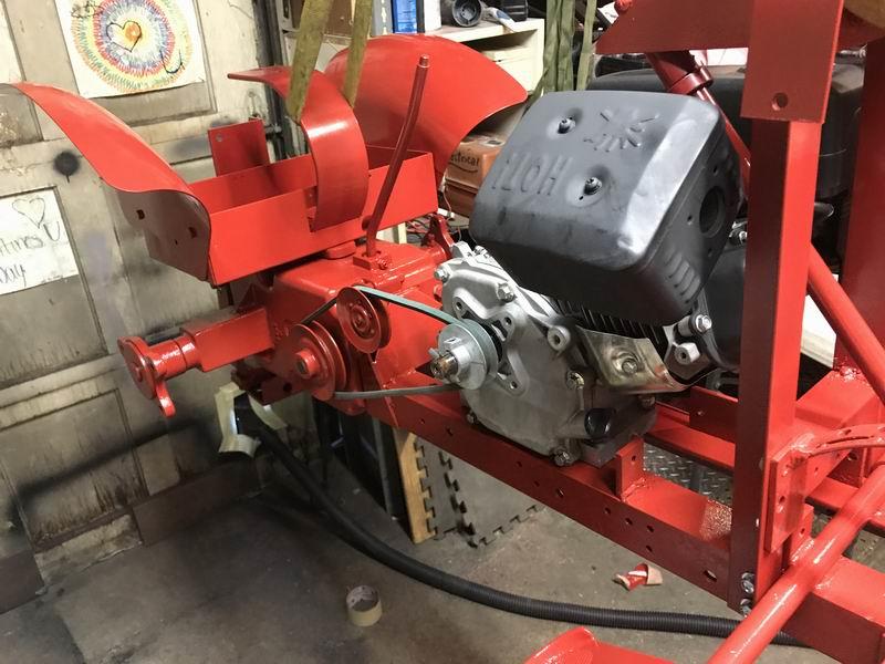

By the way . . . The reconstruction has begun :happy-bouncyred:

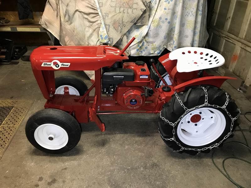

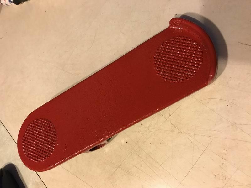

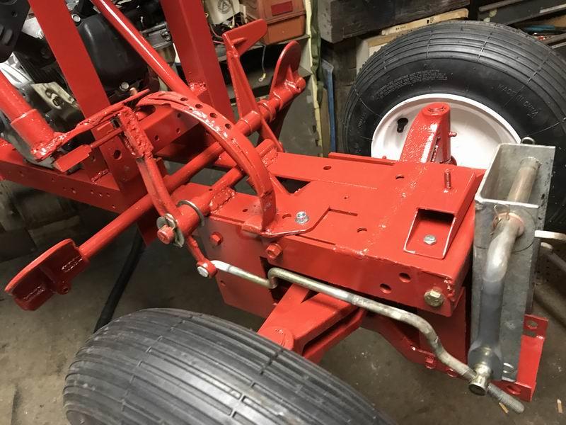

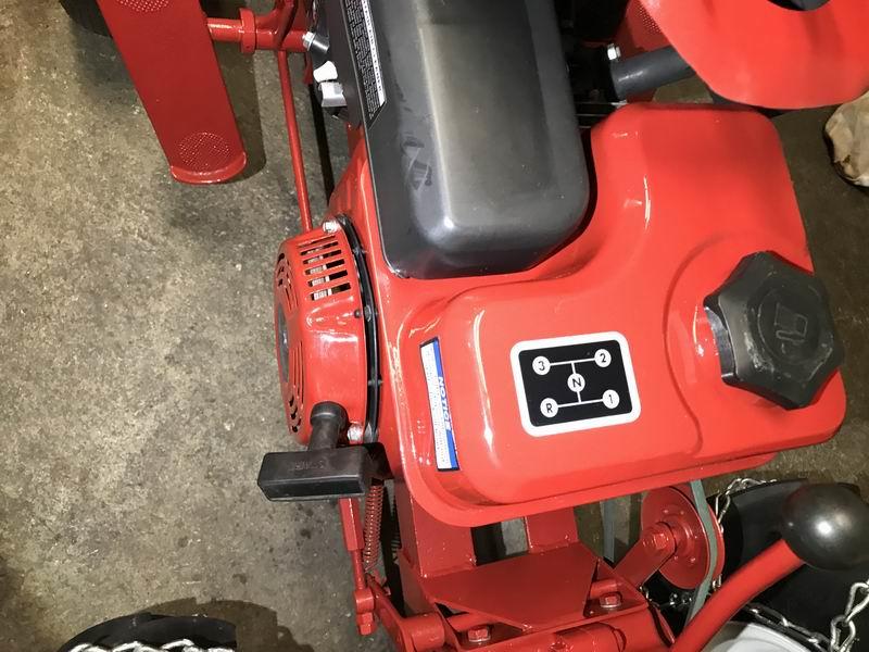

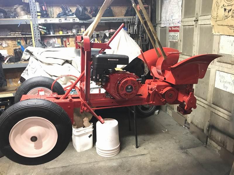

Well I found some spare time and got a little more done - ALLLLLLMOST done

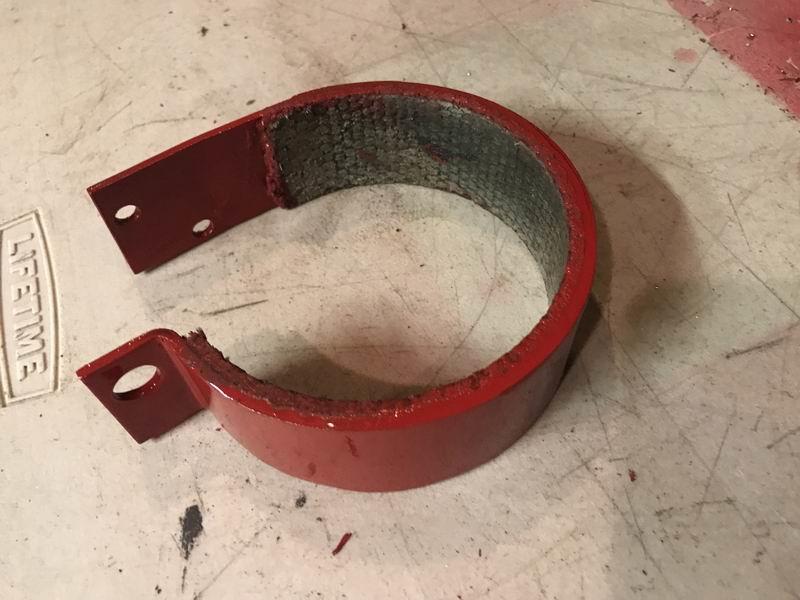

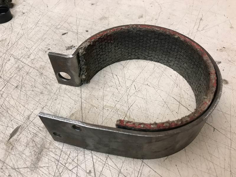

Brake pad re-glued with epoxy, and a little touch up in those slightly missed areas

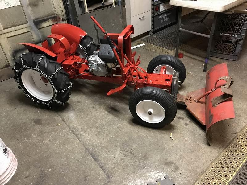

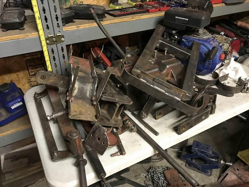

Had to custom build the lifting mechanism for the plow for the last hurdle - did not get pics of the lift system complete prior to paint
All done and figured out I tore down the paint booth prematurely

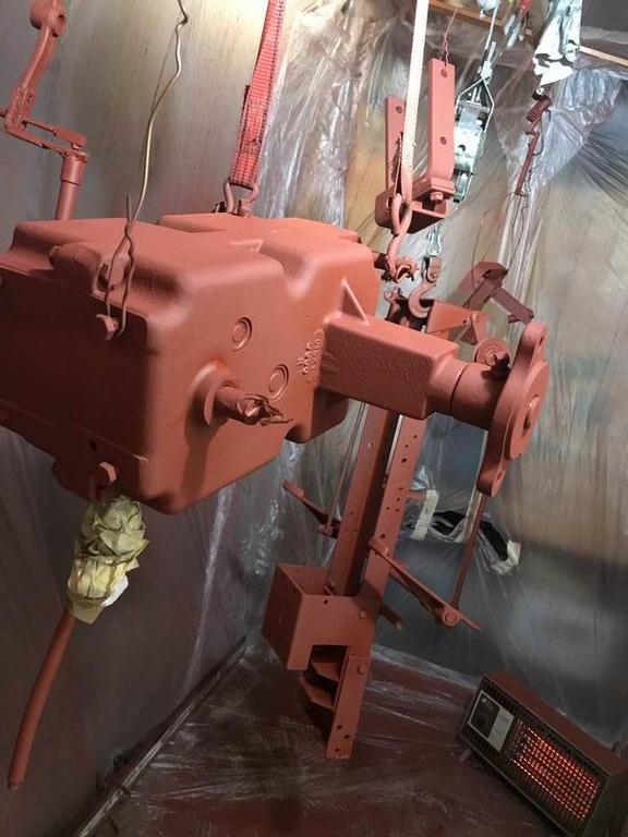

Put up another smaller paint booth to finish all the plow and last minute "ooops" I forgot that parts
Plow and lift mechanism is painted along with misc parts, and going to dry in the paint booth for a day or two as it is bittier cold her - then I can get it all bolted together for the final / Completed pictures :greetings-clappingyellow:
Local tire selection was unfortunate minimal, and I did not want to wait for shipping, so I went with the old wheel barrow tire look. . . :text-bump:

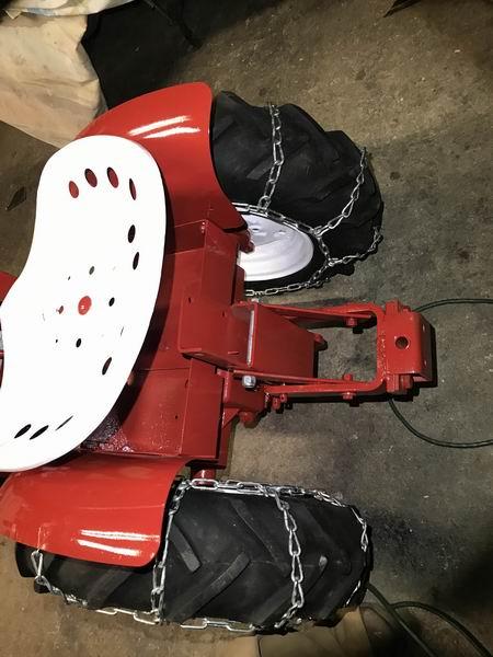

Decided to go with a simple fixed rear hitch . . . .:confusion-confused:

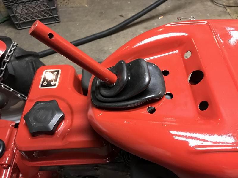

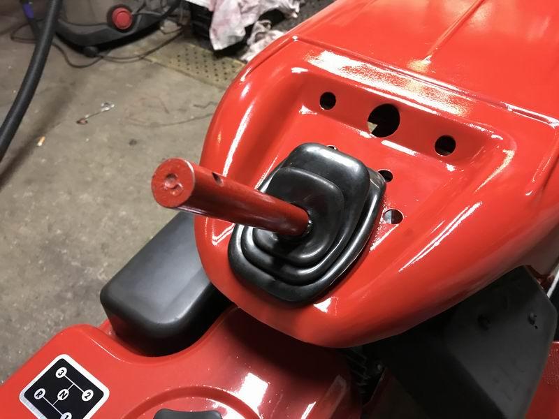

Also had an old shifter boot that worked great for filling the hole around the steering column . . . .

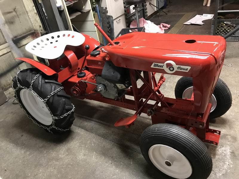

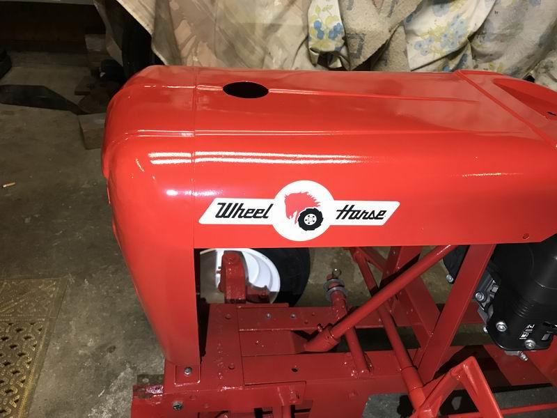

A HUGE THANK YOU TO TERRY AKA VINYLGUY - the decals look awesome (Crap I think the left one's ever so slightly low to the rear), and I cannot resist = :text-thankyouyellow: = the membership was above and beyond Terry = My Hat is off to you my NEW friend :bow-blue::beer:
:angry-cussingblack: You have now given me a new addiction - :angry-steamingears: "I've got a horse - A Wheel Hose OF COURSE" The thrill of the chase will be great, as the old wheel horses are a tough find here on the west coast, but I am up for the challenge :handgestures-thumbup:
She has come  along ways . . . . . . . . .
Edited by Spokane Dave
  • Like 6

Very nice work ...gotta like your jack stands! Nice job on customizing that steering boot!  Be careful with that  motor pulley you should be going with a steel one Those have been known to fly apart and strike in bodily areas not meant to be struck in!

:text-coolphotos:        Nice work!    You did a nice job of easing the edges of the cuts on the hood.     :handgestures-thumbupright:    With the location of the Predator engine it will be a nut warmer, not a roaster.      :ychain:
Thanks - I actually have an air lift table, but its at a friends, and the old girl was light enough to just hang
Yea I forgot someone mentioned replacing the pulley - Will get that done as it does not sound like a fun experience if it grenades

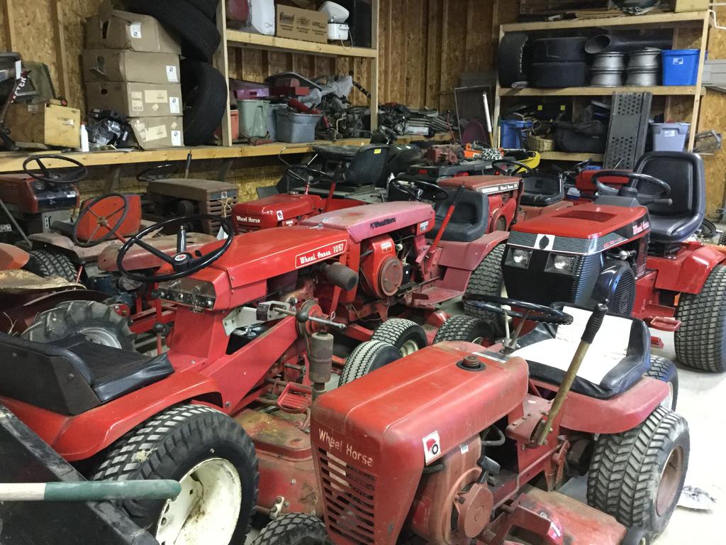

Once bitten by the the :wh:Horse bug there’s no turning back your addicted !....I grew up literally in a Allis Chalmers dealership. I bleed orange . Found my first Horse (RJ) and had all intentions of making into a WD replica. After talking with @Dhodge learning some history and finding :rs:it was all over....I was addicted. Now just a little 2yrs later this is what part of my barn looks like now.
Thanks - Holly Crap batman that's  a helluva collection you have there - Not as easy to find on my side of the field LOL

Thanks - a little extra heat is good this time of year in this neck of the woods
