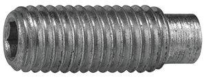

Many guys have used dog-point set screws from McMaster-Carr. Their 1/4"-20 set screw has a dog-point that is .156" (3.9 mm) diameter.

Hi Bob, thanks for your reply, I have had a bolt turned down to 3.9mm diameter and refitted the gear stick but I still have a problem and hope someone can point in the right direction.
The gear stick is fitted with the dog point screw locating it but not too tight as I assume it needs some movement but it is stuck in gear.  I think it is in second but not 100% sure.  The gear stick is back close to the seat which would correspond to 1st or reverse but will not move forward.  I assume the lever was not correctly located before fitting the locating screw.  I am not quite sure how the screw should work because unless it is very 'sloppy' it will only allow side to side movement of the lever.  Can anyone help please?

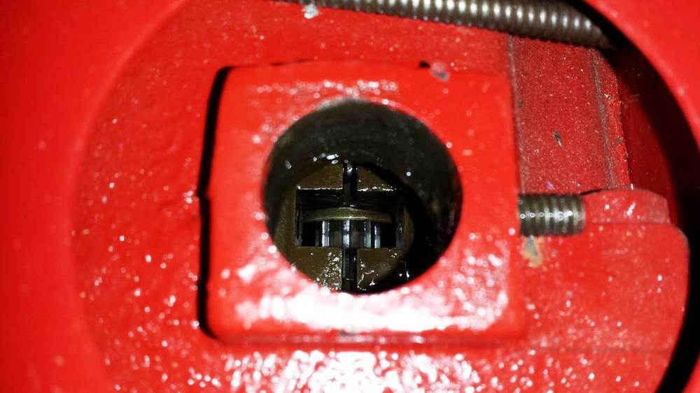

Wheel Horse shifter fix
If your shift lever comes out of the transmission or is stuck in one gear first back out the “Dog-point” screw that retained the shifter. Take a look in the hole the shifter came out of to be sure it is in neutral as shown above.
Inspect the dog-point to be sure it is in good condition and back off on the locking nut a couple of turns. Insert the shifter and run the dog-point into the dimple in the shift lever collar snugging it up with an allen wrench, don’t tighten it. Be sure the shifter works smoothly then tighten the lock nut while holding the dog-point steady with the allen wrench.

Thank you all for your assistance here, the picture was especially helpful.  It's all back together now and working as it should.

And  953 Nut, thanks for the view down into the transmission for the correct alignment before inserting the lever. I spent hours studying transmission overhaul info but that single picture of yours is exactly what I didn't have and exactly what I needed.

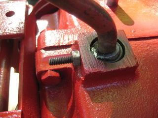

Hello everyone, I am facing a similar problem. In other posts I have noticed a nice picture of the shifter with with the collar attached. Should the collar be physically attached to the shifter and come out in one piece? When my shifter came out, the collar was left in the hole. I am afraid of unscrewing the set screw any further and losing the collar down the hole.
It should be attached to the shifter.
Mine have all been welded like in this picture.
  • Like 2
:WRS: RDF
Most are welded as Bob's pic shows  but there have been reports of them  attached with a roll pin. Fashion a hook of sorts and try and hook it out while slowly backing off the dog point. You do not want to drop that in the transmission or you will be splitting the cases. A strong magnet or grab it or tight with a needle nose vise grip might work to pull it up and out but I would stick with plan A. Replace the roll pin once out to locate it back on the shaft  and then have it  welded.

Excellent! I managed to fish it out without dropping it in. Looks like mine was indeed just a roll pin with no weld. The roll pin is completely sheared. I guess that is my problem. Thanks for the great advice!

Just my:twocents-02cents:worth, but I've never been able to get a shifter lever anywhere near back in place unless those two forks, or whatever they are called were in the position that the picture shows.(looking in the shifter hole)Guess that is what is usually neutral, right?
Edited by Horse Newbie
Better choice of words
Yes that is neutral as shown in the pic. It is the easiest to put the shifter back in in that position. The transmission should be in neutral when adjusting the dog point.  If its not in that position an appropriate screwdriver can used to get it there.
