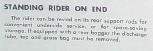

grinchsr 591 #1 Posted October 26, 2017 What do the experts think of storing a 108-5 on its tail for the winter? It has the bagger brackets on it so it stands up and is stable. Gas tank is already empty and battery is removed. Share this post Link to post Share on other sites
Sparky-(Admin) 19,280 #2 Posted October 26, 2017 From the manual... 1 Share this post Link to post Share on other sites

wh500special 2,050 #4 Posted October 27, 2017 FWIW: At least some years of the 100-series had pivoting battery trays that allowed this feat without even removing the battery. Great little mowers. 1 Share this post Link to post Share on other sites
