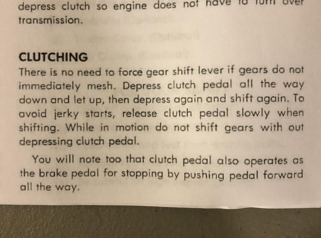

32 minutes ago, cschannuth said:
 Here’s what I found in the manual for my 701. It just says to make sure to use the clutch while moving and shifting.
Interesting.  Yes, my 702 shift on the fly without issue as long as it's under no load.
I've never felt any grind, popping, or resistance.  I'm sure it's always best to start in the gear you need, that's why I posted this thread, but again, if it's not resisting, popping, or grinding when you shift, how can it be hurting the trans either?  Seriously asking here.  Any one?:huh:

I do it to mine and any other stick tractors I've had. Not pulling anything or climbing a hill but just driving across the yard or whatever. Like manual says push clutch almost all the way down, bang the next gear and go.
  • Thanks 1
