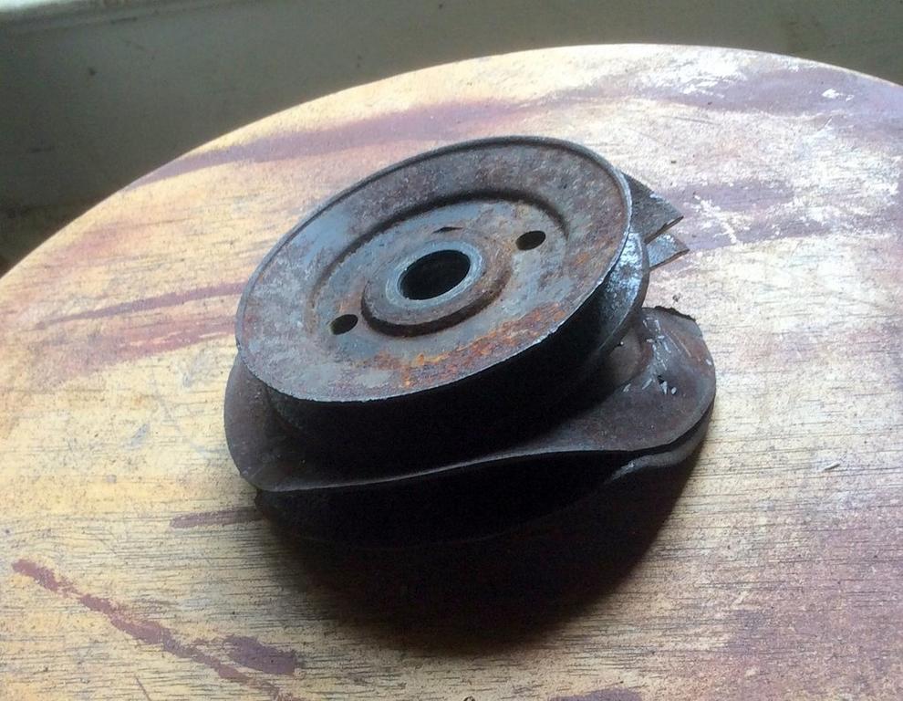

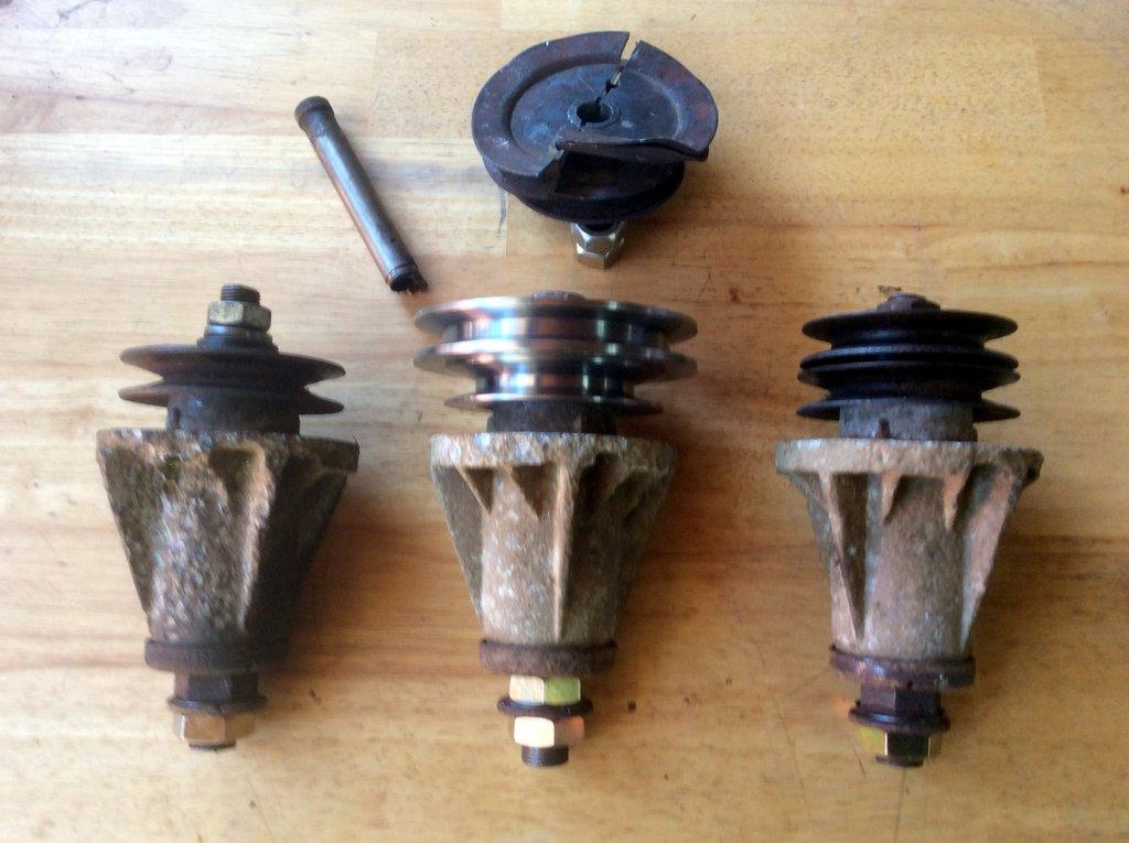

I have a 42 SD Deck to repair. Two of the pulleys released one did not. The center two pulley drive spindle was cut off and removed with great force.
Cutting the spindle as well.

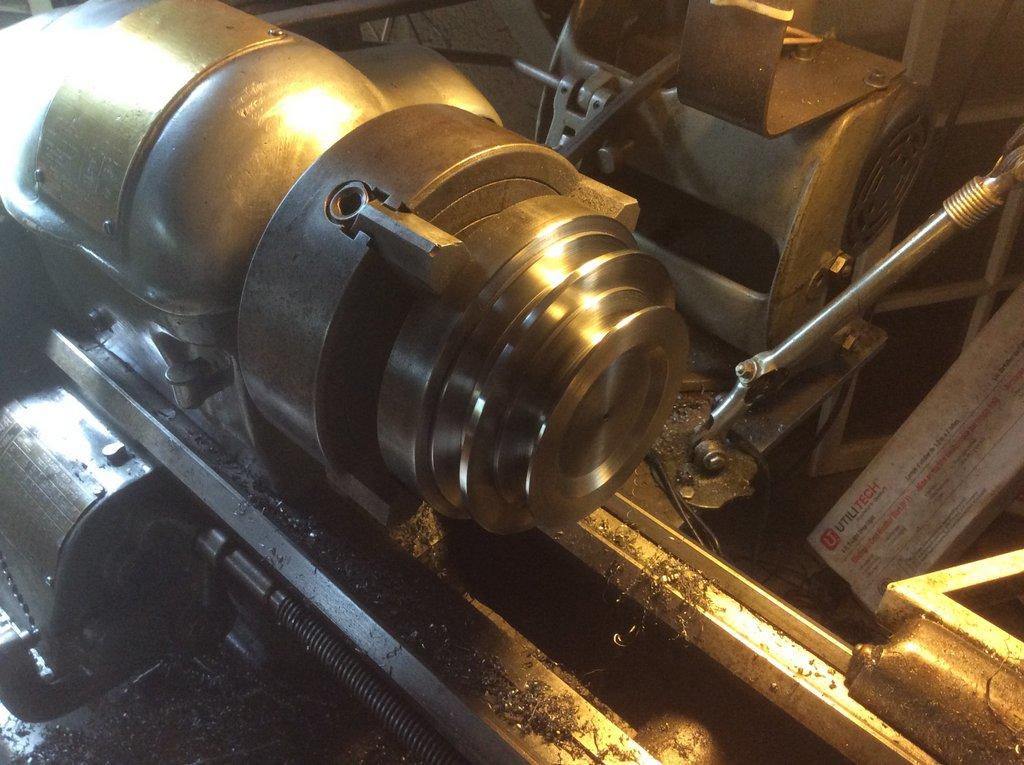

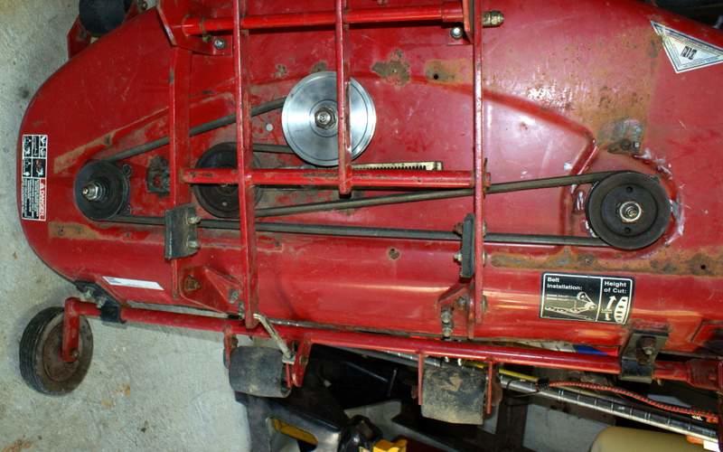

I never made a pulley before so it was a good project. The critical spacing for the pulley was the lower one ( smaller) with the deck belt so it would line up with the other two pulleys. The top side was less critical as it just just to the PTO side alone.
Dimensions were copied from the existing spindles and the original mangled pulley. The double small same size pulley on right is for the bagger unit.

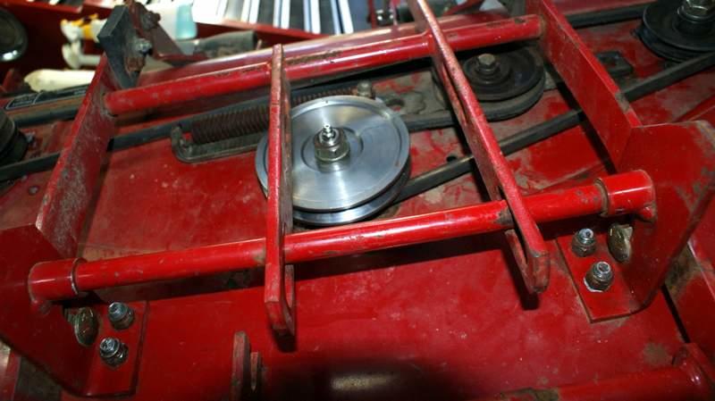

Curious to see how the now heavier Steel pulley runs on the deck,

The new pulley is made from C1018 5 inch round Steel.
  • Like 2
Freshly cut grass clippings, especially damp green grass have a acid like property to them. That’s why the aluminum is eating away, plus as already said the mating of the two different metal caused oxidation. This is also sped up by the grass clippings. Wet grass when left stuck to the bottom  of a deck for any length of time just eats away at it. That’s why I scrap mine often and at the end of mowing season they get power washed before being put up.
Good looking lathe work. I’ve been making my own spindle shafts for some time now.

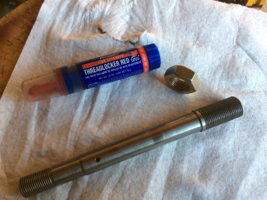

The spindle is made from 4140 alloy steel 3/4 diameter.
I threaded the spindle on the 3/4 ( blade ) end and used Red Loctite to place the thin 3/4-16 Grade 8 hex nut in the proper location on the spindle. This saved from buying hex bar and turning the whole length to the 5/8 an 3/4 diameters.
I may cross drill and pin the lower 3/4-16 with the red loctite. No need for it to ever be moved once placed.
The blade side nut is grade 8 3/4 16 as well.
The pulley spindle end threading is 5/8-18. Grade 8 as well.
The spindle is cross drilled and I need to pick up grease fittings to finish them.
I also need the O rings for the spindle. Two of three were still there when disassembled but they just fell apart when rolling them off.
The bearings seem fine.....roll smooth. I did not remove them from the housings.
Should I pull the bearings to soak and clean them or leave alone. ??
I assume the inner grease shields are removed to allow the grease fittings on the spindle to purge them with fresh grease. Maybe just grease them heavily the first time ?
What do think ?
Thanks

Raw material was well below items cost. I think the spindle and pulley were $50 apiece.
The 5 inch round was a cutoff for $20 and the 4140 3/4 was a long length for $25.
The steel shop did offer to face or cut the 5 inch round to width, I should/will do that in the future. It took forever to face of the extra 3/4 inch off the back side, filled the trash can with a huge pile of chips.

Did you consider making the larger driven pulley about an inch smaller in diameter, say 4", to speed up the deck for a better mowing job?

Possible I could just swap the double bagger pulley to the center. The PTO deck belt might be a bit long at that point.
A smarter guy would talk about blade tip speed and rpm. Comparing my Craftsman mower with the Wheel Horse decks, the Wheel Horse cuts and mulches much better to my eye.
