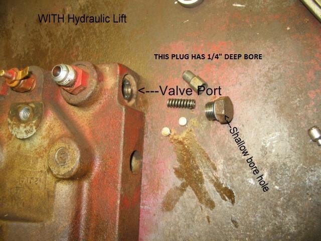

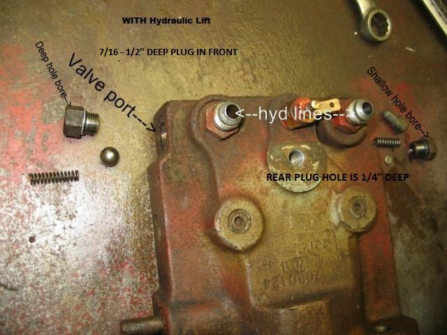

formariz 11,849 #1 Posted September 23, 2017 I have a c-125 with the Sundstrand hydro but no hydro lift. I have already obtained all the necessary parts to convert the lift. Can someone please illustrate or inform me what is necessary to do to pump in order to accomplish this? I believe there is a small change that needs to be done but I cannot find what that is. Thank you. Share this post Link to post Share on other sites

daveoman1966 3,562 #3 Posted September 23, 2017 (edited) Here are a couple pics of what to do: I have all the parts you will need.. contact me via direct email to: daveoman@windstream.net Edited September 23, 2017 by daveoman1966 4 Share this post Link to post Share on other sites
formariz 11,849 #4 Posted September 23, 2017 Thank you Garry and Dave. Yes Dave, will contact you later today. 1 Share this post Link to post Share on other sites
