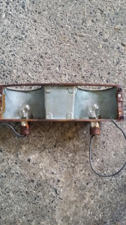

Does anyone know how I can easily remove the bulbs in this headlight assembly? :confusion-confused: I've been soaking it in kroil for a couple weeks now and they won't budge. :rant2:

The bulbs won't just turn .... they need to be pushed down a little to unlock them.  So it's push down and turn.  If that doesn't work just turn the glass part until it separates from from its brass base.  Then take a small screwdriver or such and bend the brass base inwards until it's loose from the socket.  That should do it.
  • Like 8
  • Excellent 1
push down and turn a 1/4 turn.
If the glass breaks use a pair of needle nose pliers and grab
 the edge-twisting it out.
  • Like 5

Yes I know that they won't push down at all I will try vinegar

Try white vinegar. It hates rust. Cheap too.

@cafoose You may want to wear a good pair of gloves when you try pushing down & turning the bulb. A tight grip on a bulb when it breaks really hurts when the glass has to be dug out of your fingers!
Personally, I would just break the glass and use a needle nose pliers to bend/turn the brass base out of the socket.
I have purchased several single contact "pigtails" from NAPA in the past, as well as the springs & fiber washers.
  • Like 3
:text-yeahthat: been there, long time ago. Now I smack them and shove a straight screwdriver down into them and rotate them out. No rotation equals using a pick and bending the brass body as mentioned early and pulling out with needle nose pliers.
  • Like 4
  • Thanks 1

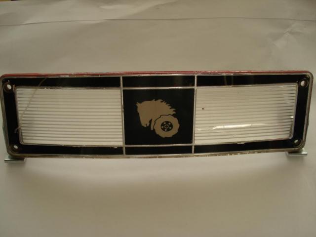

:text-thankyouyellow:Those are all excellent suggestions. Does anyone know of a good bulb such as an LED that would give it a stock appearance with a brighter light and that would last longer?:techie-idea: Does anyone reproduce the factory lenses?

:text-thankyouyellow::techie-idea: Does anyone reproduce the factory lenses?
A couple of years ago I bought new lenses from a TORO dealer...They were still available at that time.

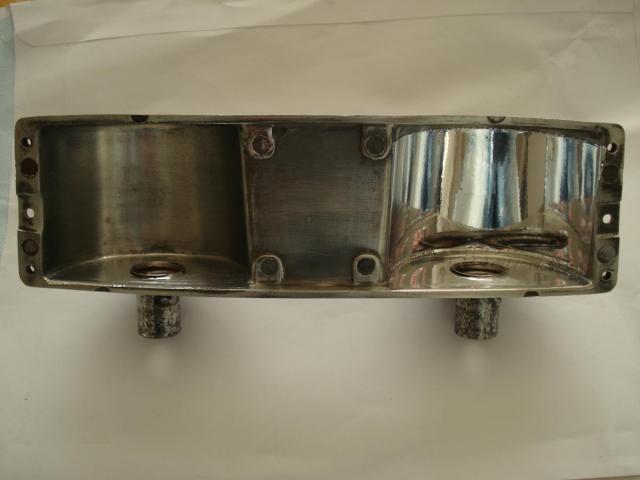

Headlight Unit and lense were in a real bad state, thought I may have to scrap the Buckets as the Bulb Holders were badly rusted. I managed to clean them up and had enough metal there to petrify them with Kurust.
Again , covered in several previous posts, the improvement of light reflection of these 'Buckets' has been achieved by using Self Adhesive Chromed Mylar and Polished Aviation Grade Aluminium (U.S readers please delete the last ' i ' to read Aluminum) Speed Tape.
As I'm using LED SMD Low Temp Bulbs, I've blocked off the upper and lower vents, giving more reflective surface, but still allowing some venting - here's an idea of the difference
