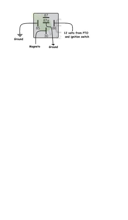

Phil902 70 #13 Posted September 9, 2017 Updating and begging.....I rewired 90% of my C-161. I didn't do the headlights, no urgency and busted lens, and I didn't do the rectifier, as I didn't want to pull the flywheel if I didn't have to. I replaced the coil, and it started right up; I obviously fried it with the relay jumper. Now to the kill relay. I had a new 5 pin relay in my horde that was for a trim/tilt motor on a 115 hp outboard I sold awhile ago. It's labeled exactly like the relay 953 posted. I've spent the last week reading everything I could find on RS related to kill relays on C series tractors; I've watched a few dozen you-tubers explaining the mysteries of relays (or trying to). The end result is I'm still confused and paranoid I'll kill another coil. I do think I now understand how it works, please correct me if I'm wrong; the key in the "run (or start)" position energizes a switch in the relay which opens, preventing the magneto from completing a path to ground through the ground connection in the relay. The power to the relay switch comes from the battery through the ignition switch terminal and then the PTO interlock. Turning the key "off" (or leaving the seat with the PTO engaged if properly wired) kills the power and causes the switch to close, completing the path to ground and shutting down the engine. I think (but I'm not at all sure) that the wire from the PTO to the relay should be connected to the relay terminal labeled "86", and the ground wire from the tractor frame to terminal "85". After that I'm lost, and if that much is wrong, I'm lost and adrift. Terms on the schematic like High Power Feed and High Power Output scare me as I can still see the jumper wire smoking. I could use a lifeline. In other news, I took the badly rusted and partially seized mule off. I tried electrolysis for the first time, since my 30 gallon compressor kept popping the breaker after using a die grinder and wire cup or wheel for awhile. I was impressed with the result after a short time in the tank and a little brushing . (I was even more impressed that I didn't electrocute myself in the process.) I saw a couple of cool ideas here on getting the pulleys off which I'll try this weekend. I cant see a bearing. It appears to be a band of metal that the pulley(s) is riding on? Slow progress is still progress. I'm grateful for the help I've received on this; on my own, I would have stuck it in a corner of the yard by now and hoped the brush overgrew it before my wife noticed it and mocked me incessantly. Share this post Link to post Share on other sites
gwest_ca-(File Mod) 10,491 #14 Posted September 9, 2017 You are correct on 85 and 86. Your ignition wire from the engine goes to 30 Also ground 87a Relay schematics are usually illustrated as in their at-rest state. (Not powered) With the ignition wire on 30 and 87a grounded it will shut the engine off. When the ignition switch powers the relay coil at the bottom of the illustration it becomes a magnet and draws the relay contact down to 87 from 87a. In your case 87 is not connected to anything so now the ignition wire is not grounded and the engine runs. Garry 1 Share this post Link to post Share on other sites
953 nut 51,630 #15 Posted September 9, 2017 9 hours ago, Phil902 said: I now understand how it works, please correct me if I'm wrong; the key in the "run (or start)" position energizes a switch in the relay which opens, preventing the magneto from completing a path to ground through the ground connection in the relay. The power to the relay switch comes from the battery through the ignition switch terminal and then the PTO interlock. Turning the key "off" (or leaving the seat with the PTO engaged if properly wired) kills the power and causes the switch to close, completing the path to ground and shutting down the engine. 100% correct! Share this post Link to post Share on other sites
