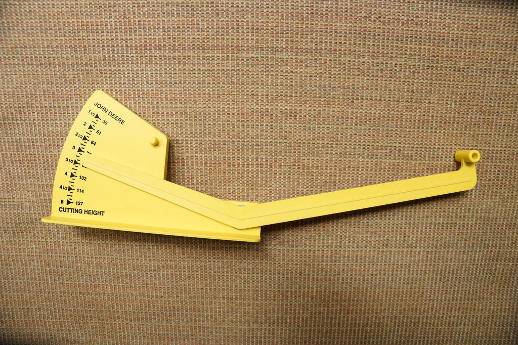

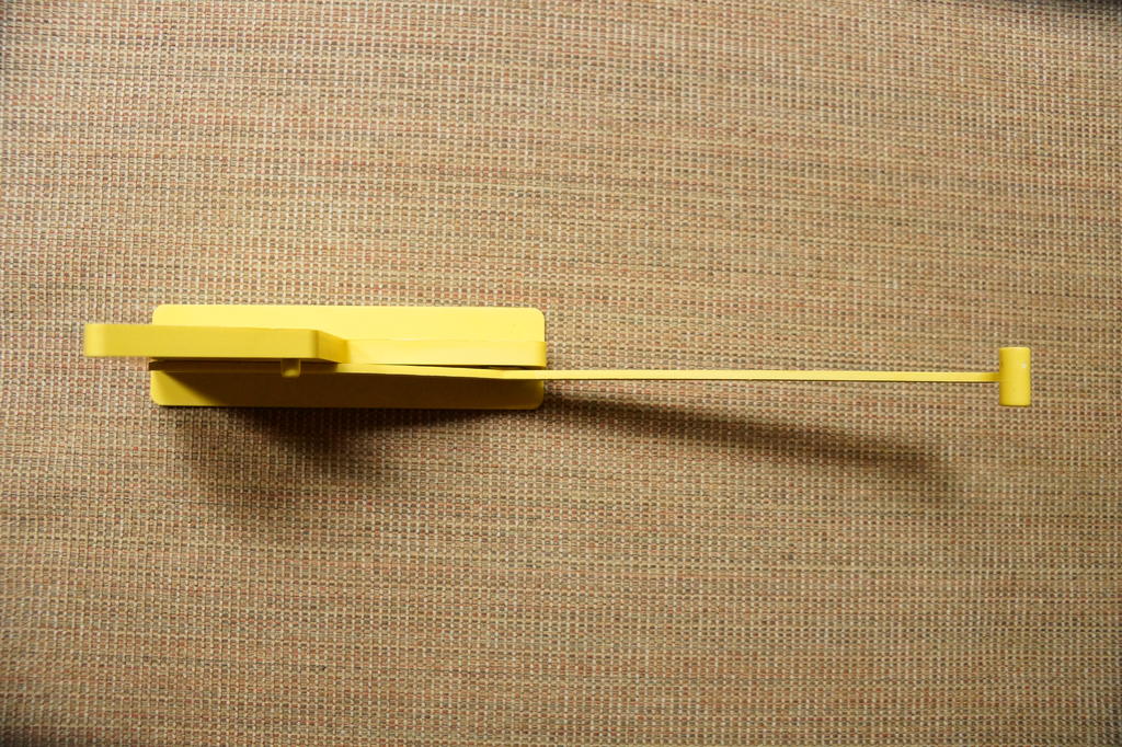

Just like Doc said, you need to measure the blade height. Find the Owners manual here in the Manuals section. You may have an issue with the deck being attached to the tractor as well. Once again I offer the suggestion on RS of getting one of these tools to measure the blade height made by Sten, etc. I found mine at a JD dealer. It makes life much simpler.

Thats a neat gadget. I will have to get one.
