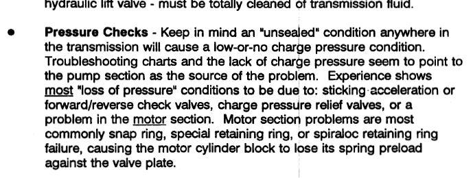

Do you have access to a hydraulic Pressure gauge (at least 200 PSI???)  Charge (makeup) pump pressure is first test.  Acceleration valves are always suspect.  You say you replaced the pump did you open it up??

I am trying to find a good replacement for the seal part 102817, can anyone tell me the best replacement for that seal? Also, the pre-load may be in question on the hydro motor, the clip that is notorious for breaking, what clip is that, what part number? I never had the hydro apart so rather wait to find out I had hoped to order that in advance with the O-rings and such.......
Thank you.
The spring clip is 200204.  Where are you seeing the seal 102817??  I didn't see that on the piston to piston listing.  You do not have the external brake band on your machine do you???

I did receive an envelope, many thanks going out to pfrederi. The hydro unit was sealed pretty good, needed some good o'l German persuasion, "push good & hard"! I failed to realize the top two bolts were case bolts! Da-hah! See the gear shaft protruding over 3/16ths, and it turns with some difficulty. Perhaps a broken spring clip? The strainer was semi-attached to the old gasket, good thing I didn't knock off  the hydro unit completely......
  • Like 1
Well, that was the culprit! The replacement hydro motor works nicely. Many thanks to forum members that helped me through the repairs! I ran the unit tow valve off, all directions and then closed the tow valve and again all directions, works wonderfully! Quiet too........
