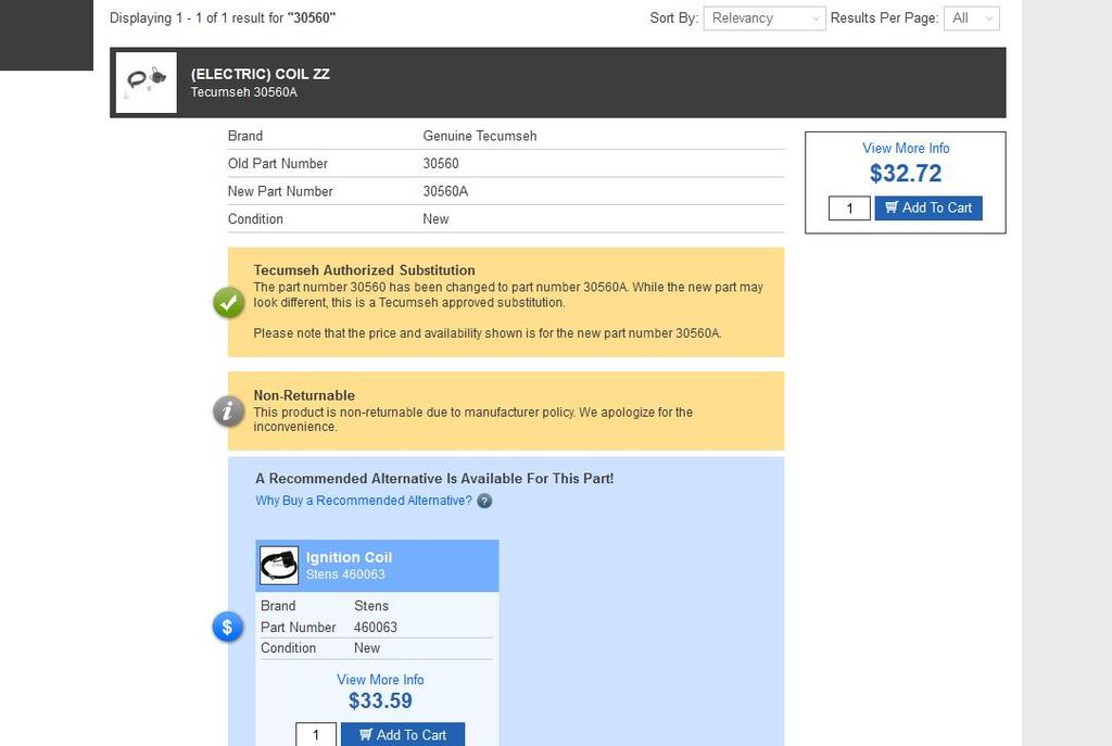

Give the spec # in original post it is a recoil start... coil assembly is 30560

That's what I thought it was I didn't know if there was a different one for older models since mine is not held down with a metal rod (for lack of better terms). Mine has a shim that slides between coil and the metal bracket that the coil installs to. Does it matter that the new could have two wires that hook up to points and the original only has one?
