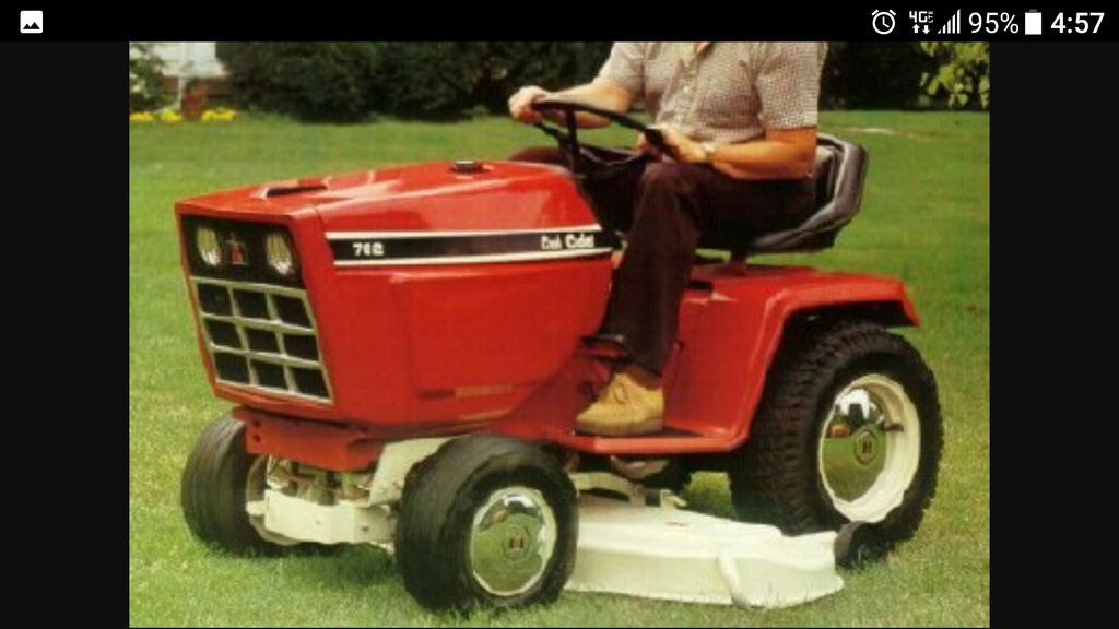

Cub Cadet 582 682 782 23x10.5-12 ag tires and rims  Looking to see if these will fit my tractor.
Need some advise.

Should be fine, use a tape measure and something for straight edge across the tire to check your backspacing on your WH wheels, then the CC wheels just to be sure you have enough clearance for the hydro fan ect, Jeff.

I don't think hub caps will work with those valve stem locations.  That's obviously not an issue if you don't plan to ever install caps.

They'll just have to be the IH ones if you can find them, Jeff.

I had a 582 at one time  and, depending on the model, you will find the backspacing is different than a Wheel Horse wheel. Like Jeff said, measure the backspacing. You could use a pair of spacers to make up the difference.
