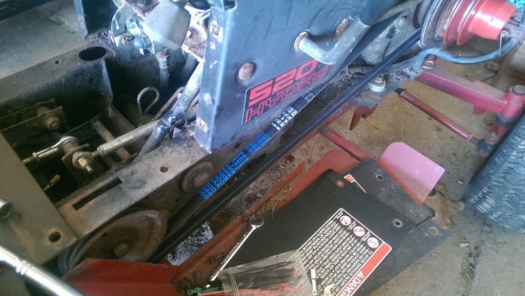

1991 520H changing drive belt. do i need to remove engine or fan pully to do this?

no, belt guard and possibly the rear fender pan, PTO clutch assembly, and the foot rest will also make it easier

Removal of rear fender pan optional, no need for taking the floor/running board off, but would take the rear tire off, and of course the PTO assembly, check the idler pulley/axle bolt in the frame and tension spring all in all not a too terrible job, Jeff.
