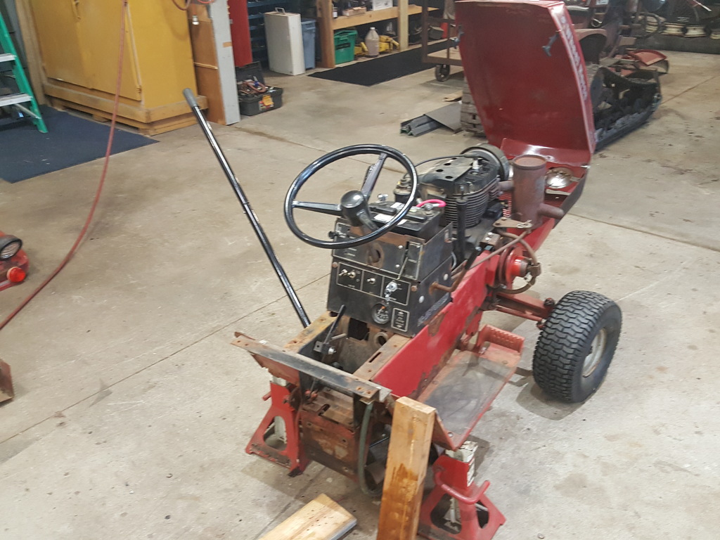

I don't plan to do anything with the pto, I purchased this for $50 and it will be a mud runner. I'm currently replacing the axle bearings so its a bit in pieces right now, but I'm locking the rear diff and will hopefully be back to running within the next week as I have spare time.

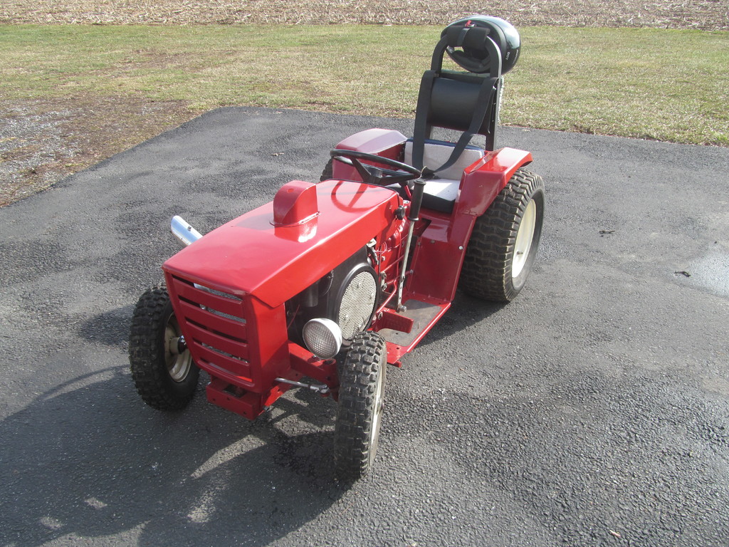

If you want to go fast, build one of these.
This is sorta my hybrid worker/racer on a budget.
