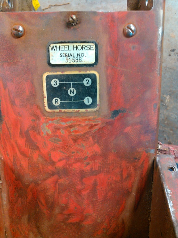

How can I protect this from the sand blaster??? Just be careful and don't hit it?
write serial down and then order new decals
  • Like 1
My sandblaster uses  several layers of duct tape on decals to protect and preserve them.    It works
  • Like 1

You need to check if the serial number decal is beige color or a brushed aluminum. Wheel Horse used both on the 701.
