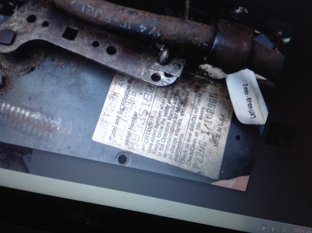

the pic tells it all.
the sears engine is a 10896 B ( information from the bottom of the tag )
the WH is 10540 B
both have the 45 BB crank. ( 1 1/8" X 2.74" usable length )
