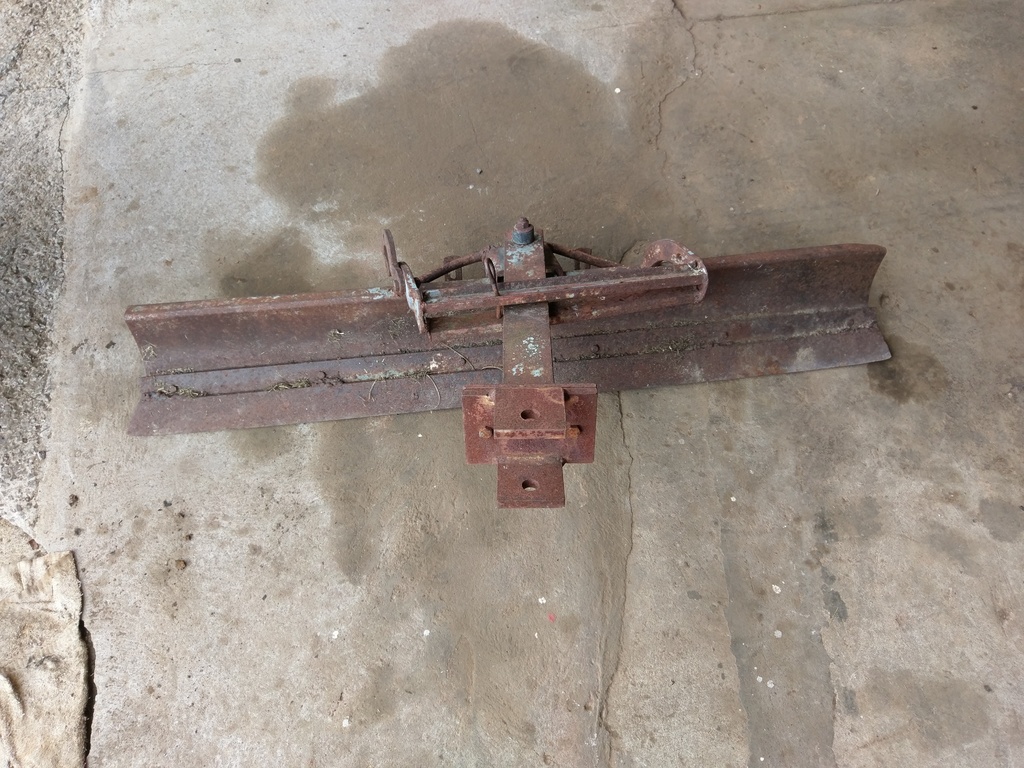

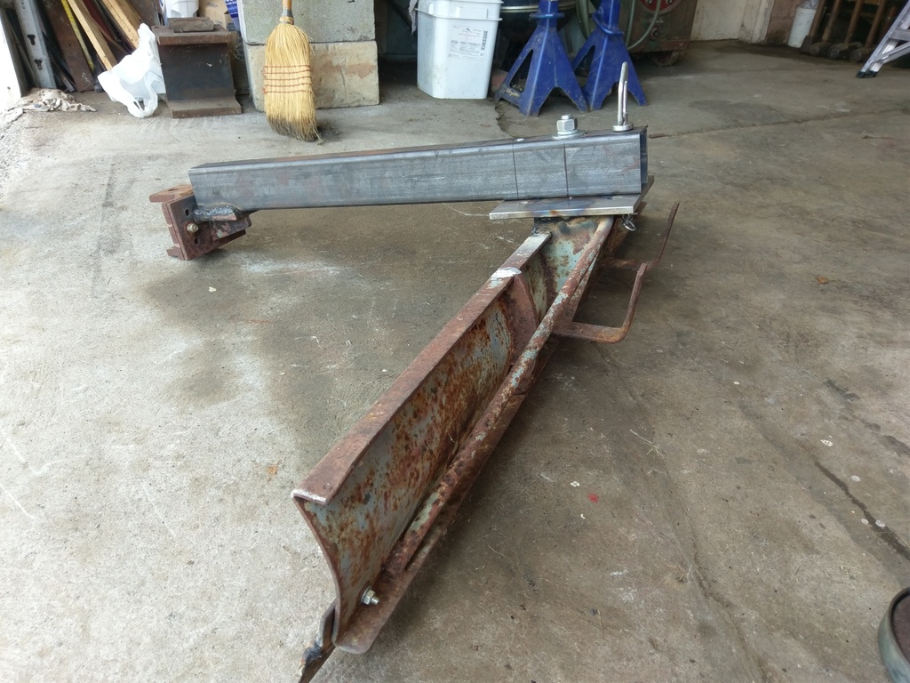

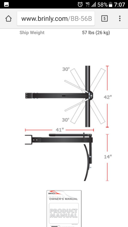

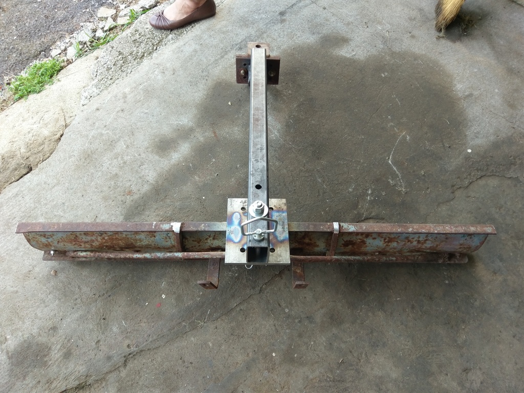

WVHillbilly520H 10,369 #2 Posted July 23, 2017 Here's the one dad built 30+/- years ago and I just fixed a couple months ago, if you're interested in this style I'll you some measurements, it's basically a "copy" of the Brinly rear blade buy probably heavier duty, last pics was how dad originally built it before running it over with my Kioti last winter, Jeff. 4 Share this post Link to post Share on other sites
littleredrider 408 #3 Posted July 23, 2017 It gave me some ideas!!! One thing I couldn't picture was the mount for the blade. Since it's not the same a snow plow the mounts and bracing is little different. But I like the idea on yours... 1 Share this post Link to post Share on other sites

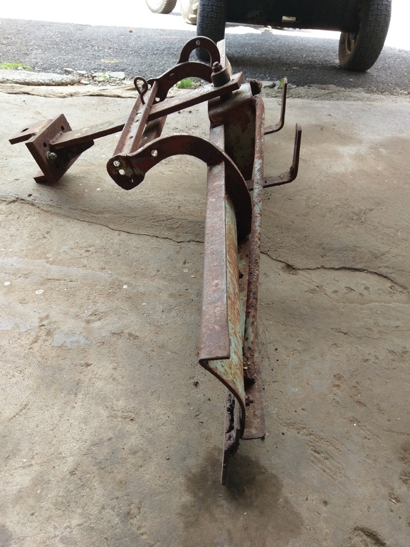

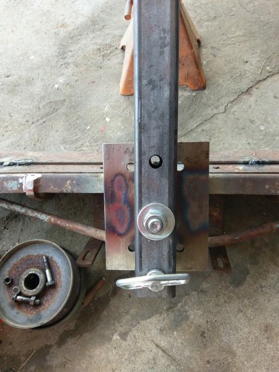

Lee1977 6,178 #6 Posted July 23, 2017 (edited) Here is one I built a few years ago. I cut a 5' road grader blade down to 4'. The pivot pin is a 7/8" king pin from a Ford truck. The frame is 2" channel with a short piece of 4" channel between. A 2"x2"x1/4" angle attaches to the blade. Edited July 23, 2017 by Lee1977 2 Share this post Link to post Share on other sites
WVHillbilly520H 10,369 #7 Posted July 23, 2017 If you zoom in on the clevis hitch in the second pic in my above post you'll notice there are extra holes drilled , they are for tilting like a road grader to pull side ditches, a little something extra the mid mount and front blade can't do plus the 2 pieces of flat iron on the back are for adding weight such as a cinder block ect, if you don't have the rear clevis hitch I'm sure it could be fabbed to hitch into the dozer/tiller hitch but you would still need the rock shaft and lift cable to raise and lower, I'll try to get a pic of it mounted to the 520, Jeff. Share this post Link to post Share on other sites

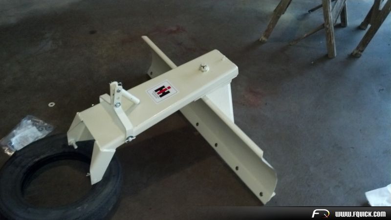

WVHillbilly520H 10,369 #9 Posted July 25, 2017 Here's the Cub Cadet style which is a rare find, Jeff. Share this post Link to post Share on other sites
