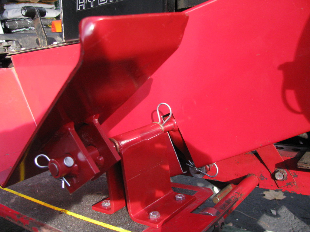

Bill D 1,599 #1 Posted July 20, 2017 Hi, Does anyone have any good, detailed pics they could share of the Original Wheel Horse Hydro Foot Pedal Kit? I would like to build one for my 416H. Thanks. Bill Share this post Link to post Share on other sites

AMC RULES 36,945 #3 Posted July 20, 2017 (edited) WH #8-3900 Edited July 20, 2017 by AMC RULES 4 Share this post Link to post Share on other sites

Bill D 1,599 #6 Posted July 20, 2017 (edited) Hi, Thanks for the picture AMC Rules. That is exactly what I am looking for. Do you have any other photos. Thanks. Bill Edited July 21, 2017 by Bill D Share this post Link to post Share on other sites
AMC RULES 36,945 #7 Posted July 20, 2017 3 hours ago, ACman said: @AMC RULES does that work the hand control or eliminate it ? Either, or both Jeffery... I chose to leave my factory control, (between the legs on my '88 model 520) hooked up, and functioning still. 2 Share this post Link to post Share on other sites
