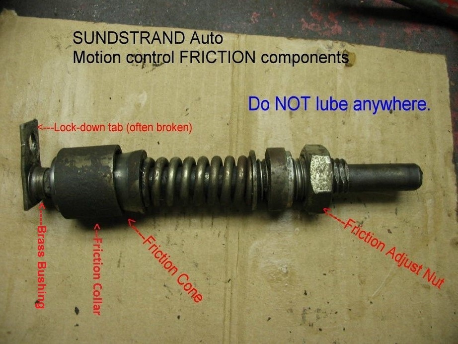

Is there a way to lubricate the rod that holds the FRICITON COLLAR ASSEMBLY so the rod does not seize?
daveoman1966
no.  It should not need lube of any sort.  The only friction point is between the friction collar and cone....
The moving parts are the cone, spring, tube, collar, and locking nut.  The shaft DOES NOT turn at all.
Just keep the tunnel cover on to preclude dirt /oil contaminates.

Chuck14025
This may be a very dumb question but, what causes the unit to seize?
daveoman1966

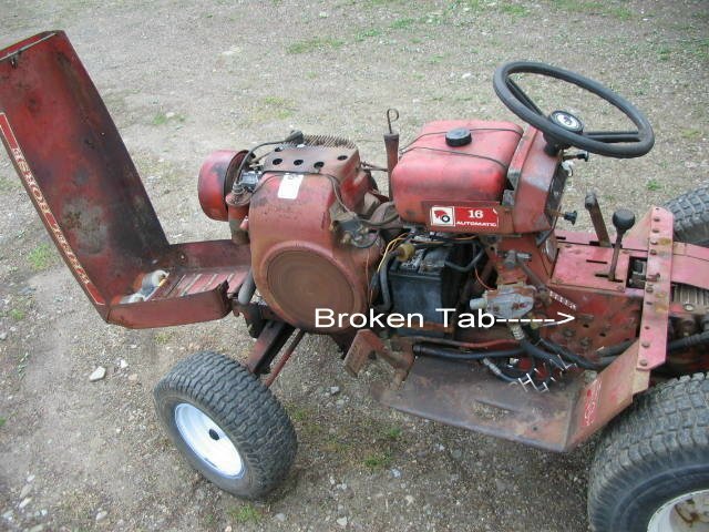

In my world, there are no dumb questions.  Why it would seize, I have only a dumb answer.....unknown.  Maybe from just sitting for a long time.  I do know that, if it is seized REAL TIGHT, you could break the TAB weld on the left side of the hoodstand that keep the shaft from turning.  Look at this pic.

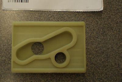

BOB ELLISON
Could it be from the cam follower.  Part 5995, mine had old hard grease on it
Chuck14025
C120
The tab on my rod is ok. The plastic cam follower had a lot of grease on it. Once I had it cleaned up I could see that the CAM BLOCK PIN was hitting the CAM FOLLOWER ARM probably caused by damage to the vertical plate at the end of the rear of the tractor frame. Damage to the 'plate' causes the entire transmission unit to 'tilt', forcing the CAM FOLLOWER ARM forward causing the CAM BLOCK PIN to catch on it - thus, no reverse gear.
Thanks for your help.

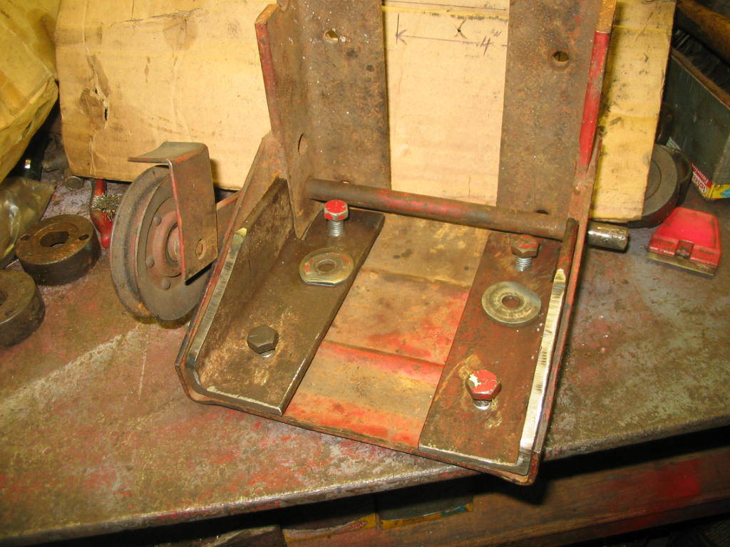

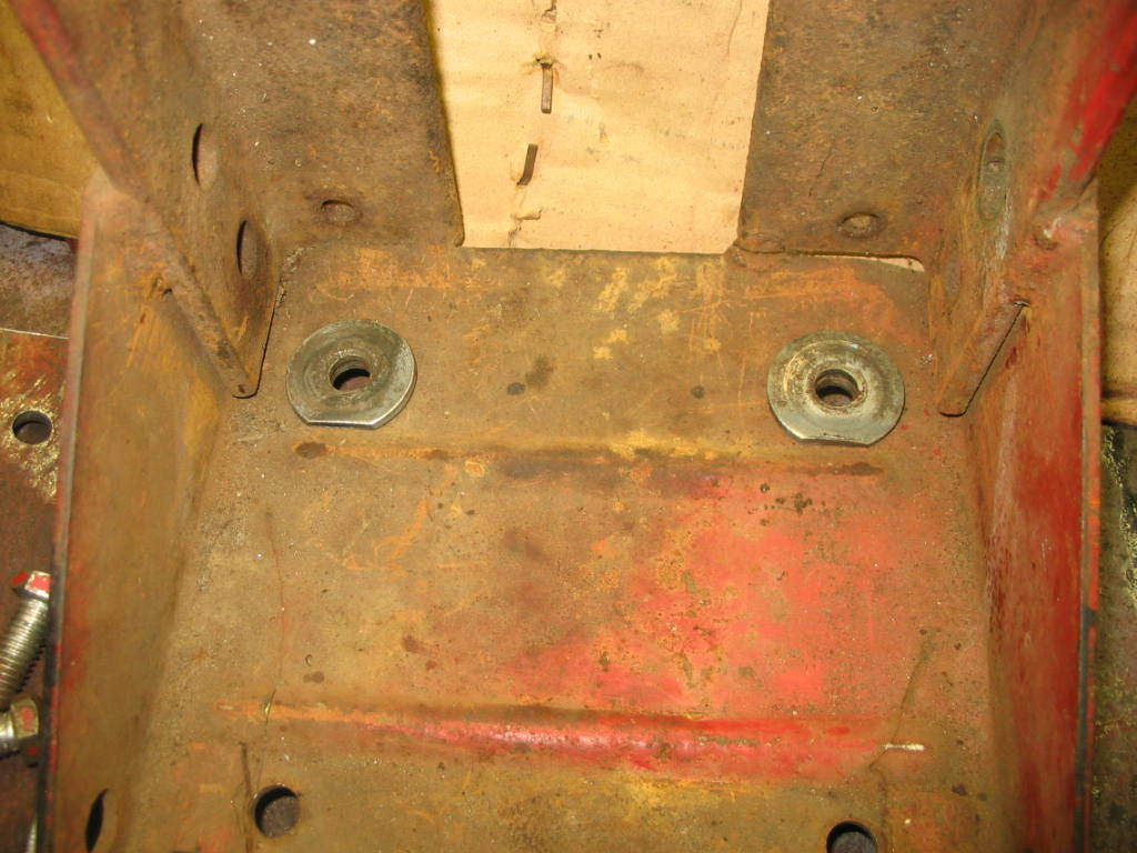

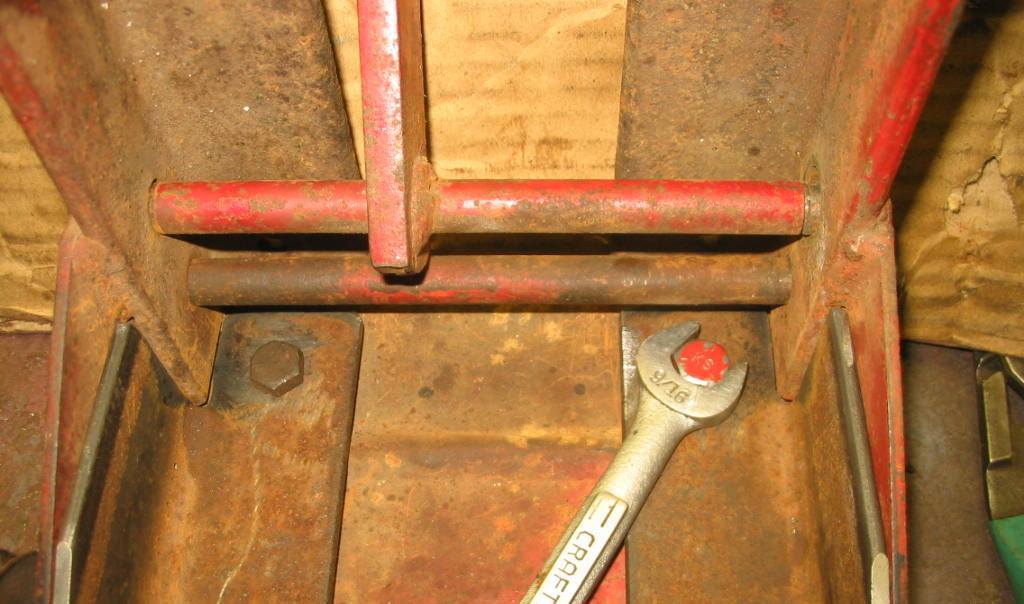

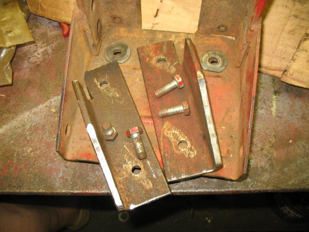

daveoman1966
I'm ready to send parts to you.....  soon as the m.o. arrives.

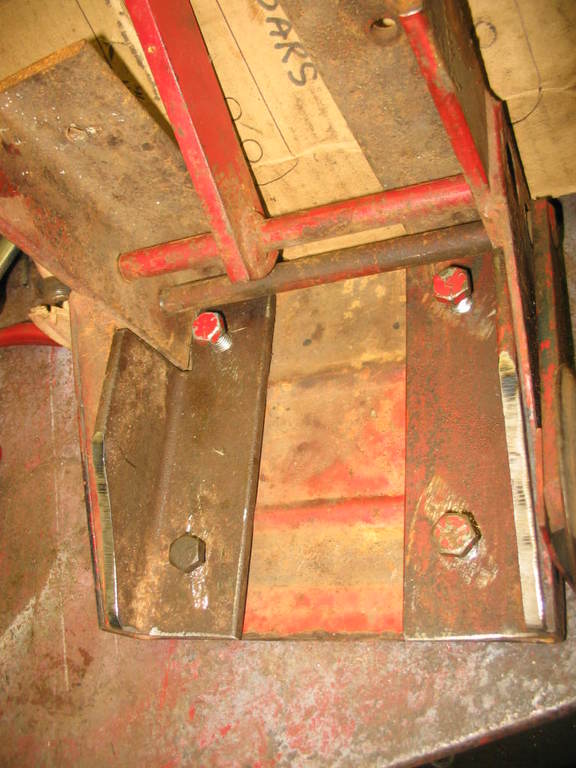

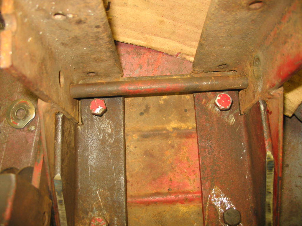

Couple pics...   I state that you'd need longer bolts...get some that are 3/8 to 1/2 inch longer.
The washer you see are for spacers behind the angle iron....
Chuck14025
Dave,
Your photos are excellent. Very helpful. Very encouraging. Going to rain here today and tomorrow so I can't even get the tractor apart until Tuesday.

i HAVE finally made time to install the brackets but now I can't get the friction control arm to line up with the hole in the right side of the frame. I suspect the transmission might be tilted to far toward the front of the tractor preventing the cam pin from fitting into the nylon cam. Would additional washers/spacers in the top two bolts of the vertical plate correct this problem? Also, I remember seeing photos about jacking or blocking the transmission during the install process but can't find the photos.   Chuck
daveoman1966

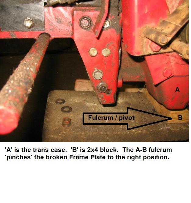

You should NOT have to add washers or such to make the parts of the shift arm line up.  I've seen this before.  When the frame plate breaks, the  whole tractor 'SAGS' right at the frame plate/trans bolt connection.  The thing to do is jack up the rear end of the tractor, then let it settle down on the FRONT EDGE of the trans case to 'pinch' the frame plate back  iton position, letting the weight of the tractor do that....as a fulcrum point.  This is real tough to explain.  Maybe this pic will help.
Once yuou have that in position, then mount the ANGLE IRON repair kit I sent you.

I got it working by putting shims between the vertical frame member and the transmission to give clearance for the cam pin; that worked. The braces you made are unbeatable. Now I have to figure out how to adjust the friction lever.
