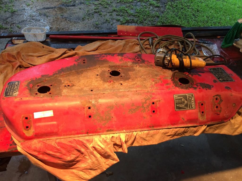

 I refurbished my 1985  Side Discharge Deck model j05-42MS04. And my son started mowing with it this summer on the 312-8. I've read many threads about these WH decks mowing low but were Texas newbies when it comes to mowing with them

I need a picture of the finished deck but you can see from these pics I completely disassembled the deck, replaced all bearing and sliders etc. Took it to bare metal. Did some straightening And repainted it.

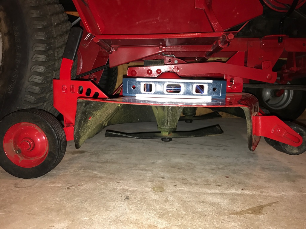

I stopped by my sons house and tried a little more deck adjusting.  Adjusting the trunnion acted like what @Racinbob said. But with the deck in the highest hole we have 2-1/2" blade clearance. The trunnion rod is adjusted so the nut is about 3/4" from the lower eng so you might say the rod is in close to its longest length The rear wheels are 6" which is correct per the parts list. I also checked tha the mule drive belt wasn't to tight
I,m missing 1" of height
Here's a pic of deck sitting down
Here a pic of deck in down position. It is almost level front is down 1/8" on 6" level.
Measure from the floor up to the end of the blade when it is front.  Rotate the blade so that you can measure the same end at the rear.  This will eliminate any error in the blade or deck.  Adjust so that you have 1/8" lower in front, less than 1/8" will give you more cutting height but will require a bit more power.
