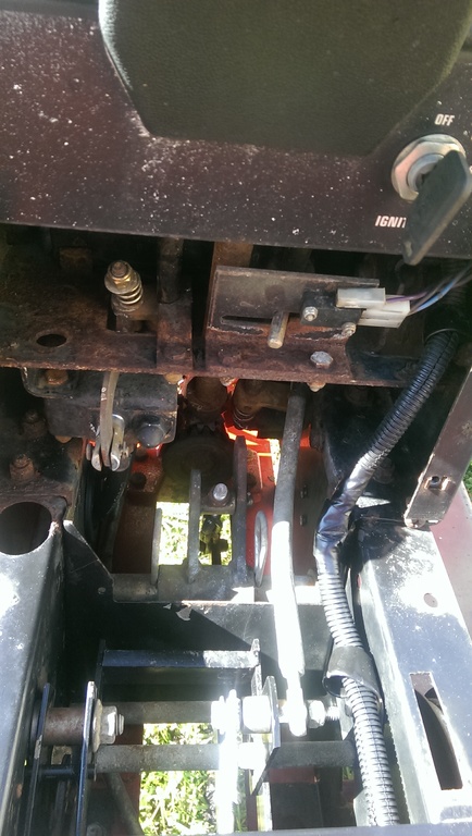

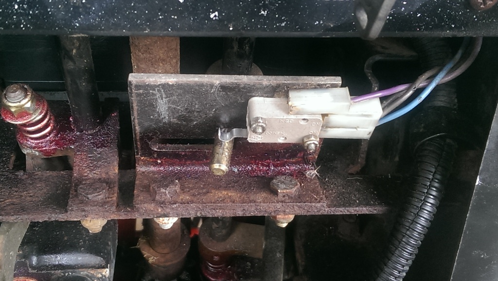

The '95 I bought last spring had a jumper wire from the ignition switch to the starter removing it was a no start/turn over, after going over the harness twice if not more and wiring around the dreaded 9 pin molex to find the neutral safety switch under the dash was "good" (top pic) but had a broken actuator (replaced 2cd pic) and now the PTO switch is starting to act up,  the battery acid gets to corroding those microswitches and actuators so be sure to check all these and use dielectric grease after cleaning and tightening  connections, Jeff.

Take a jumper wire from the battery + terminal directly to the solenoid, if it engages then the starter is ok but make sure the safety switches still have their actuators attached like my above post, it took me 3 weeks to figure out it was missing even looking right at it and testing with multi-meter, Jeff.

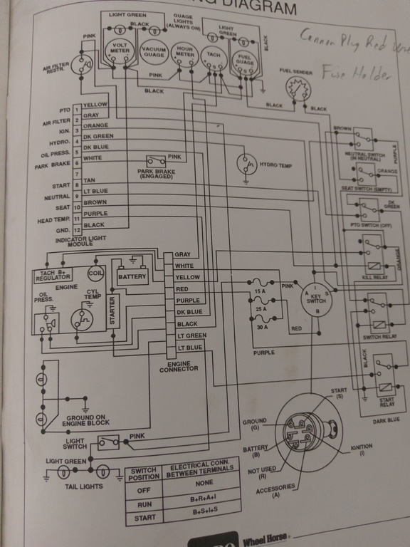

The light blue wire as in my pics above go to the neutral safety switch and starter relay, the dark blue is oil pressure, according to the 1995 manual Jeff.
