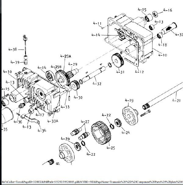

Can anybody help with a bearing kit for asundstran hydro trans tag # 90.  1137 on a d180
What bearings are you looking for the pump, the ones in the hydro motor or the ones in the transaxle?  Found your other posting which bearings are you looking for?
Edited by pfrederi
The tag # 1137 is what is normally on the transaxle.
You can get 1532 from Toro for $29 each or go to a bearing supply house and pay about $6 for CR/SKF    Koyo #M16121
Be careful not to mess up 4-18... I never found anyone who had that one.

Hi everyone, im looking for bearing 4-14 in the diagram above, part number 8048. Any ideas on were to find them
Welcome to red square.  if what you want is the just the needle bearing 2-1/8 x 2-1/2 x 1/2 it is Koyo B-348
Thank you pfrederi, i just relized this thread is about a d 180, i have a d 160, same bearings or different? My parts book says 2 ID for bearings 8048.
Same bearings.  there was I believe and additional race used with the 8048.  Search here for 8048 it was used for a while when the normal bearing was unavailable.
How about the part number 93712, axle woodruff key for the wheel hub. Tried locale toro dealer. They say discontinued. Tried Menards in specialty nuts and bolts section, all were to small, i believe it is 2" long 1/4" thick.
