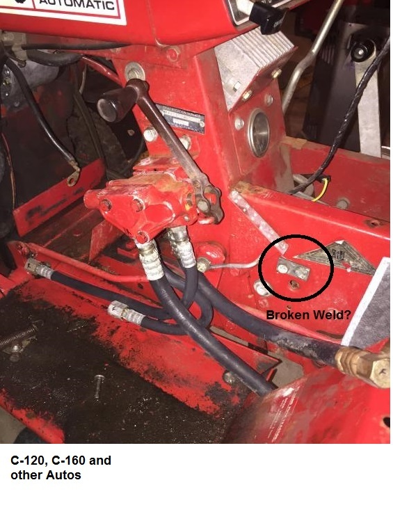

You MAY also have a problem here....pretty common.

I don't find a broken weld, everything is intact, but I can't see the " cam support socket head cap screws " yet.

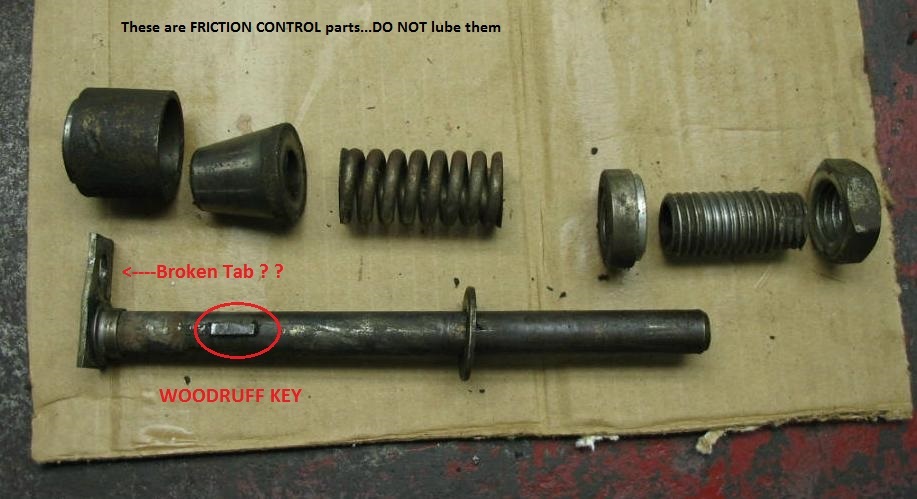

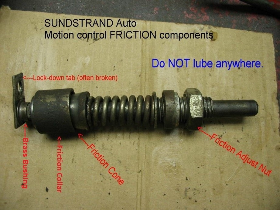

I ahve to add another pic of the frictioin control mechanism....  watch the little WOODRUFF key when taking this stuff apart.  You need to remove the woodruff key BEFORE taking out the shaft.

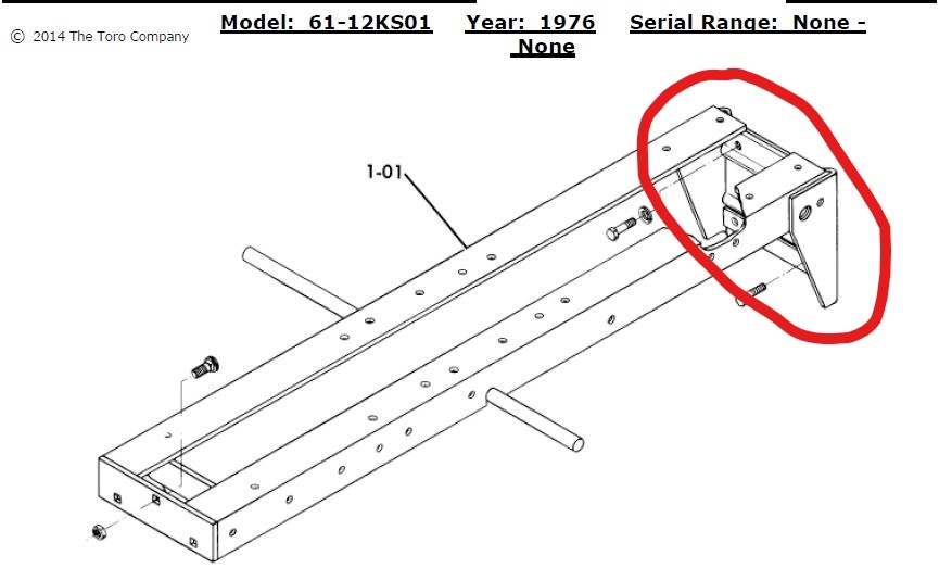

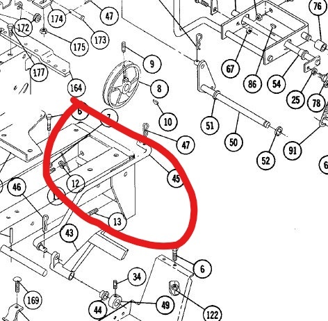

Look very closely at the rear plate under the rear of the frame where the transmission is bolted to it - probably cracked/broken from hard work/abuse . It's a common thing with these frames and the C's had braces to help with this , but if they are pushed hard enough or rammed into solid objects that plate can give up . What happens next is it usually loses most of the travel on the friction cam plastic section , so you lose forward travel speed and if bad enough you'll lose reverse ability altogether due to the transmission being tipped at an angle . I've re-worked the rear plate in the 1277 twice already , now the plate is shattered and done - have to cut it off and make a whole new one along with more bracing - yes, I work that tractor that hard . Loaded rear tires w/weights and chains will do some damage if pushed , lol - but I have the ability to repair/rebuild it so it's no big deal here ...
With the rear fender pan removed , it's easier to see the transmission mounting plate and rear of the frame - also it's not too hard to remove the trans once the frame is supported with jack stands - the only trick being to keep it from tipping off a garage jack since it's so nose heavy due to the pump and shape of the trans case . I usually leave the rear tires on them and just roll the whole thing back , access and repair the damaged frame , then reassemble it and go back to work .

I have a 1975 Parts Manual. I can't find the 'plate' you refer to. Can you give me more specific direction on its location?
Is there a way to lubricate the rod that holds the FRICTION COLLAR assembly to prevent it from seizing?

The plate he is talking about is the rear end of the frame has 4 bolts that go through it into the tranny

Is the plate the actual frame or a separate piece? Is it vertical or horizontal? And, if you would, where can I find a copy of the parts diagram you posted?

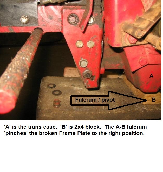

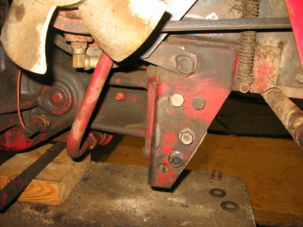

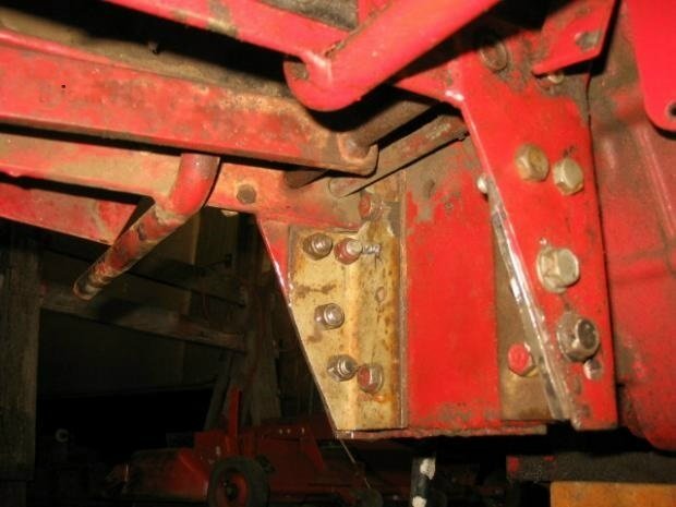

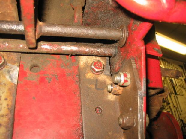

Here is the method I use to repair the cracks in the FRAME PLATE, using two 1/4" or 5/16 Angle Iron measured 2x2x6 .  These get bolted to the SIDE of the plate and the the base of it....where the orginal 4 trans bolts are.   If you just bolt a thick plate onto the back of the crqacked frame plkate, it will LIKELY just crack again at the corners / sides.  This method precludes that event and reinforces the corners.
Just work on one side at a time  to avoid collamity.   Just find 4 bolts about 1/4 or 5/16 longer than original...but not too long.  The 8 side bolts are 3/8 with Nylok nuts on them.

For the benefit of the next 'newbie' who encounters the same problem, the plate is 'vertical', attached to the rear end of the main frame.
OK Dave, excellent photos, excellent solution. How soon can you have custom angle iron ready for my C-120? I'm only half joking. You make 'em, I'll buy 'em.
I hope you saved a pattern. I'd bet you could sell several of these -- getting paid well for your time and materials.
Am I reading it right that they could be installed one at a time on each side without pulling the whole transmission away from the frame?
I'm only 2 hours north of you so I could pick mine up tomorrow --- don't want to rush you or anything.  Bet you could be a hero to several guys in the same predicament I'm in.
