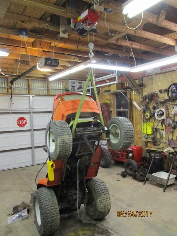

N3PUY 1,031 #5 Posted July 3, 2017 This is my favorite way to jack up any tractor ... 6 Share this post Link to post Share on other sites
Jerry77 1,218 #6 Posted July 4, 2017 2 hours ago, N3PUY said: This is my favorite way to jack up any tractor Me too, except I'm a big chicken - I always throw an extra chain over the jib and secure it for safety - saw one fall one time....scary... Share this post Link to post Share on other sites
