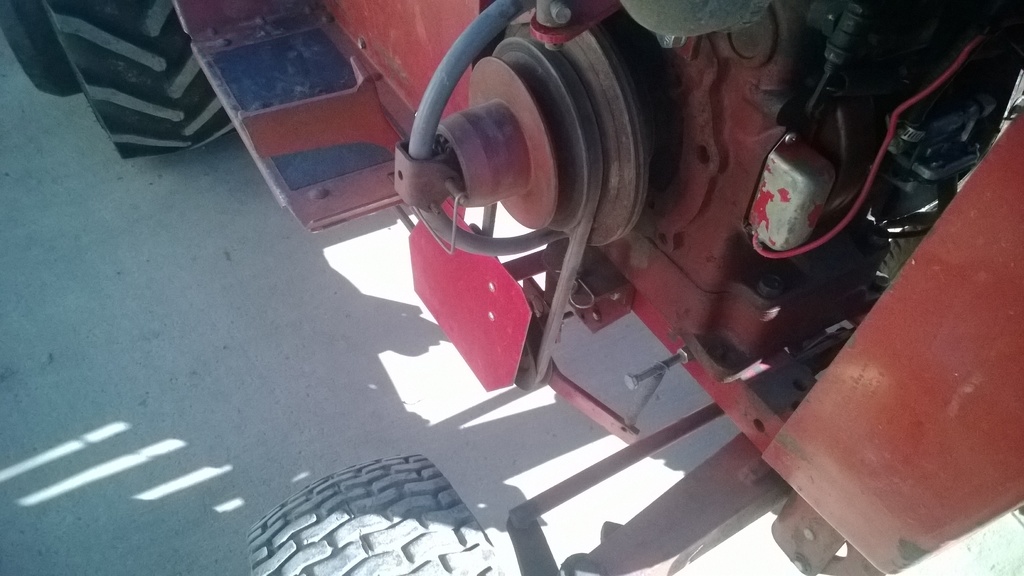

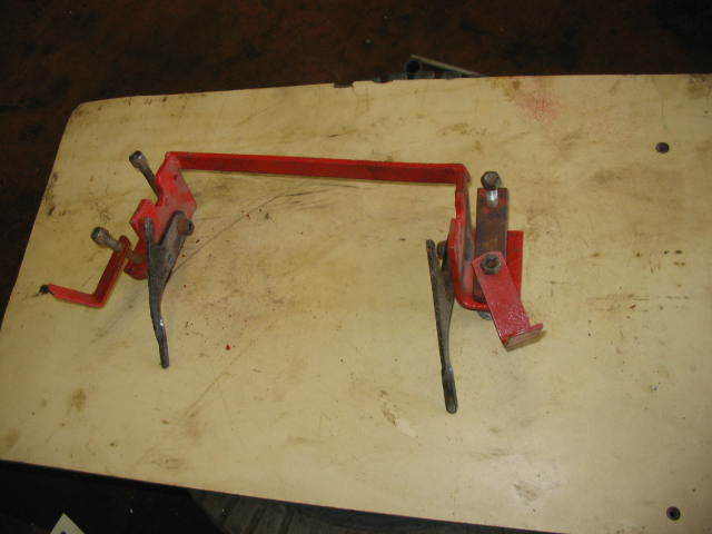

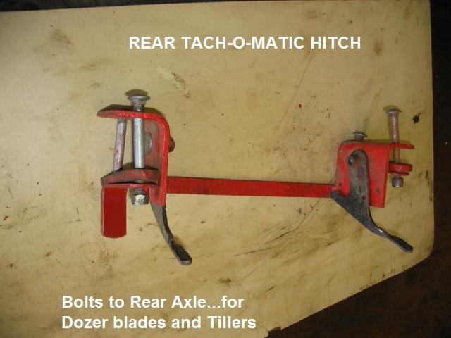

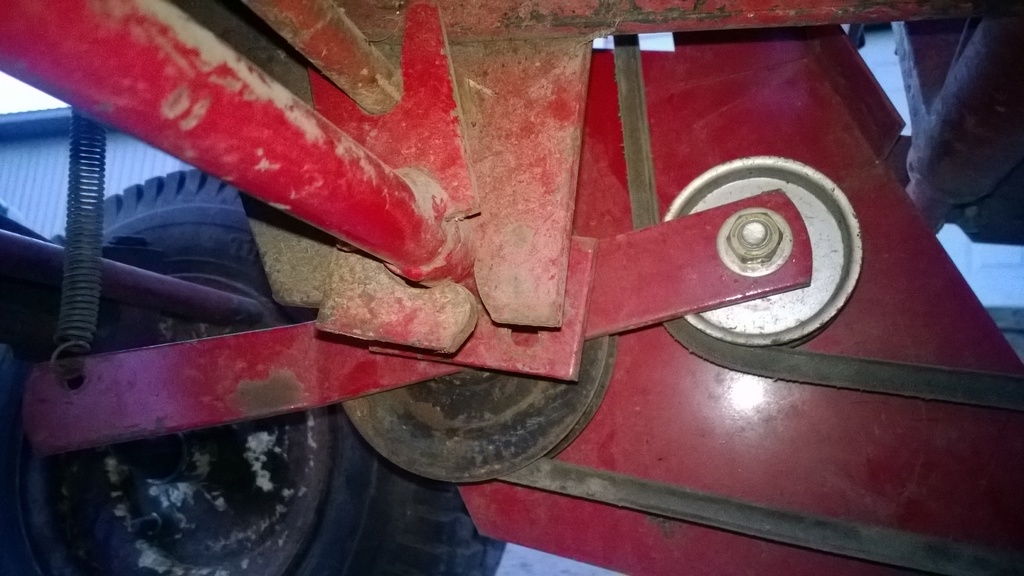

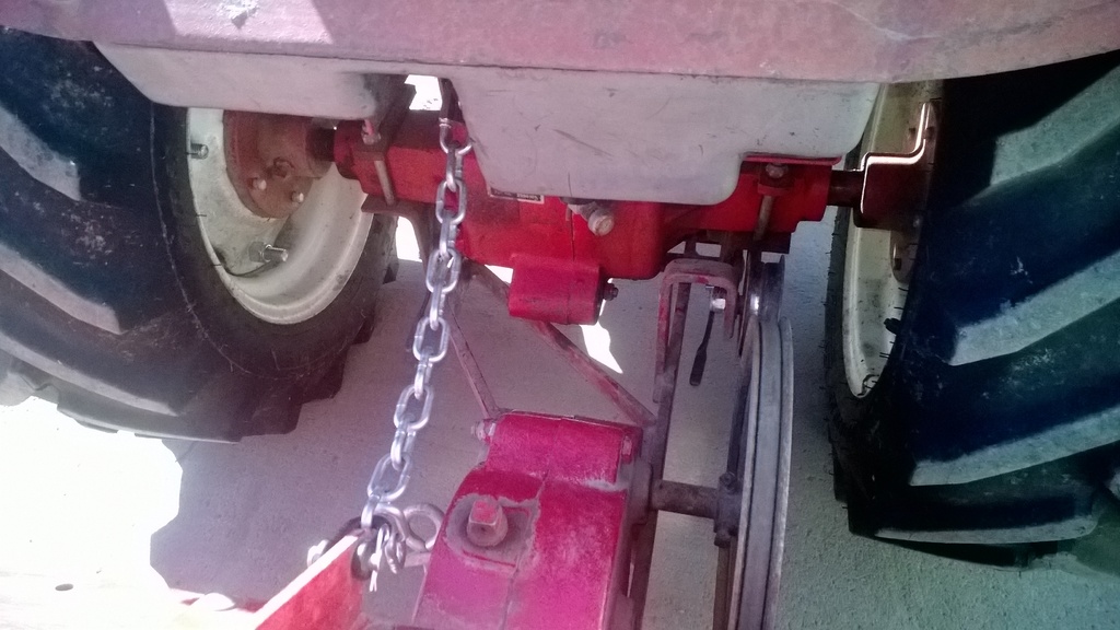

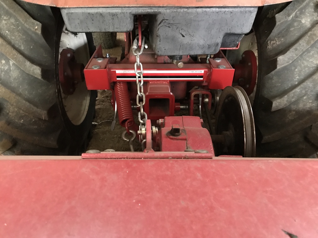

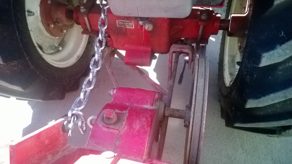

wheelhorseman 3,197 #4 Posted June 30, 2017 (edited) 35 minutes ago, Apprentice said: My question is do I need a bracket/ hitch to attach a rotortiller to the machine. Pardon me if I'm posting this in wrong place, I'm new to forums. Yes you do, here are some pictures to help you. Edited June 30, 2017 by wheelhorseman 3 Share this post Link to post Share on other sites

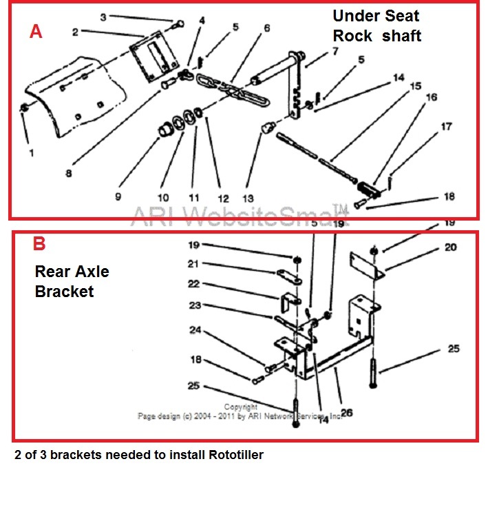

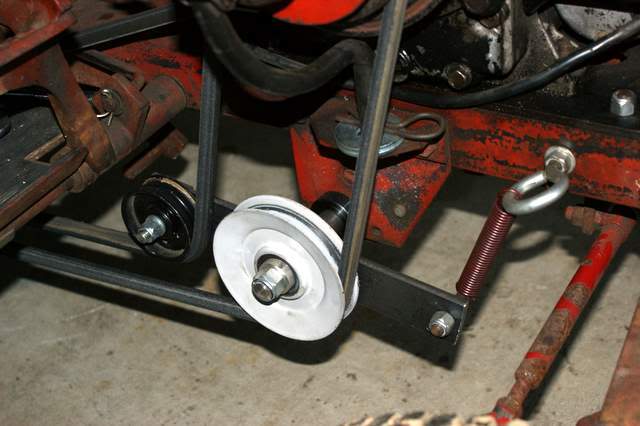

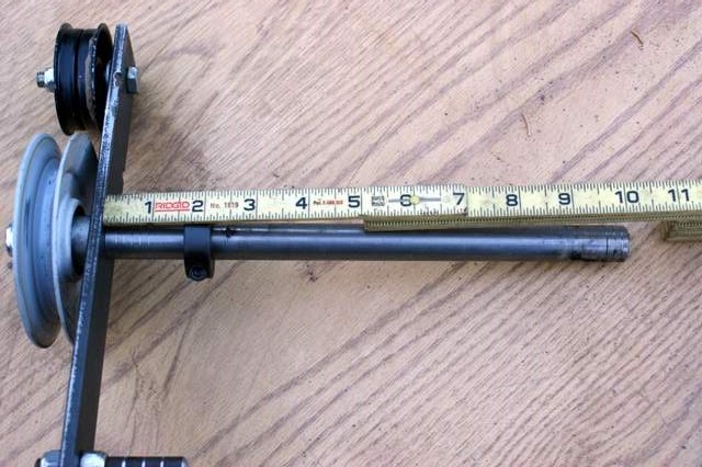

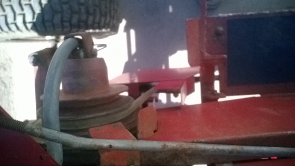

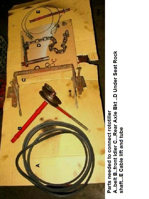

daveoman1966 3,586 #8 Posted July 1, 2017 (edited) You will need, essentially, FIVE items to hook rototiller to your 312 tractor. 1) Rear axle bracket 2) front idler pulleys/spring 3) Under-seat Rock shaft and 4) Cable / chain link 5) drive belt (110265 probably). I have the rear axle bracket and provide SOME of the other pasrts to ship to the UK. Here are a few 'starter' pics and from them, you MAY be able to get a clearer picture of what is needed. Edited July 1, 2017 by daveoman1966 1 Share this post Link to post Share on other sites
