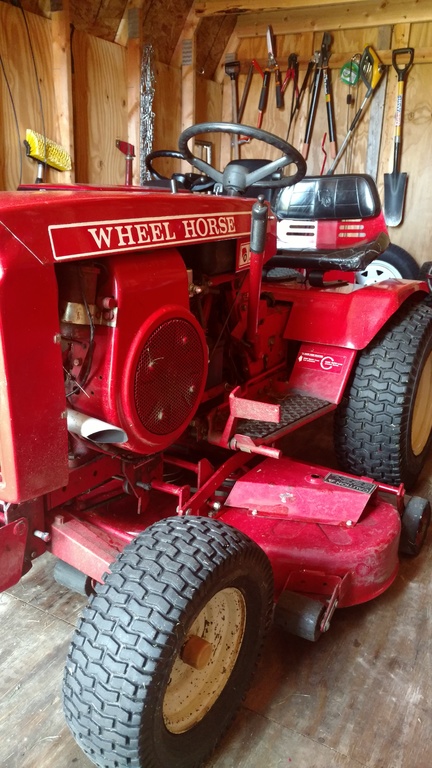

608KEB 794 #1 Posted June 24, 2017 My C120 is not charging. I switched batteries. Hoping that was the case. It's not. What should I test or look at next. Share this post Link to post Share on other sites
pfrederi 17,145 #2 Posted June 24, 2017 Check the voltage while running should be over 14v. Check eh regulator make sure it is well grounded to the tractor (run a jumper wire from eh regulator fins tot eh battery negative post. Still not getting 14volts. check stator output. find the connector in the three wire bundle that goes from the engine to dash area. Back probe the engines side of the connector on the 2 white wires. Set you meter to AC start it up and run at 2/3 throttle should show at least 30 Volts AC. If it does then the regulator is the issue Share this post Link to post Share on other sites
608KEB 794 #3 Posted June 27, 2017 Turns out the amp meter posts needed to be cleaned. I also made sure the regulator was grounded. No problems for now. I'll report back if I have problems again. Share this post Link to post Share on other sites
