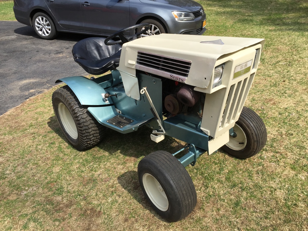

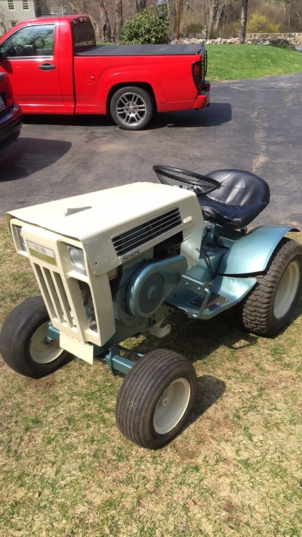

Rob R
Not A Wheel Horse but Whose Complaining
:text-coolphotos:     You don gooood!
JPWH
Nice job. Looks good.
12 hp Kohler
looks great !
Sparky
Well done!
  Mike....
elcamino/wheelhorse
You did a nice job on that. How long did it take to restore?
SylvanLakeWH
:bow-blue:
Rob R
2 pretty complete weeks just prior to winter surrendering to spring........
857 horse
I gave a SS12 to an old man,,he bought one new in 67,,,,,the is gonna be his last hurrah,,,,,,,,,,This machine looks fantastic,,,,,,,,,Great job !!!!!!
Terry M
Nothing wrong with that!!!  Very Nice Tractor:handgestures-thumbupright:
Digger 66
Very cool tractor .
Thanks for keeping it alive !
6bg6ga
You simply cannot fault someone for bringing something back from the dead. Its a great job. Well done.
DennisThornton
Great tractors!  Under appreciated I think.
ohiofarmer

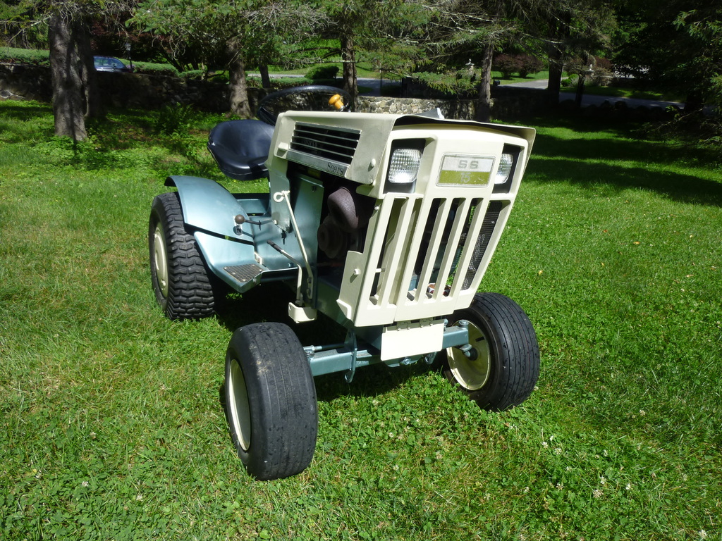

When I bought my house in 1986, I got the tractor the PO had, I eventually sunk $600 into an engine rebuild but found out later a short block would have been better. Even after that, the Teccy was gutless or perhaps the tractor wasted a bunch of power during transfer of power to the mower. I constantly had to tinker with the points and other issues. The guy who helped with messing about with the Sears became a lifelong friend, so that is much more important than how well the tractor worked out. I finally got tired of messing with it and bought a 416-8
 I am glad you have a big 15 HP thumper in yours--so much better than what I had
They are solid tractors, however and they weigh in about 600# Mine looked like this
 . https://www.google.com/search?q=sears+suburban&tbm=isch&tbo=u&source=univ&sa=X&ved=0ahUKEwjErZeNqszUAhWG6CYKHUCRD9cQsAQILg&biw=1170&bih=658#imgrc=e2AWcy4VWNAa1M:
Edited by ohiofarmer
Rob R

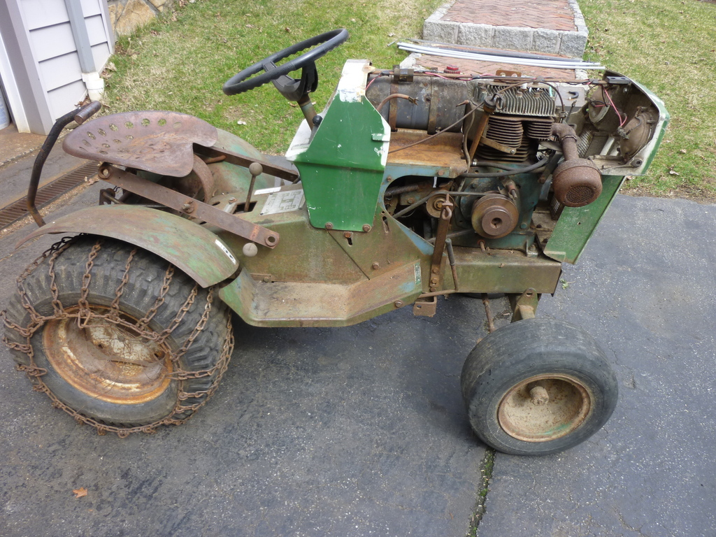

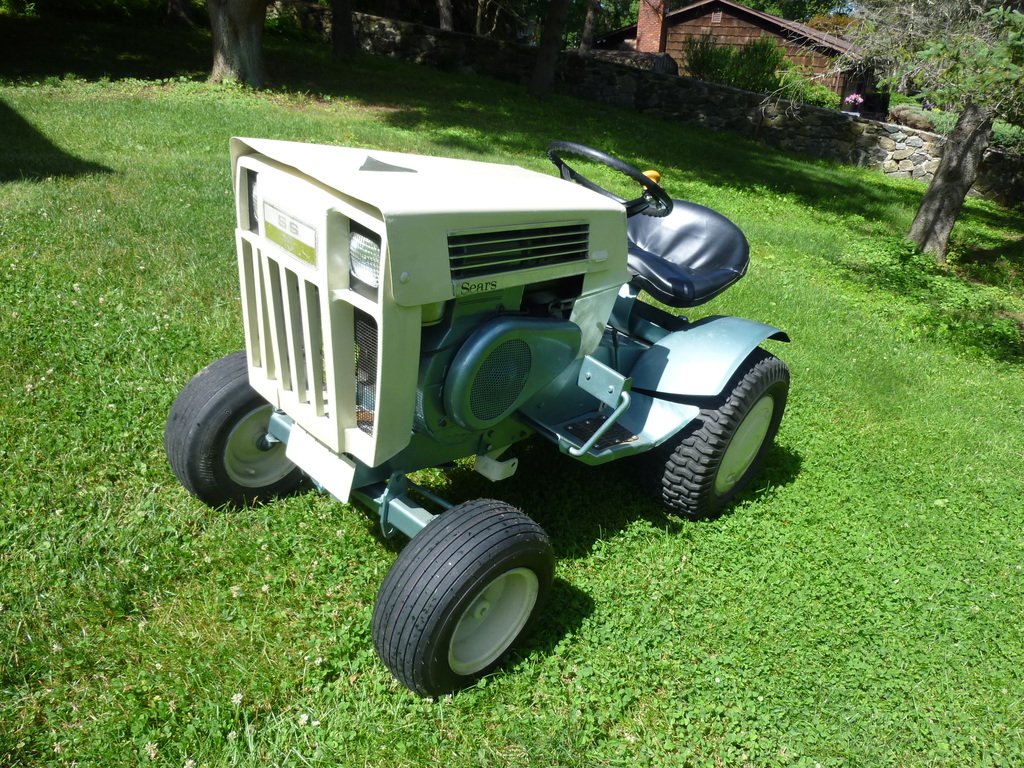

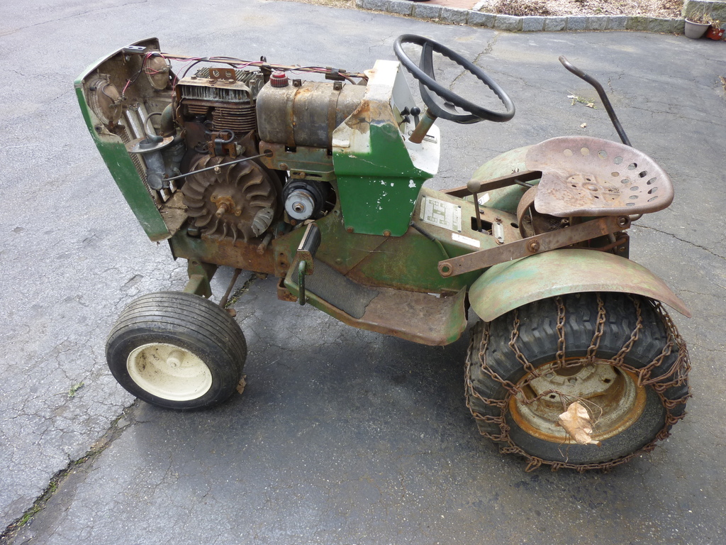

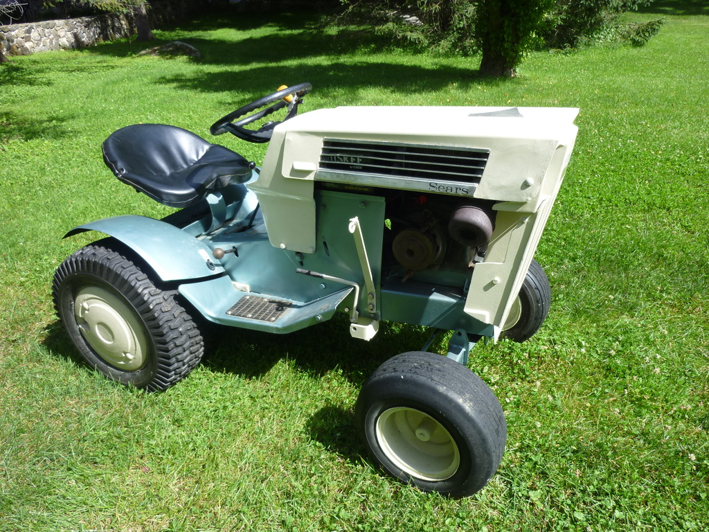

I am partial to the transmissions and scissors deck which are both "Bullet Proof" .... weak points were the carbs and ignition on the 120 Tecumsehs....  but as you can see I have a Honda transplant in the 12 and the ole B&S Thumper in the 15.   Will put either one against any tractor made .... and I love my C-81 and the Gt14.
Ken B
That came out real nice. What colors did you use for the paint? They look like a perfect match. I have had many of the SS Suburban tractors. I had a blue one like yours that was a MINT low hr machine. It had the 12hp Techy on it and it was anything but gutless, it ran perfect. I wish I still had that one. Like Dennis said, I would agree that these tractors are under appreciated. I always have an eye out for another one...
DennisThornton
From the not cast but heavy duty front axel to their durable 2 spd rears they meant business.  And the spring seat is the best ride I have!  I think they had as many attachments as Wheel Horse or even more.  I smile when I use one or see one but not because they look great.  I think when it comes to looks Wheel Horse wins big time.  But I still love 'em!
Rob R
Ken you and Dennis are right on......The original Suburban "blue" color you refer to is "Jade Mist" which is no longer available. The closest match I have ever found is the "Hammered" finish Rust-Oleum 712 Verde Green. I prefer the Rust-Oleum Gloss Almond to any "White" and this is what I use..... of course a good prep and clean is a must and I always to prime with a good "etching" primer prior to apply the aforementioned paint. My goal is have a durable "decent" machine which is put to work as soon as completed...... there are NO trailer queens here...........

Made one final change to complete this beast.....  I didn't have the stock "removable" side grille for this tractor and they are hard to come-by so..... I made a removable extension parted from an old broken grille I had in my stash. Think it came out workable.... leave to your discretion.....?   cheers
