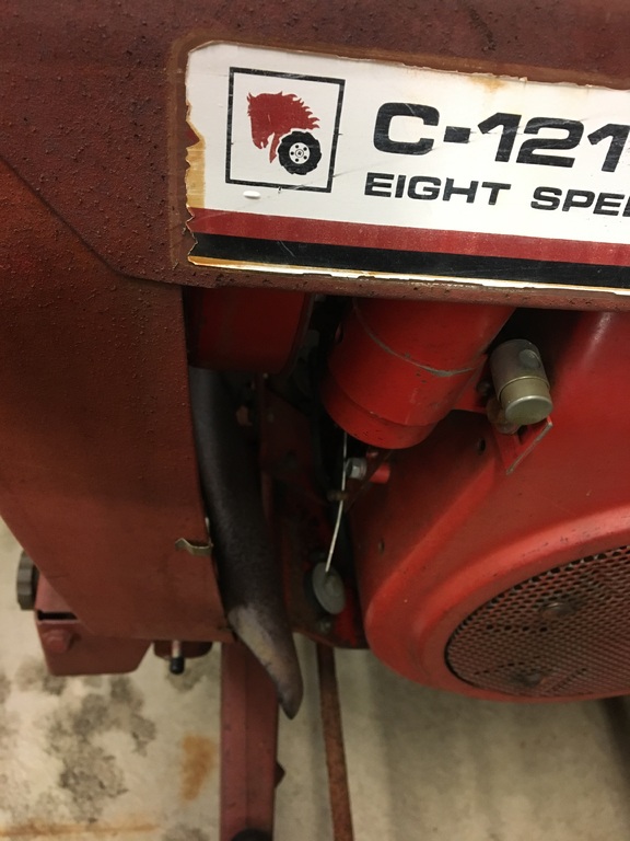

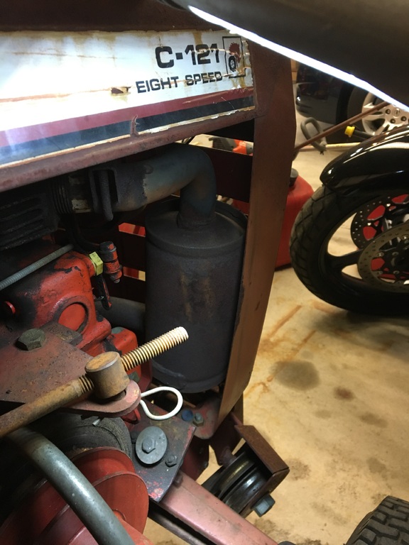

Sparky-(Admin) 19,286 #2 Posted June 14, 2017 It's a short frame right? I bet the 2" plus or minus is missing from the frame rails. On my C121 the pipe exits right up close to the hood and the muffler body itself is about 1/2" from the grill. Plus the tractor your using has that tapered in the front hood. My gut feeling is that you'll leave clearance issues. Mike... 1 Share this post Link to post Share on other sites

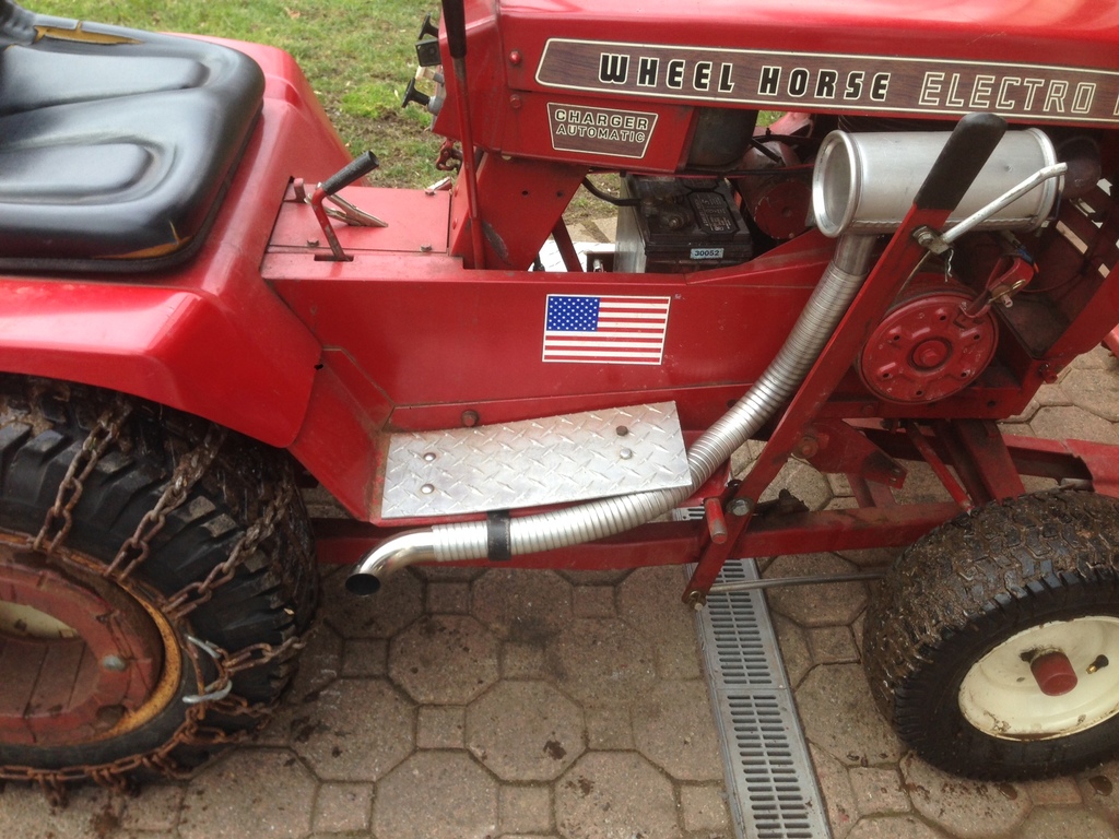

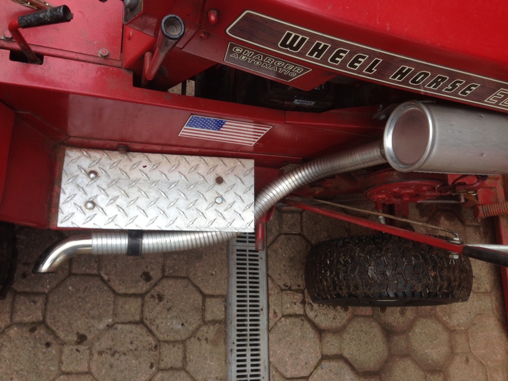

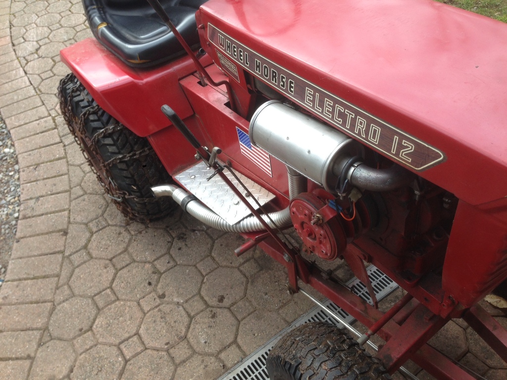

formariz 11,849 #11 Posted June 15, 2017 (edited) I never had a 1057 in front of me but it looks like it is basically the same as the Electro 12? If it is that muffler will not fit. I know that anything is possible but I attempted to do it on the Electro and It is just too tight, mainly because of the taper in the hood. I also attempted to fit the Jay Bee muffler in it which is skinnier and has the removable elbow making it more versatile and result was same. Too close to everything, hood, and fuel lines. I opted for the unorthodox way I have it now, or also the way Ken originally had it on was also good. Edited June 15, 2017 by formariz Share this post Link to post Share on other sites
stevebo-(Moderator) 8,034 #12 Posted June 15, 2017 2 hours ago, formariz said: I never had a 1057 in front of me but it looks like it is basically the same as the Electro 12? If it is that muffler will not fit. I know that anything is possible but I attempted to do it on the Electro and It is just too tight, mainly because of the taper in the hood. I also attempted to fit the Jay Bee muffler in it which is skinnier and has the removable elbow making it more versatile and result was same. Too close to everything, hood, and fuel lines. I opted for the unorthodox way I have it now, or also the way Ken originally had it on was also good. Any pictures? Share this post Link to post Share on other sites
formariz 11,849 #13 Posted June 15, 2017 Can't find my old post but here are photos of what I did. Not for everyone but for me the best muffler set up I had on it so far. Not wanting a stack to get caught under branches or stress the engine and not wanting fumes near my face I opted for this. 3 Share this post Link to post Share on other sites
