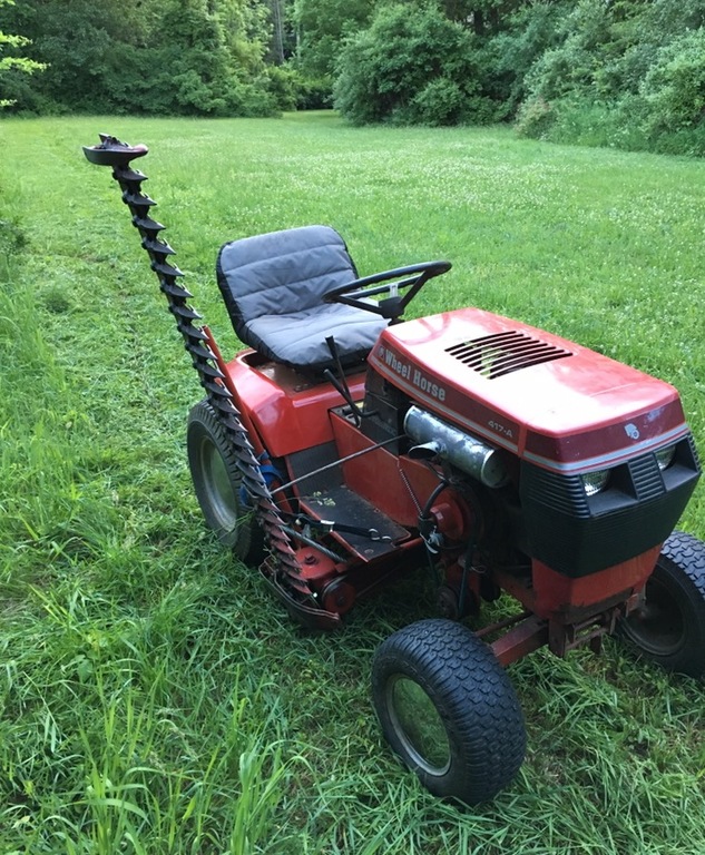

Fred Jimenez 24 #1 Posted June 14, 2017 Looking for the correct belt sizes for a SMS 42 sickle mower I plan to mount to a 417. These belts are the last thing I need to finish up getting it up and running so any input would be greatly appreciated. Share this post Link to post Share on other sites
gwest_ca-(File Mod) 10,441 #2 Posted June 14, 2017 The original belt sizes are on this page but don't know how the short frame to long frame conversion will affect the required belt lengths. The 50" bar for long frame tractors Garry 1 Share this post Link to post Share on other sites
gwest_ca-(File Mod) 10,441 #3 Posted June 15, 2017 Did some more checking. Looks like all the 42" sickles for short and long frame tractors use a 1/2" x 34" first drive belt The 50" sickles SMS-50 and SMS-505 on short frame tractors use a 1/2" x 37" first drive belt The 50" sickles on long frame tractors use 1/2" x 38" first drive belt The 2nd belt 1588 is used on all of them 1/2" x 59" Garry Share this post Link to post Share on other sites
Fred Jimenez 24 #4 Posted June 16, 2017 Thank you for your help I figured out the sizes and got it mounted up! Share this post Link to post Share on other sites
