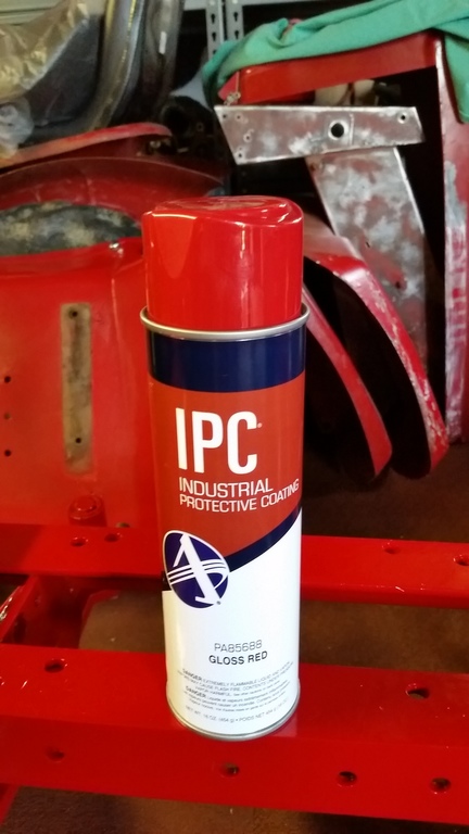

Tgtack 779 #1 Posted June 10, 2017 (edited) I may have found a much better alternative to any of the other spray can paints that everyone has been using. I had used it years ago, but forgot about it because I had only used black, white, and silver. While I was at my friends shop sandblasting this morning, I asked him if their spray paint came in bright red. He pulled out the color charts, and they make a myriad of shades of red. I brought home a can of gloss red to try, and while I have not used it yet, there were some tiny splatters on a can that looks to be very close. It is called IPC, Industrial Protective Coatings, manufactured by Applied Maintenance Supplies and Solutions in Cleveland Ohio. This stuff is extremely tough, they use it on propellers that they repair, boat stands, hoists etc., that they manufacture. It is also mirror glossy when applied. Will report back on how well it does. Edited June 10, 2017 by Tgtack 9 Share this post Link to post Share on other sites

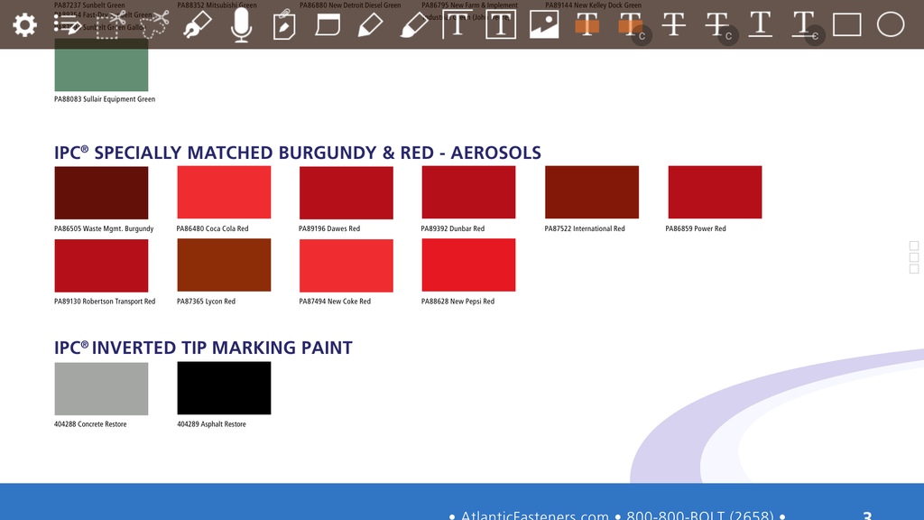

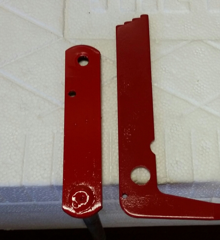

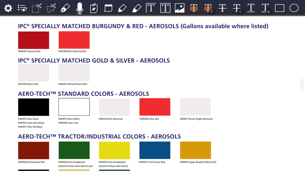

Tgtack 779 #8 Posted June 26, 2017 (edited) I wanted to update the thread, I sprayed a test piece, and it has more of an orange tint than Sunrise Red. I will let you be the judge of the color. This was the IPC standard Gloss Red on the left, RO Sunrise Red on the right. As far as color charts, here are two pages showing color matche'd reds and standard colors I am thinking of getting a can of the "Power Red" to try. I love the way this paint sprays and it has a very high gloss, plus it is tough as nails. Just need to find the correct shade. Edited June 26, 2017 by Tgtack Share this post Link to post Share on other sites
