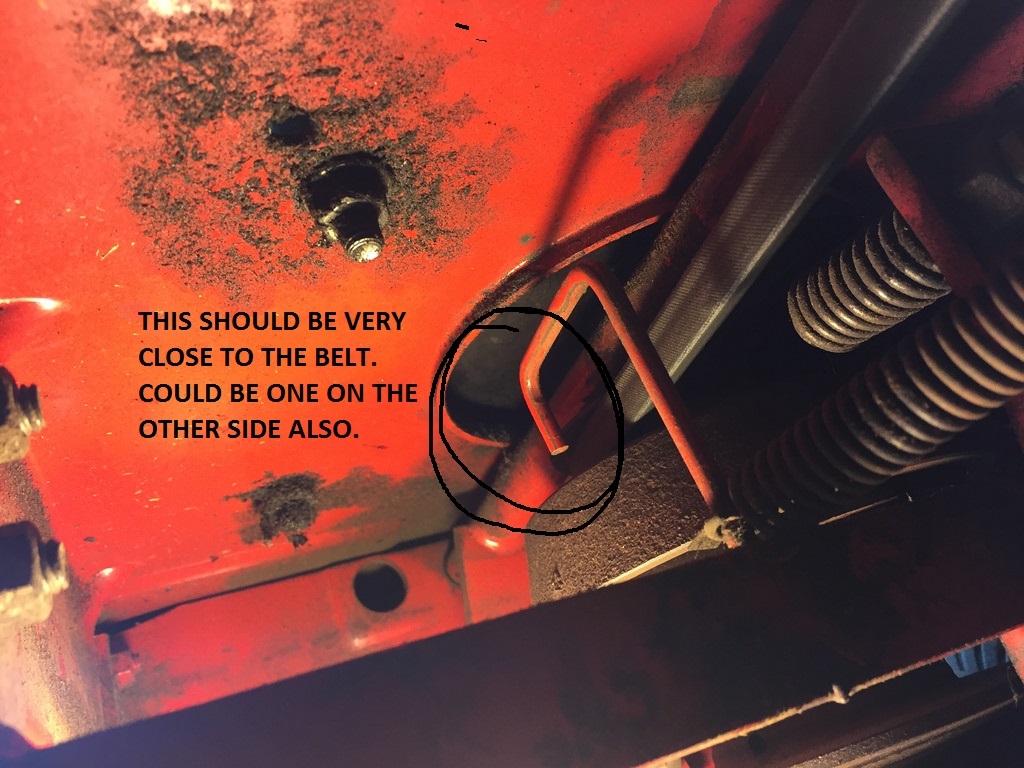

mikeeyre74
Belt and pulley
Belt and pulley
Belt and pulley
 I know these pictures are horrible, because I'm upside down underneath the tractor trying to take them, but I see the guides that I think you are talking about, but all they do is keep the belt from falling off, there is nothing to pull the belt away from the engine?
N3PUY
which is the clutch pulley?
AND...
mikeeyre74
Whoa! That was it!
 Well, that and one other thing… I guess there was a technical service bulletin and a retrofit kit for these things? It looks like they moved the pulley over about an inch and a half or so by putting it on a bracket which is bolted to the bottom of one of the engine mounting bolts.   Essentially , this acts as a swiveling idler pulley.  It's adjustable.  After moving it to a different position, everything works as it should!  But I never would've known this if I hadn't crawl back under to make the adjustment on those belt guide "fingers".  Thanks guys!
