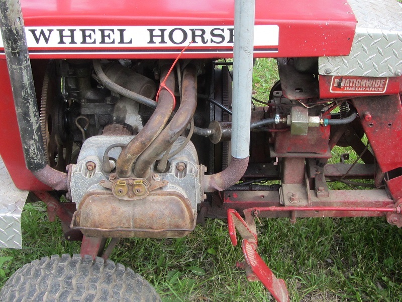

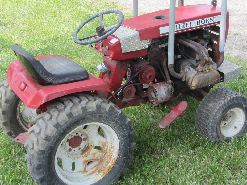

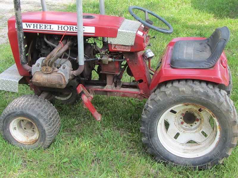

I don't anything about VW air cooled engines , does that thing have 2 flywheels? One on each end. It would keep your legs warm.
The one on the front appears to be a "Flex Plate" like you would find on an engine equipped with a torque converter and automatic transmission. Not sure what it is there fore.    :confusion-confused:
Check out the crazy shift knob!      :handgestures-thumbupright:
I'd love to see this thing run, any videos around that you know of?
Someone needs to do a harley v-twin if it hasnt been done already!
  • Like 1
This is pretty cool. That's a late model fuel injected beetle engine from an auto trans. At least the heads are with the fuel injectors still there.  It looks like it has a Webber progressive carb on it now. You can see the flexplate facing the front of the tractor, I'd be interested to take a closer look at how they have the transfer case attached to the fan Pulley on the front (back) of the motor.  I would also agree that even though there is not much load on this engine it will not have much luck staying cool without the fan.
Edited by Busman
I'm thinking that taking that thing for a ride might be the start of a very bad day :lol::scared-eek:
  • Like 1
Interesting piece of artwork that's for sure! Says abit about the builder's creativity.  :lol:
Maybe an old square back or a 411/412 would have a fan housing to fit. Fun stuff, that.
