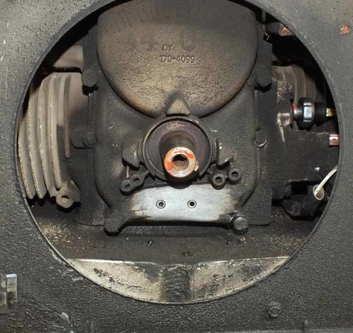

onanparts.com 174 #10 Posted April 17, 2017 Pop that flywheel off. Odds are very high it does NOT have the mounting holes for the electronic ignition module. If not then you will need to get a later timing cover with the holes in it. I've done what you want to do on several Onan's over the years, add electronic ignition but also keep the points set up for back up. My conversions used two coils, one for each system. Double redundancy! You will need the longer flywheel key, Onan # 515-0284. Trigger ring/rotor # 166-0767, Module # 166-0785 and insulator # 166-0786.. Everything that is shown here: https://www.onanparts.com/index.php?main_page=product_info&cPath=1_16&products_id=737&zenid=32404badf8e93ee072a4522548f0033e Governor arms/shafts are different depending on the particular application. Keep that in mind. Covers and arms are cheap on ebay. This pic is of a timing cover from a 1988 Onan genset that still had points but came with the correct cover for mounting the module. It was an easy conversion! If by some slim chance your cover looks like this one then your conversion just got much easier! Don't hold your breath though..... Share this post Link to post Share on other sites

boomers_influence 106 #14 Posted April 22, 2017 6bg6ba the #1 cylinder is the starter side. the plug to use is champion RS 17 YX. i did not see that you ordered an ignition rotor. ( 166-0767 ) ALSO, the back of the flywheel MOST be machined down, or it will crush the ignition rotor. thank you. boomer Share this post Link to post Share on other sites
6bg6ga 271 #15 Posted April 22, 2017 Thank you boomer. Just came in from the garage after looking at the engine and it has a 2 and a one on the crank. Amazing, I get blinder every day. Yup, got the rotor off the other engine. I will look at the flywheel for clearance after I get the aluminum off the rod journal. Just gave it a helping of easy off and will wait 4 hours and see if something happens. I will repeat this 3 or 4 times and if it doesn't the crank comes out for serious cleaning and polishing. Thanks again. 6b Share this post Link to post Share on other sites
6bg6ga 271 #16 Posted April 23, 2017 (edited) On 4/22/2017 at 9:19 AM, boomers_influence said: 6bg6ba the #1 cylinder is the starter side. the plug to use is champion RS 17 YX. i did not see that you ordered an ignition rotor. ( 166-0767 ) ALSO, the back of the flywheel MOST be machined down, or it will crush the ignition rotor. thank you. boomer You have me wondering now. I looked at the newer cover I purchased and I remembered several weekends ago when I tore the top off my P216V pulled the flywheel, stator and replaced the ignition module. The module sits below the stator so why do I need to machine the flywheel on the B43E? It would appear the height of the stator supports is the same and thus there would be no way the ignition module is going to hit the flywheel or a need to machine the flywheel because the module is below the stator. Is there something I'm missing? Another note.... couldn't keep from laughing today when I saw the module bolts on ebay for $7.00 Couldn't help but wonder if they had been blessed by the pope or they were nickel plated. Note...Anyone needing these bolts they are 10-32X 3/8" hex head and less than .50 at your hardware store. On another thread there was a question about the insulator under the ignition module. The insulator isn't to insulate against voltage/continuity its a thermal insulator. Edited April 24, 2017 by 6bg6ga Share this post Link to post Share on other sites
