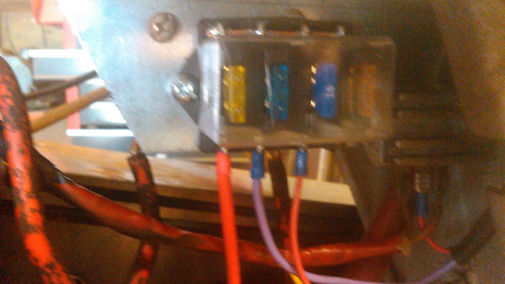

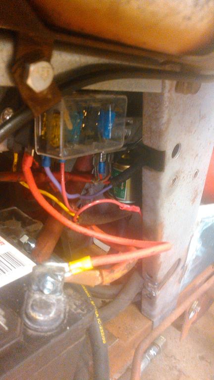

I had to get creative for the 30 amp bus on the fuse block. Wiring is done except fuel pump and light switch.

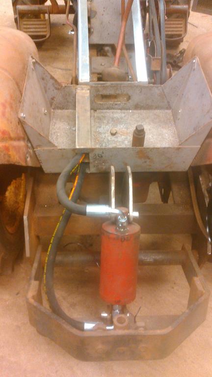

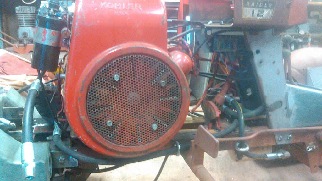

The hydraulic hoses I had made fit pretty good. I figured I had better install them before I installed the battery and that also gives them a chance to form before I put pressure on them. I left the tank open to let the sealer cure a few more days.
  • Like 1
  • Excellent 2
Are those stock style hose fittings or did you use adapters to bring it up to newer fittings? Looks really good.
  • Thanks 1
They are standard jic fittings. I took the original fittings to a hydraulic shop and purchased the 2 port sizes I needed then had the hoses made to custom length.

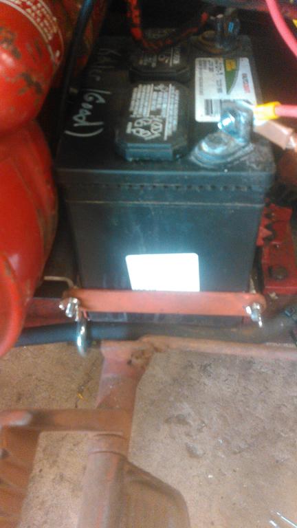

Battery box repaired.

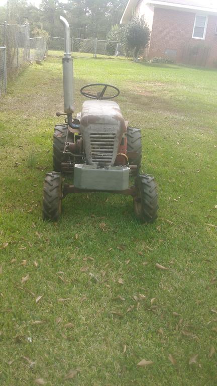

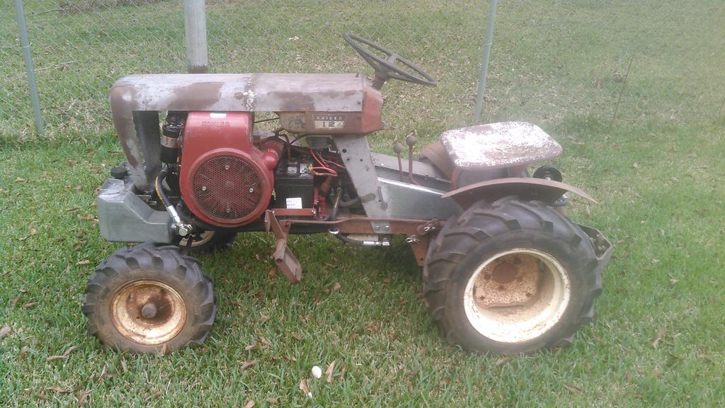

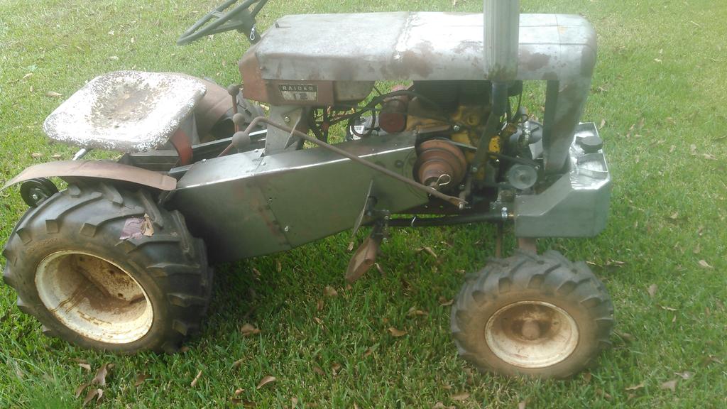

Drove it to the backyard for a few photos.

Very cool Jay! Now is this one going to get done up all nice and pretty or is it going to stay in work clothes, or a little both?.
  • Like 1
Thanks Richie. It will be torn down to the frame, transmission opened and inspection, new seals and anything else needed and new clothes. Still will be a worker.
The "12" lives!    :woohoo:

I filled the hydraulic system to test it. Everything works but it is a little slower than I would like. I used a larger pump pulley than I had before so I will change that first and see if it helps. Also wired and installed the high / low light switch. I must say i like the option.
This will complete the modifications. Thanks for following along.
