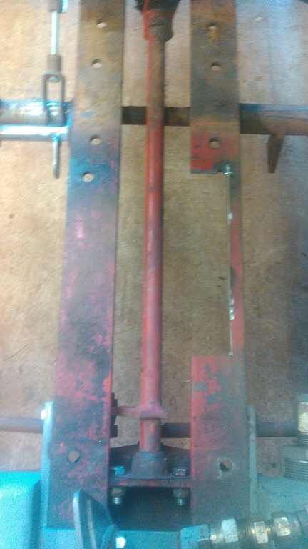

Well I got the frame cut and did a test fit and replaced the front steering shaft bushing while I had it apart.
I'll be using 1/2" plate to give a little more clearance for the hydraulic pump.
Edited by JPWH
  • Like 4

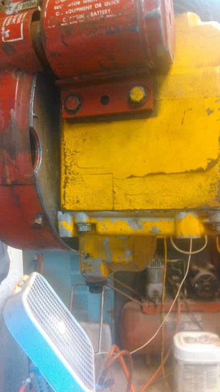

Another reason I like this motor other than the deep oil sump is the drain plug is on the bottom.
  • Like 4

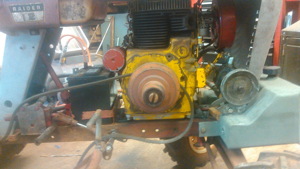

The 1/2" plate idea didn't pan out so well due to the mounting bolt pattern. So after a little digging in the metal rack and came up with this. Let me know if you see something you think won't hold up.
All welded up.
Final resting place. Just needs bolted down.KIMG0930.jpg.f6468e3cb76dcbab8a75e1b0601d968b.jpg
  • Like 7

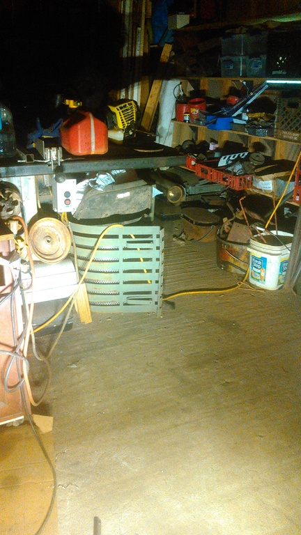

I put the bolts in yesterday and bolted the motor down. Then installed the coil and starter relay. Got everything wired and was going to try to start it up. Forgot I had drained the oil and only had 1 quart on the shelf. Stopped to get oil and thought about fuel filter and cut off valve so got them too. Took the wife out to eat came home and went to the shop to fire it up and no Gas. Both cans bone dry. But I did get the exhaust fittings in and picked up some parts for the custom stack muffler and the last hydraulic fittings.KIMG0933.jpg.88c9dc9aa139c9f457d6fd544f4d1981.jpg
  • Like 3
The 12 hp is alive and sounds good. Now I will proceed with the rest of the build with all the neck breaking speed of a ruptured turtle. I need to build a stack muffler, make a new belt guard for the drive pulley and tiller idler pulley, make a belt guard for the hydraulic pump, make a brake lock lever and cover, and finish the hydraulics then I can start disassembly.

If as is was dud I would have just had it rebuilt. You are a good man RJ. I did buy another oil pan though. It's cast iron instead of aluminum because of the way I had to mount it I feel better with a little beefier and the little extra weight won't hurt either.lol
