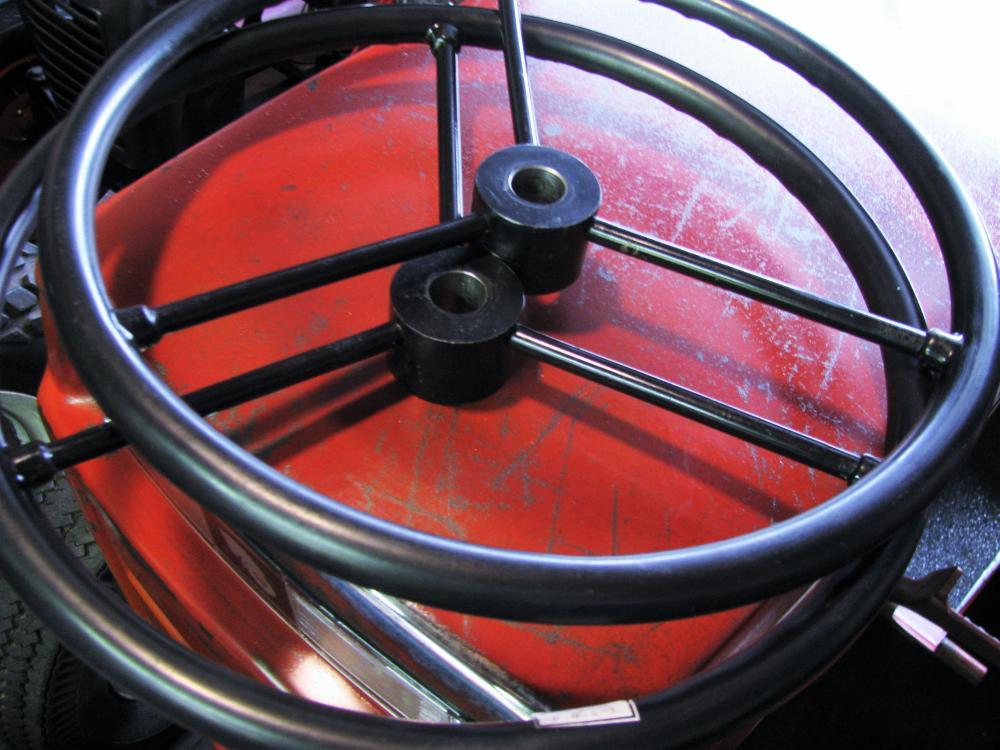

roadapples 6,981 #27 Posted April 18, 2017 @rmaynard And we still don`t know how to drill a steering wheel... 3 Share this post Link to post Share on other sites
rmaynard 14,893 #28 Posted April 18, 2017 It's magic, and magic is never the same after you know how the trick is done. 5 Share this post Link to post Share on other sites
bmsgaffer 2,043 #29 Posted April 18, 2017 1 hour ago, rmaynard said: It's magic, and magic is never the same after you know how the trick is done. Give the engineers some solace, get @buckrancher in here to give us the scoop! 1 Share this post Link to post Share on other sites
buckrancher 2,675 #30 Posted April 18, 2017 (edited) I should have taken a picture it involves a Bridgeport mill a 6" Kurt vise a right angle knee a fixture I made with a 3/4" pin and three Kant twist clamps a 1"x1 1/2" spacer one edge finder a 1/4" two flute endmill a center drill a 15/64" drill and a 1/4" reamer Brian Edited April 18, 2017 by buckrancher 5 Share this post Link to post Share on other sites
roadapples 6,981 #31 Posted April 18, 2017 Ah, That's what I thought.... 3 Share this post Link to post Share on other sites
clueless 2,898 #32 Posted April 18, 2017 43 minutes ago, buckrancher said: I should have taken a picture it involves a Bridgeport mill a 6" Kurt vise a right angle knee a fixture I made with a 3/4" pin and three Kant twist clamps a 1"x1 1/2" spacer one edge finder a 1/4" two flute endmill a center drill a 15/64" drill and a 1/4" reamer Brian Well I was going to suggest that, just wasn't sure if you needed a 1"x1.5" or a 1"x1.25" spacer. 2 Share this post Link to post Share on other sites
rmaynard 14,893 #33 Posted April 18, 2017 See, I told you that once you know how the trick is done it's no longer the same. 2 Share this post Link to post Share on other sites
R. L. Addison 299 #34 Posted July 17, 2017 I have lined up the shaft hole in a drill press, clamped every thing solid, raised the drill out of the hole, (when happy with alignment) & put mating part on shaft & drilled, and been pretty successful that way, but I would probably sent it out too, knowing someone who could do a job like that. There are many machine shops that would have botched a job like that. That one looks to me to be superior. Share this post Link to post Share on other sites
Sarge 3,462 #35 Posted July 18, 2017 That's a great example of why machine work itself is cheap - but the setup will cost you a fortune , lol . Sort of like t-shirts , first one is $500 , after that - $6.50... Sarge Share this post Link to post Share on other sites
