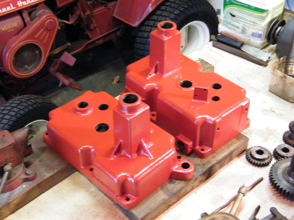

The 1st picture shows a transmission case with no bearings in it...

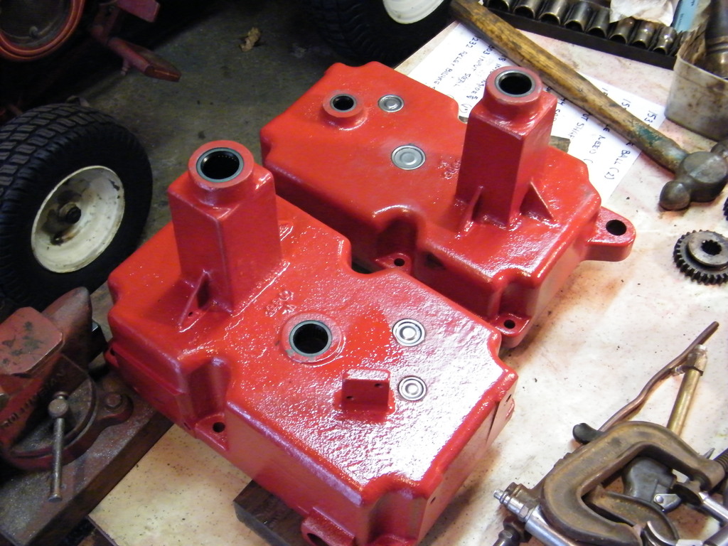

I know this looks like freeze plugs, but these are cap, needle bearings.
