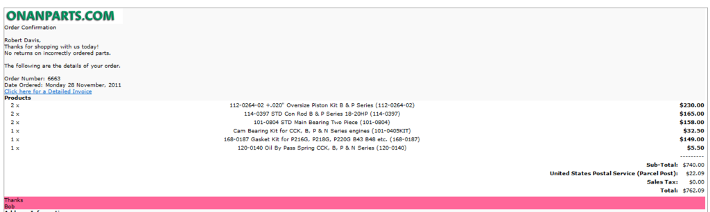

HorseFixer 2,012 #27 Posted March 22, 2017 NO, You asked how much New Rings cost and where to get yer stuff. I said I didn't know because they came included in the piston kit I purchased. I merely showed what I paid for my rebuild kit back in 2011 and I know I had $400.00 in machining costs + which included boring cylinders, turning the crank, valve grind, knurling guides, and he balanced my engine. I also had other incidentals involved. You very well may be able to fix yours with just rings. But you should get complete set of rings and your going to ave to hone the cylinders. You want to do both cylinders. Be advised that your starting to get deep in the engine. Its always been my thought on where do you stop? Increasing the compression in the top end what does that do to components on the bottom end? Maybe nothing? I dunno. I don't want to be the GRIM REAPER HERE, I was just showing you what THE FULL MONTY COST just as an example or reference. Or worse case senerio. How about valve seals? They could be an Issue too. My advice to you is get a hold of T.J. at ONANPARTS.COM he knows his stuff and he does this EVERYDAY and knows those engines inside out. He already posted on here up in the thread so he is wanting to help you. Whatever you find keep us posted as we all learn from this and I am interested how its all gonna shake out for you. GOOD LUCK! 1 Share this post Link to post Share on other sites

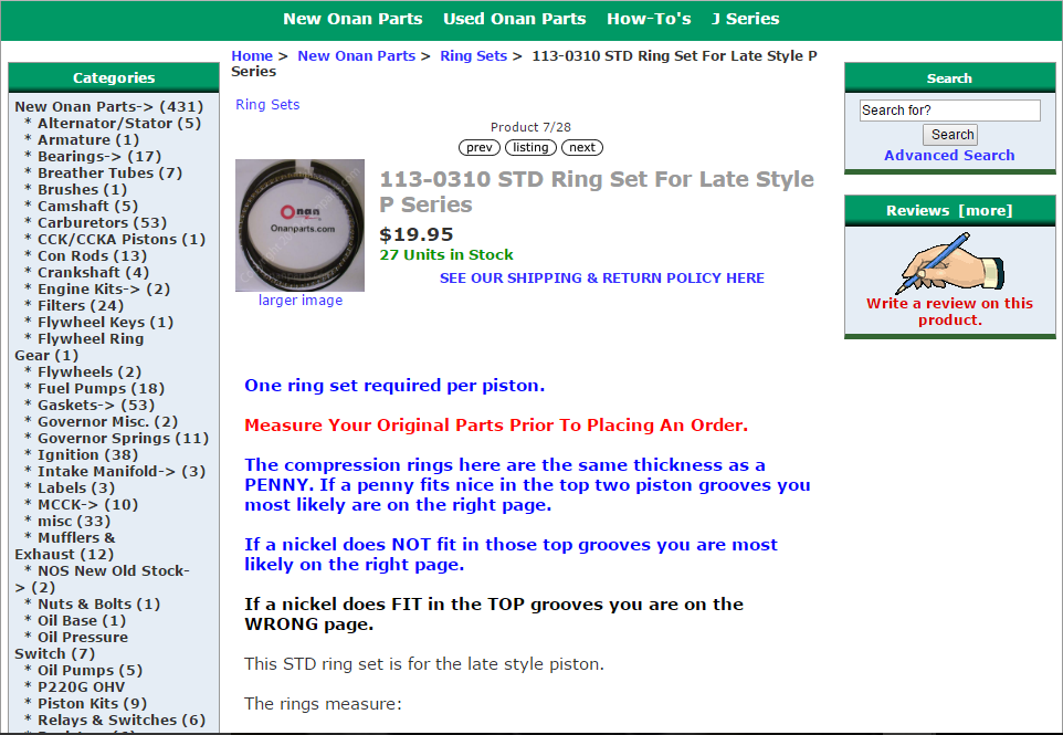

HorseFixer 2,012 #28 Posted March 22, 2017 It looks like he is getting $19.95 for his ring sets per piston. Here is a link to his page for these. https://www.onanparts.com/index.php?main_page=product_info&cPath=1_5&products_id=9 Share this post Link to post Share on other sites
tormater 12 #29 Posted March 22, 2017 25 minutes ago, HorseFixer said: It looks like he is getting $19.95 for his ring sets per piston. Here is a link to his page for these. https://www.onanparts.com/index.php?main_page=product_info&cPath=1_5&products_id=9 Yup, had this page saved as this morning HorseFixer, Thank You very much for your help, looks like a great place to get the parts! By the way, I think and I mean, I think, the valve seals appeared to be in pretty good shape, carbon heavy but seals appear ok, looking forward to the valve adjustments, everything there looks pretty good thank goodness! By the way, I bet your Onan gained a few ponies by what you have done to yours! Bet it is no longer only a 20 horser! 1 Share this post Link to post Share on other sites

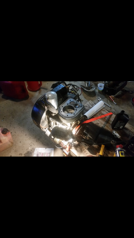

tormater 12 #34 Posted March 28, 2017 Honed cylinders and popped the Pistons back in, nice that the Pistons can't be moved .020 like before, hahaha they are nice and tight now! Share this post Link to post Share on other sites
tormater 12 #35 Posted April 3, 2017 Got er all back together, seems good, no more blue smoke and seems to run pretty well, we'll see after working it for awhile what it does on oil consumption. 2 Share this post Link to post Share on other sites
onanparts.com 178 #36 Posted April 3, 2017 (edited) 5 hours ago, tormater said: Got er all back together, seems good, no more blue smoke and seems to run pretty well, we'll see after working it for awhile what it does on oil consumption. For proper ring seating/break in, the engine should be run alternating between half and full loads. Don't baby it! Normal use but try to avoid letting it idle for long periods until you have 3-4 hours on the clock. Good to see it's back up and running! Edited April 3, 2017 by onanparts.com 1 Share this post Link to post Share on other sites
tormater 12 #37 Posted April 3, 2017 18 minutes ago, onanparts.com said: For proper ring seating/break in, the engine should be run alternating between half and full loads. Don't baby it! Normal use but try to avoid letting it idle for long periods until you have 3-4 hours on the clock. Good to see it's back up and running! 19 minutes ago, onanparts.com said: For proper ring seating/break in, the engine should be run alternating between half and full loads. Don't baby it! Normal use but try to avoid letting it idle for long periods until you have 3-4 hours on the clock. Good to see it's back up and running! Yup, that's what I have been doing Onanparts, thank you and for your service Share this post Link to post Share on other sites
