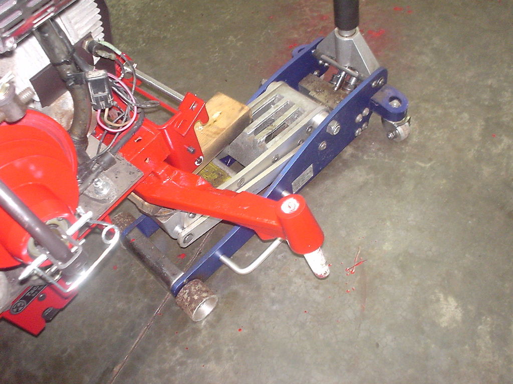

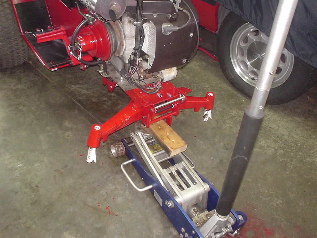

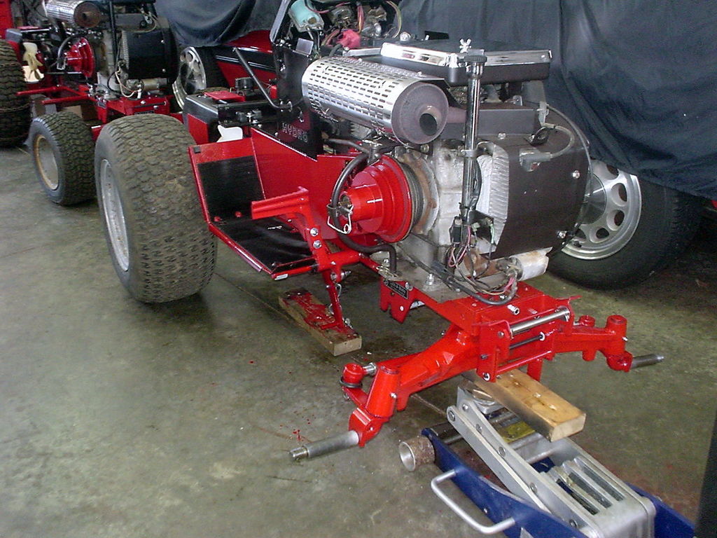

The 88 and 89 520's do not run the charge current through the 9 pin.
I have rewired all of mine this way. Just a wire from the regulator straight down to the starter solenoid with a 30 amp inline fuse close to the starter.
Gets rid of most charge issues.
You can just make out the sealed fuse holder in these pics tied to the dipstick tube.
