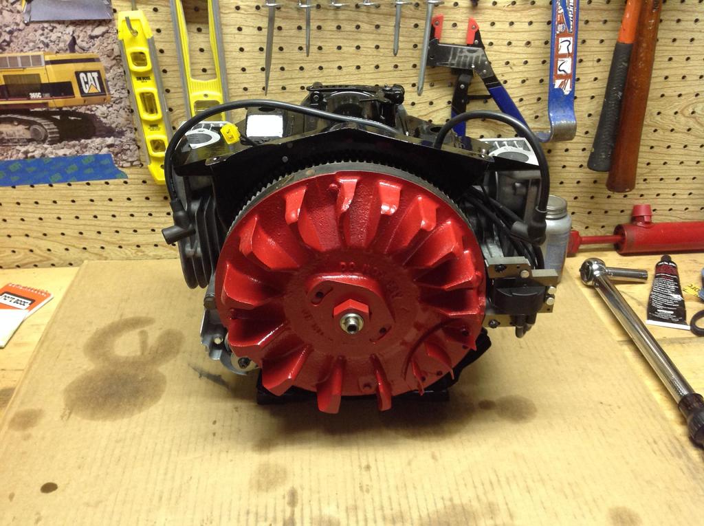

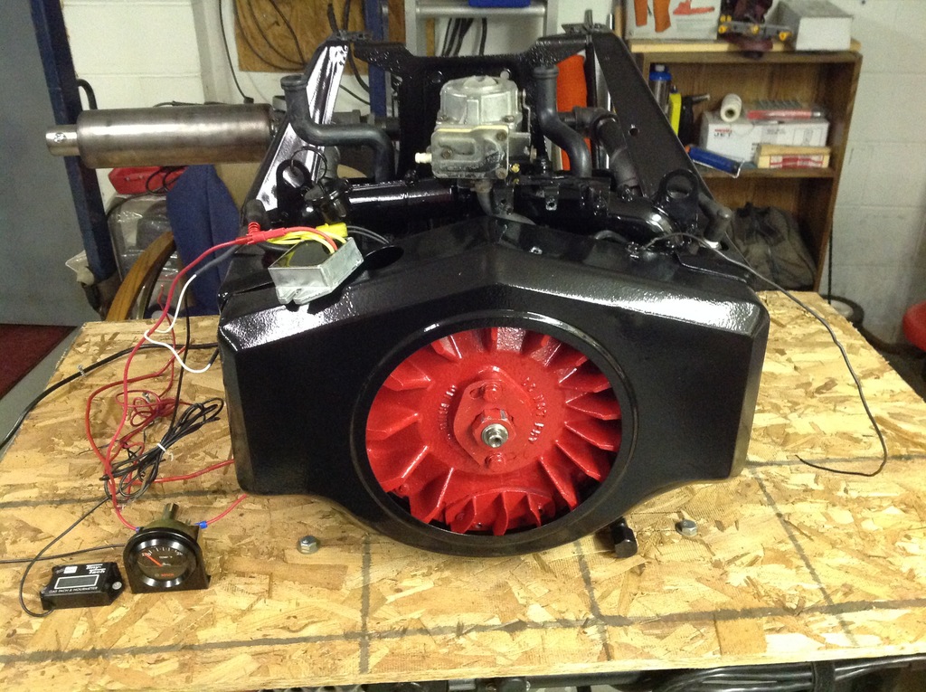

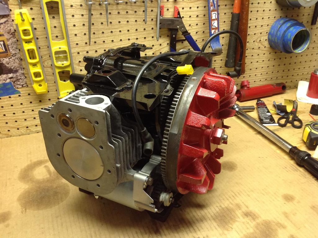

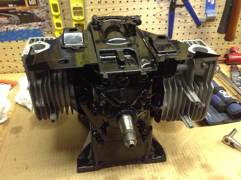

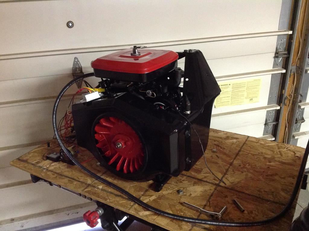

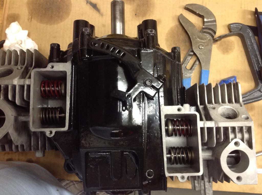

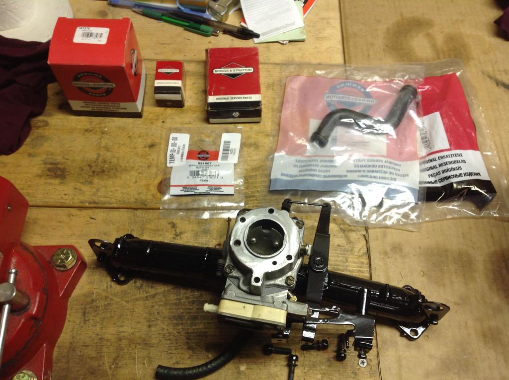

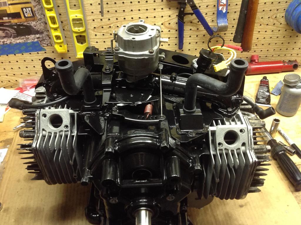

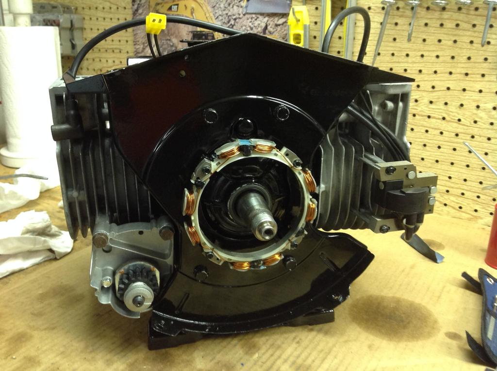

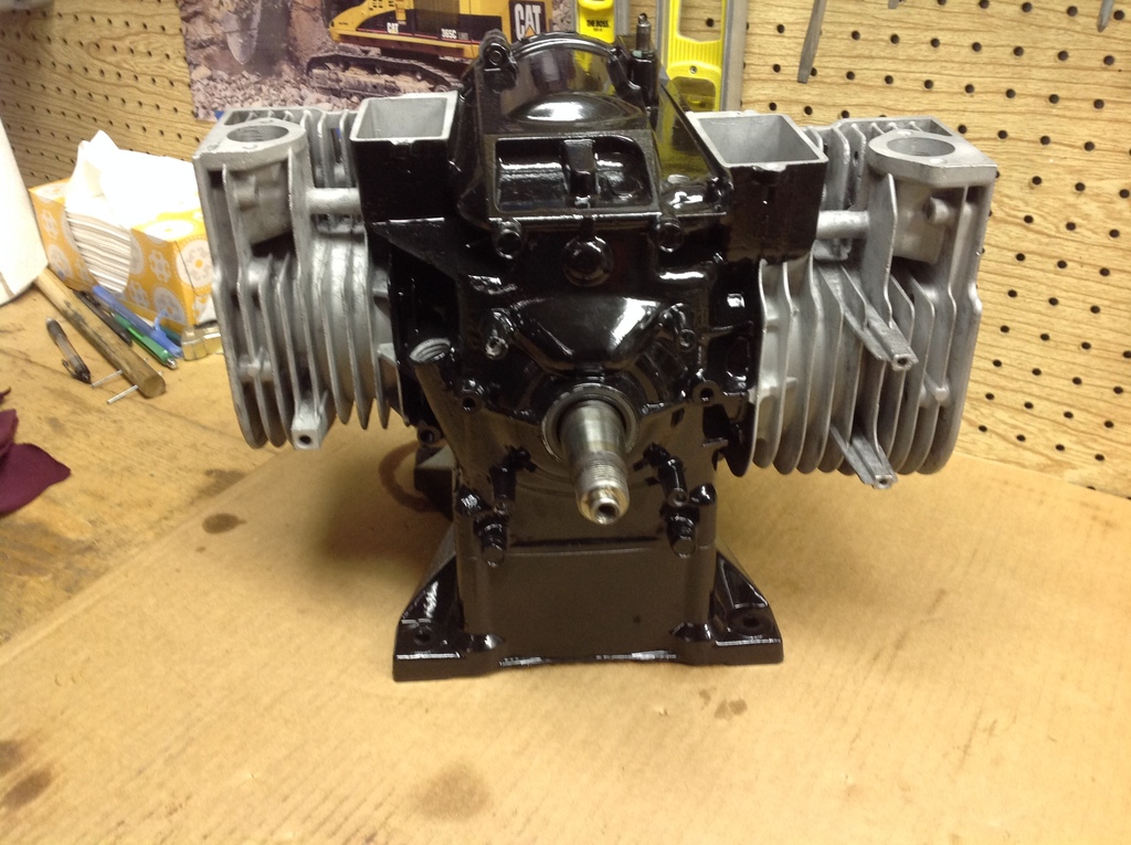

Finally got her together!  Everything went together well, adjusting the valves is a real bear on these.  Grinding the valve a hair at a time is painstaking.  So glad it's done.  Need to run it in a little more then comes the transplant into the :wh:

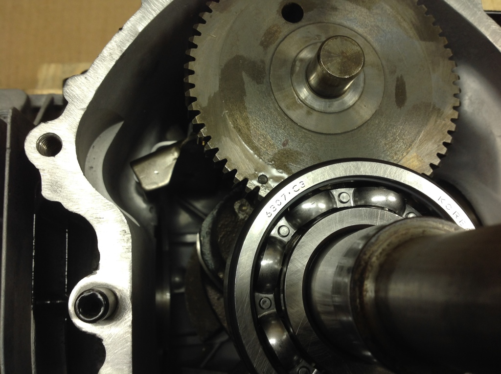

How you line up the timing marks.  The mark on the crank gear is hidden by the ball bearing so they put one on the crank itself.
IMG_1162.thumb.JPG.04e12ba986413ffcb84a4d1806e2629b.JPGIMG_1163.thumb.JPG.1efd6735e09801dd68739862feabed9a.JPGIMG_1165.thumb.JPG.8bd0d681639727eb01d82a68e25eb564.JPGIMG_1166.thumb.JPG.72e7ae7ea98e02feb74f538d7c56ea8e.JPGIMG_1168.thumb.JPG.3fa35623abde306585e1e41ec90ee67b.JPGIMG_1169.thumb.JPG.9afcacbe7cb8b36935f348e279a0bec7.JPGIMG_1170.thumb.JPG.7f2ce62261eda658a9b6241d700fd33c.JPG

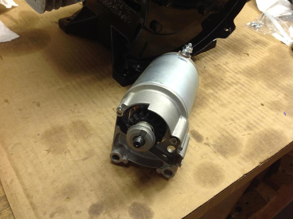

Heavy duty Oregon starter.  4 1/2" long compared to 3 5/8 stock.  Had to cut the tin to make it fit.
IMG_1172.thumb.JPG.d90d7cc6e872c5a7eb1c77ae0f22dc70.JPGIMG_1175.thumb.JPG.7c771fd8f8636ccc408c6dde4d11a090.JPGIMG_1176.thumb.JPG.265ed02c270de689d10c78124025a7be.JPGIMG_1177.thumb.JPG.d0b0510b82778c194c6535d2d275fdcc.JPGIMG_1179.thumb.JPG.590e62208e7a813276d341c6b9764111.JPGIMG_1182.thumb.JPG.6b3d9c6d0127469cd6f0c1f832ec9e36.JPG
IMG_1186.thumb.JPG.6020869e47ce8fdd67f1b639700201e5.JPGIMG_1190.thumb.JPG.6c5d071b9dcddb58d7b342c37fbd5ca9.JPG
Shes a runner!!  :auto-dirtbike:

On 3/15/2017 at 9:16 AM, Sarge said:
Red loctite isn't made to do that , although there is a version made specifically to do that job - https://www.permatex.com/products/thread-compounds/retaining-compounds/permatex-bearing-mount-for-relaxed-fits/
Pay very close attention to the directions ...
Sarge
Used it to mount the timing gear to the crank
