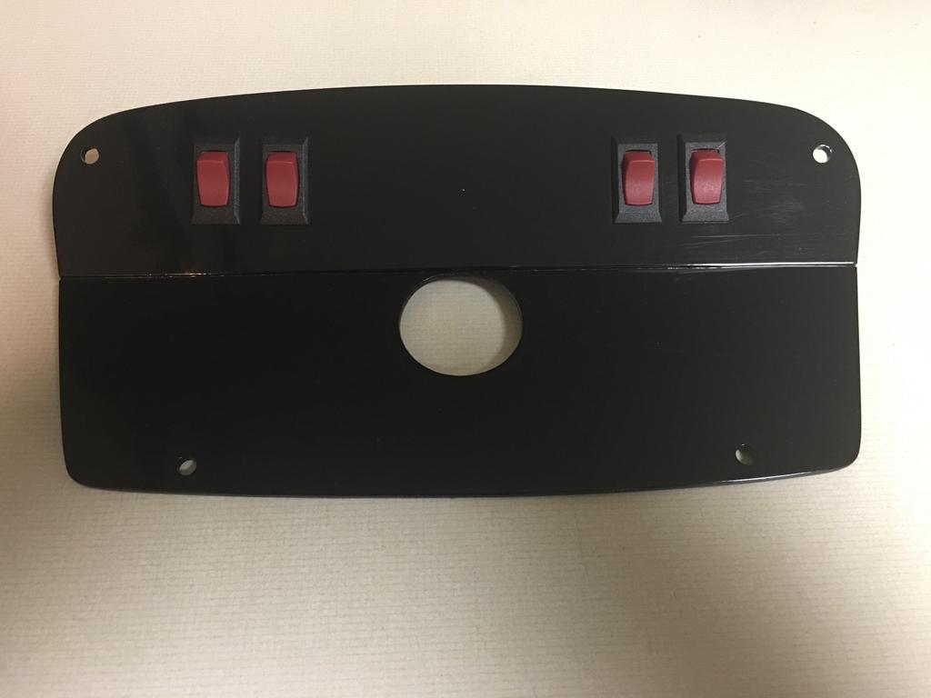

19richie66 16,941 #202 Posted February 9, 2018 Aluminum dash plate powder coated and new switches in. 6 2 1 Share this post Link to post Share on other sites

PeacemakerJack 10,670 #204 Posted February 11, 2018 On 2/8/2018 at 6:25 PM, 19richie66 said: Aluminum dash plate powder coated and new switches in. Looking great Richie—remind me again what accessories the switches are there to operate... 1 Share this post Link to post Share on other sites
19richie66 16,941 #205 Posted February 11, 2018 @PeacemakerJack Fender lights, head lights and reverse light. Maybe something else. Haven’t got that far yet or I did but forgot. 1 3 Share this post Link to post Share on other sites
953 nut 51,632 #206 Posted February 11, 2018 On 2/8/2018 at 7:25 PM, 19richie66 said: dash plate powder coated and new switches in. That dash plate is the same as a 953/1054. Terry could do a custom decal that would spice it up a bit. https://www.redoyourhorse.com/1054-and-953-workhorse-brushed-chrome-dash-decal/ 17 minutes ago, 19richie66 said: or I did but forgot That way you will remember! 1 2 Share this post Link to post Share on other sites

19richie66 16,941 #208 Posted February 11, 2018 @cpete1 just remember, anyone can have A reputation, but a good reputation is priceless. As for templates, I destroy most of my cardboard during the process of making what it is I have a template of. they get grease, silicone or spray on them and then they are worthless. I usually burn them in the trash. If I need another, I just take the part off and retrace it. For the dash, I just used the original plate. I cut a groove with a cut off wheel to match the original(got it straight the first time) and then cleaned it up. @953 nutThe chrome decal looks nice. I might trace out the holes and send Terry a template to make a decal for it. I have to get some engine decals made anyways. I appreciate the comments guys. 1 6 Share this post Link to post Share on other sites

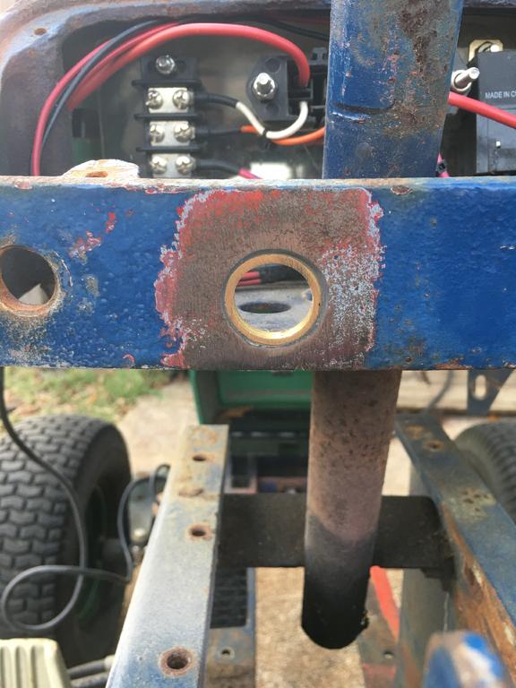

19richie66 16,941 #209 Posted February 13, 2018 Oversized ignition switch hole repair ✅ someone hogged this thing out to just over an inch. WHY? Some things make no sense. Brass fitting drilled out to 13/16” epoxied into the hole brings us back to where it should be, at least for the switch I’m using. Went with a pretty standard Indak toro switch. Plenty cheap on Amazon. Next up is to fill in the choke and throttle cable holes. 5 Share this post Link to post Share on other sites

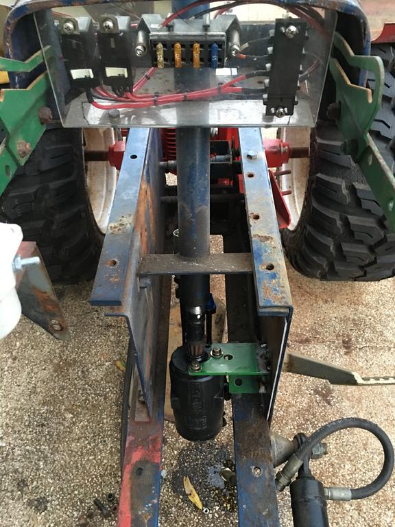

19richie66 16,941 #213 Posted February 23, 2018 Power steering valve mounted, shaft cut and male connector installed. Had to cut out the u joint that was there because it would sit the box too low. I want this to where if I had to I could put the steering back stock. Didn’t want to cut the steering column tube. Now to get hoses made. 1 9 1 Share this post Link to post Share on other sites
cpete1 331 #214 Posted February 25, 2018 The poor tractor is probably in shock. It never had it so good in it's previous life. That dash and fuse arrangement looks like something off a high end street-rod for god sakes. Man Richie, its looking really good. will be interesting to see how the power steering works out. Waiting for the next installment of the build. 2 1 Share this post Link to post Share on other sites
