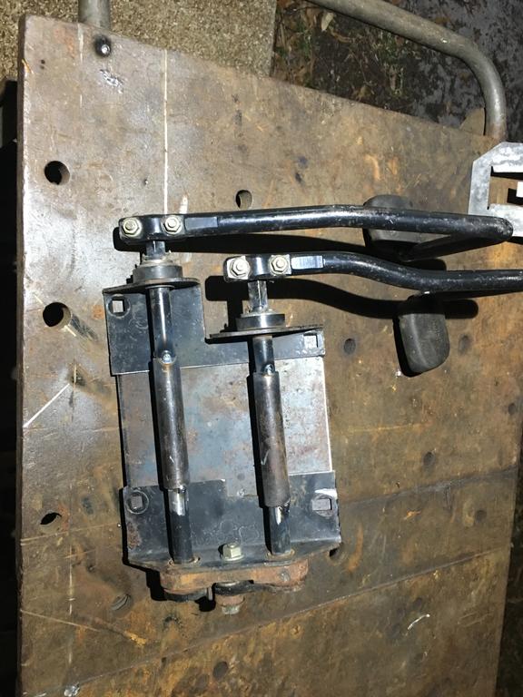

19richie66 16,824 #188 Posted January 26, 2018 Hood hinge almost done. So I decided to try my hand at multitasking. So I have this foot pedal assy from an un-named green tractor that I am going to try and use on this. It mounted below the foot rest. How ever the gt14’s footrest is too wide for this to sit right. So I figured if I cut it right down the middle, sleeve the rods and weld a wider backing plate to it, I can mount it right to the bottom of the frame and bring the pedals right up through the right foot rest. This tractor will never mow anyways. After the paint that was put on it and the abuse it was put through, Skittles will have nice life. More to come as it progresses. The picture with the red background I borrowed but this is the same assembly I will be using. 6 1 Share this post Link to post Share on other sites

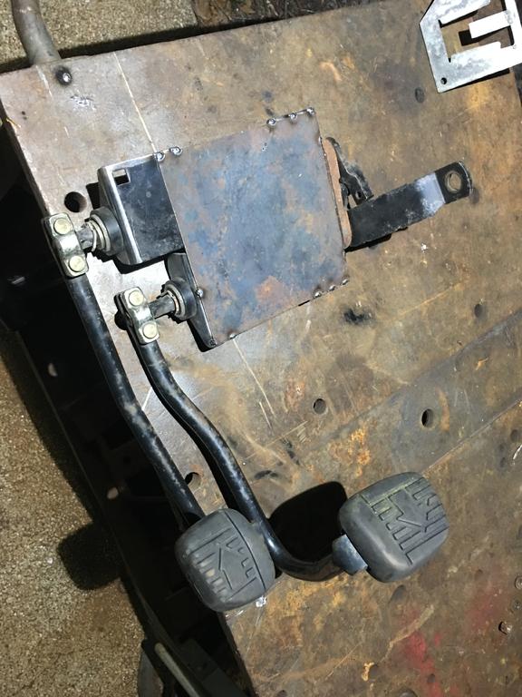

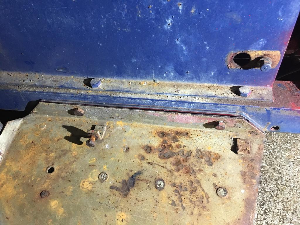

19richie66 16,824 #190 Posted January 28, 2018 Foot pedal assembly widened, mounting plate made and all tacked together. Mounting plate is sandwiched between foot rests and frame. Ran out of daylight. Will clean it up and weld it solid after getting it mounted and linkage hooked up. Mounting plate will be trimmed and opened up so as to not hold dirt and mud, not that it will see much of either. Maybe........ 2 4 Share this post Link to post Share on other sites

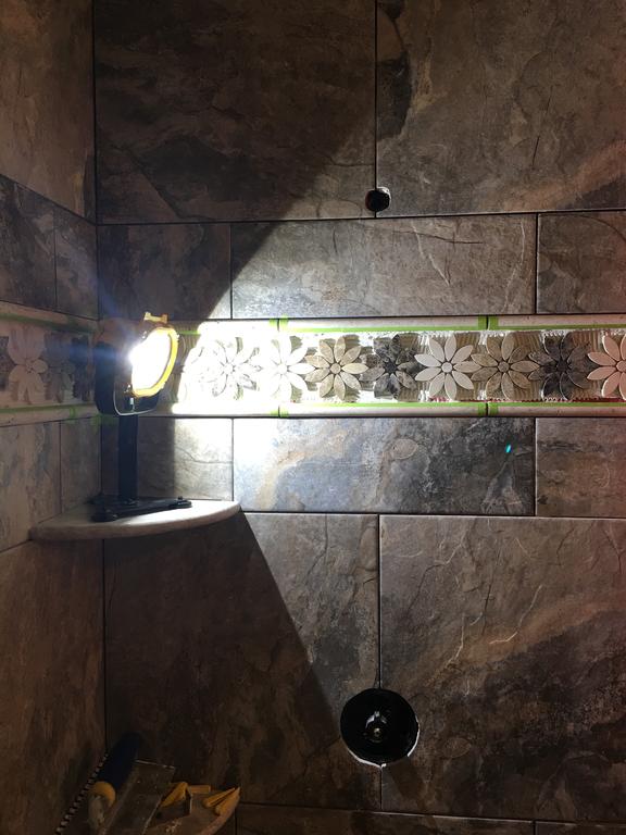

Racinbob 10,204 #199 Posted January 31, 2018 Tile work in shower looks great Richie. You're getting there. 3 1 Share this post Link to post Share on other sites
PeacemakerJack 10,650 #200 Posted January 31, 2018 soon you’ll be able to get serious on Skittles and after putting in some hours on him, then you’ll be able to clean up in that awesome shower! 1 Share this post Link to post Share on other sites
